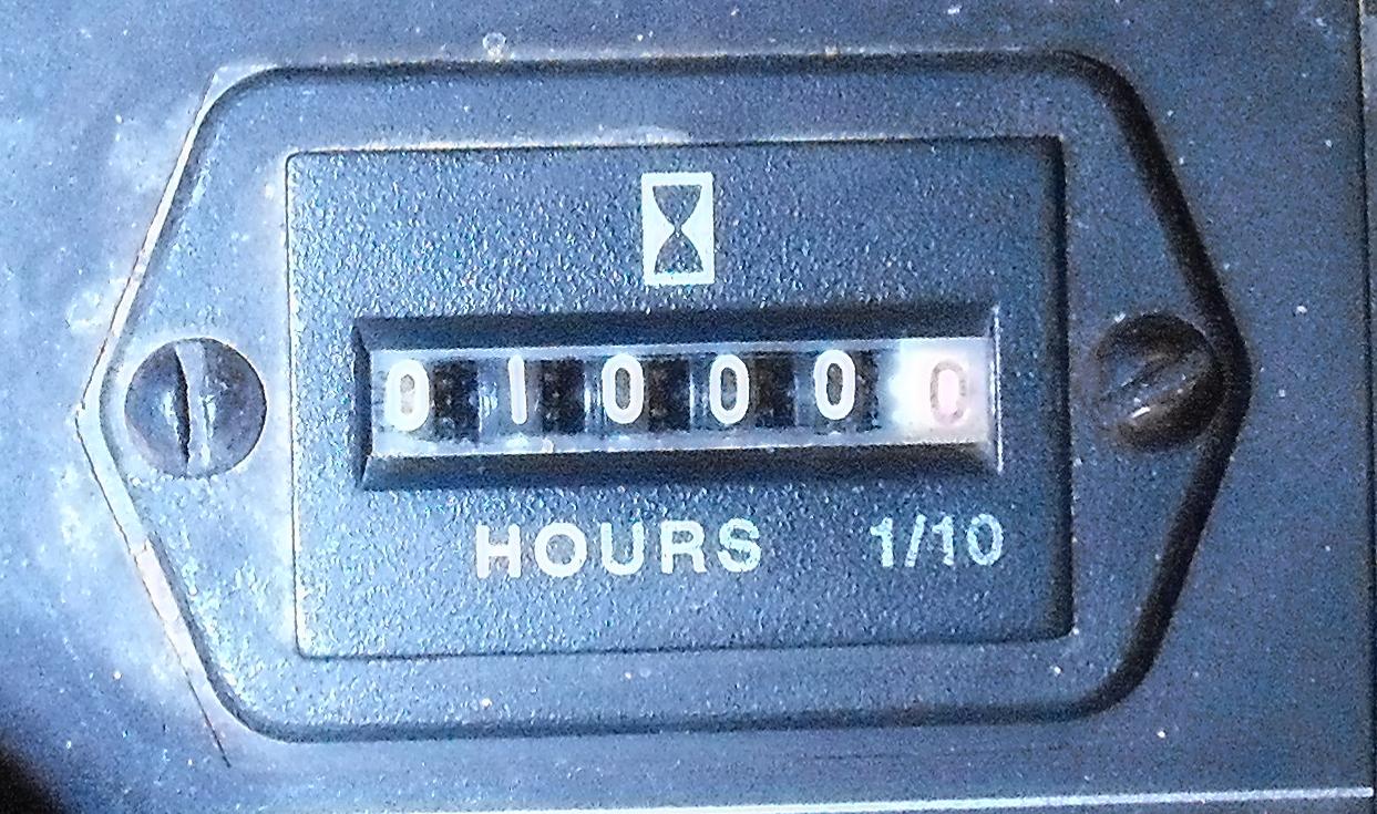

I now have over 1000 hrs on my 2003 PT422 Robin. The only 2 problems were a fried voltage regulator and a bad coil. O yes I had to weld and brace the pivot, rollover, lift bar but that was easy. Replaced the battery and tightened a few fittings. I am well satisified with the tractor and engine preformance. It still runs as strong as the day i got it. what a machine!!!!!!!

Stray thanks for posting your 1000 hour mile stone and it is still running strong. I hope you get many more trouble free hours on it.
