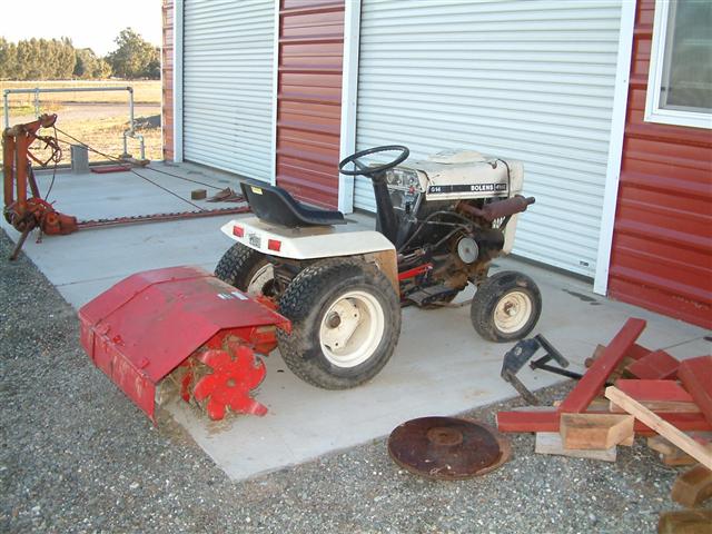

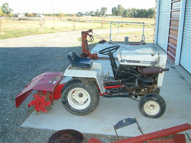

Old tractors are a lot of fun (I restore them--Farmall Cub, Farmall Super A, Minneapolis Moline BF, Massey Ferguson 135, Oliver 60, and counting)--- as a hobby. But trying to get one running so you can use it in the field (as opposed to displaying it and/or driving it in parades) can be a real bear and expensive to boot. And if you're starting from scratch experience-wise, figure it'll take you the better part of a year to become proficient.
For a 1/2 acre garden, I'd check eBay and craigslist for a riding mower with a rototiller. Mine is an old 1970s Bolens GT1453 (a garden tractor with a 14 hp Tecumseh engine) with a 3-ft wide rototiller. Found it locally off craigslist for $600

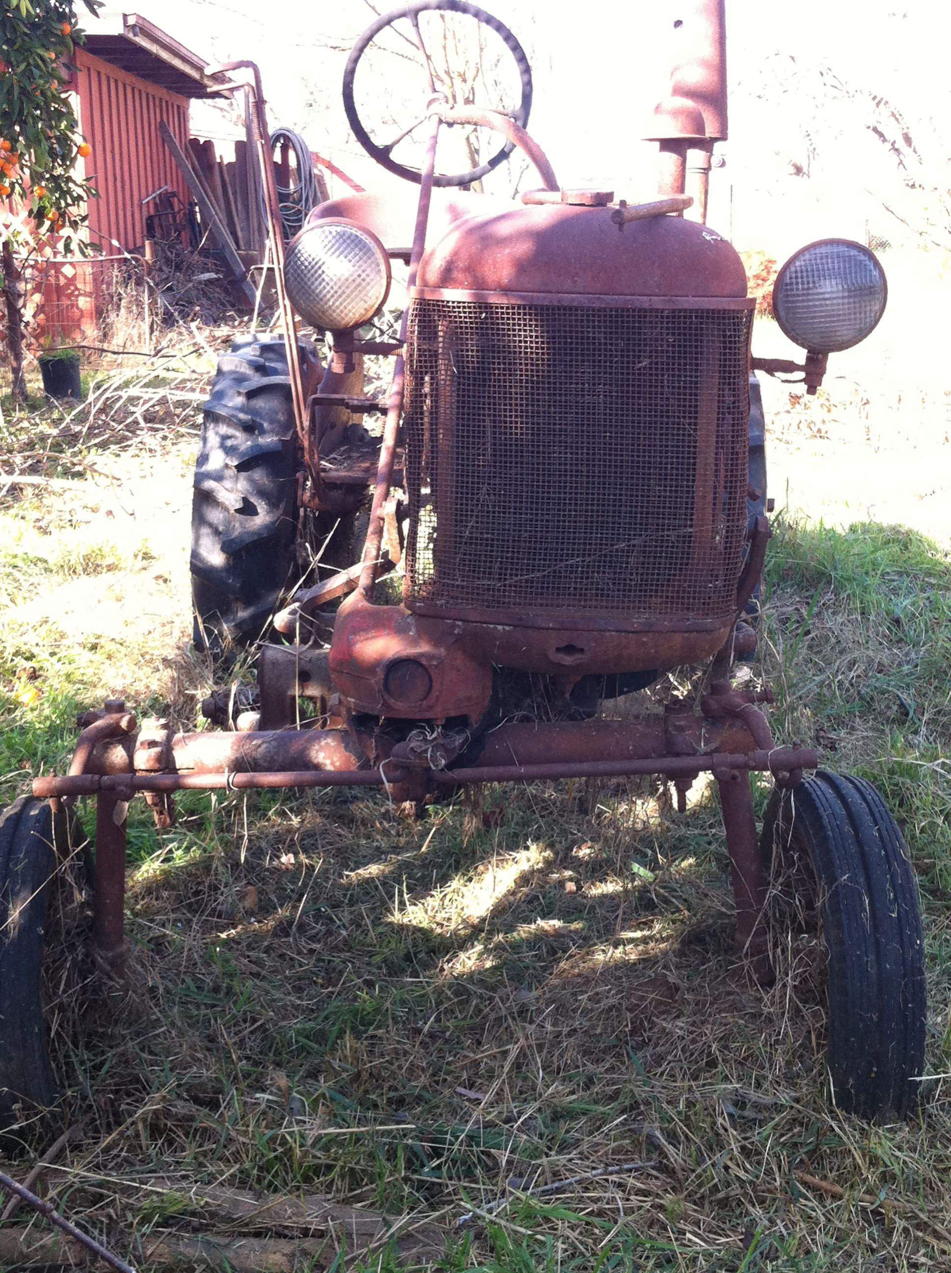

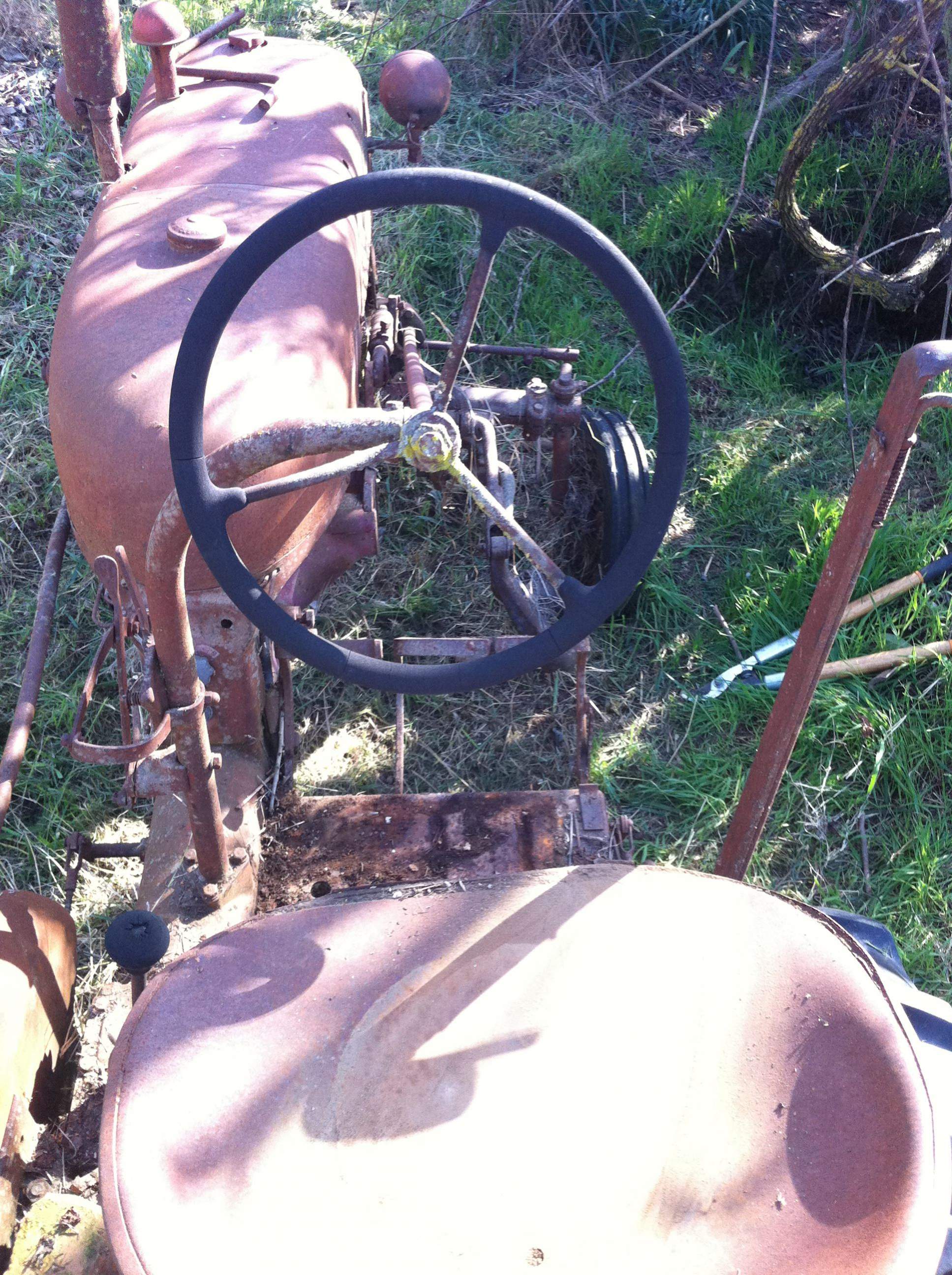

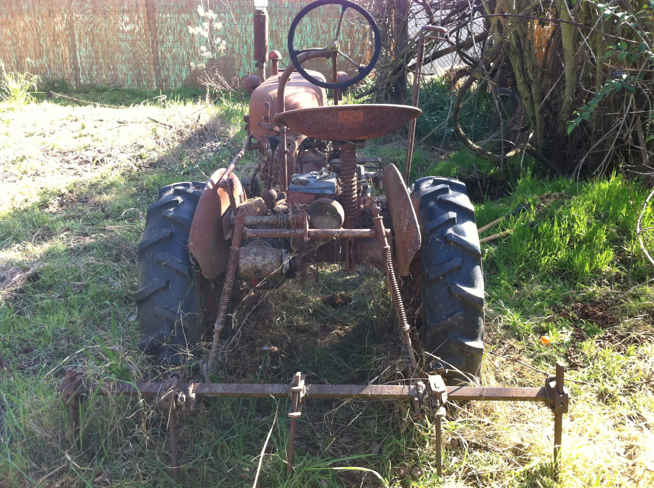

Sorry for the delay, I want to thank you all for the help. Here are some pictures i took of the tractor today.

Nice looking Farmall.

Thank you Mike! Farmall huh... Do you know the year by chance?

Looks to be either a Farmall Cub
If you look on the Steering gear housing on right side you will find the serial tag with the model and serial stamped in it. Here is a list of the Cub serial numbers take your number and find where it fits in to get the year.
1947: 501
1948: 11348
1949: 57381
1950: 99536
1951: 121454
1952: 144455
1953: 162284
1954: 179412
1955: 186441
1956: 193658
1957: 198231
1958: 204389
1959: 211441
1960: 214974
1961: 217382
1962: 220038
1963: 221383
1964: 223453
Final: 224703
