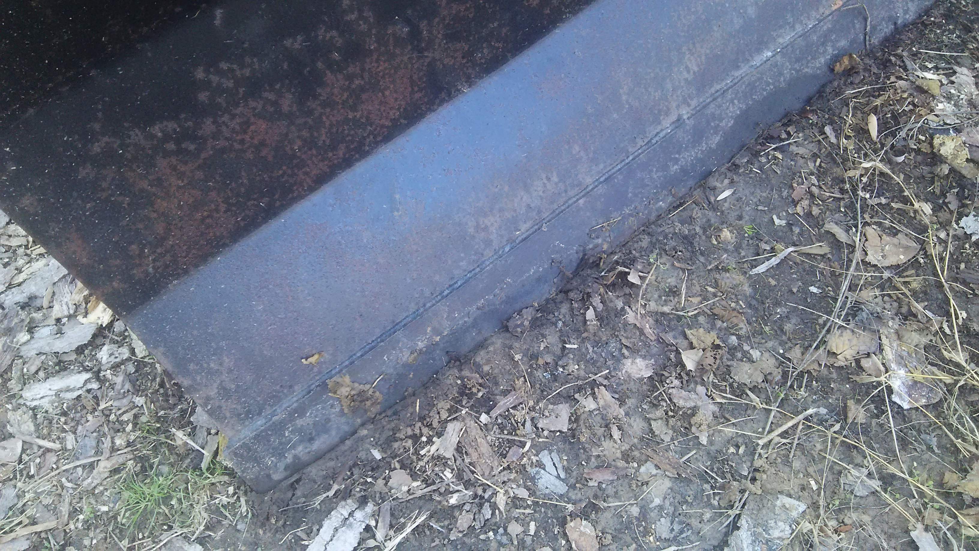

Well, I finally got home long enough to measure my blades - the short one is 60", and has the QA plate. The larger one, which has the 3 pin connection, is 72" but the leading edge is not removeable - it's welded onto the blade body as you can see in the pic. I guess that makes it hard to attach a rubber lip, even if my 425 was big enough to push it through snow. Maybe it would be worth it to still put a QA plate on it to back drag dirt for leveling, otherwise I just can't picture what the previous owner had in mind . . . DSC_0049.jpg

I've never had much luck in grading by pushing with this machine........I usually just angle the bucket and back drag........so you might want to consider selling the 72 blade and using the proceeds to buy a different attachment......there's lots to choose from.......haha......Jack

Yes, I would love to trade it for a box blade. I'm a little intimidated to start my next project - trenching about 3000' of drainage pipe and refilling the trench. I'm not confident in my ability to trench for the first time and to get a downhill slope to the trench so it actually drains. After that, I have to move half of a hill, install a retaining wall and level out the low side of the retaining wall. I keep looking at it, some day I just need to dig in - excuse the pun.
So if someone needs a 72" 3 pin blade, I have one!
