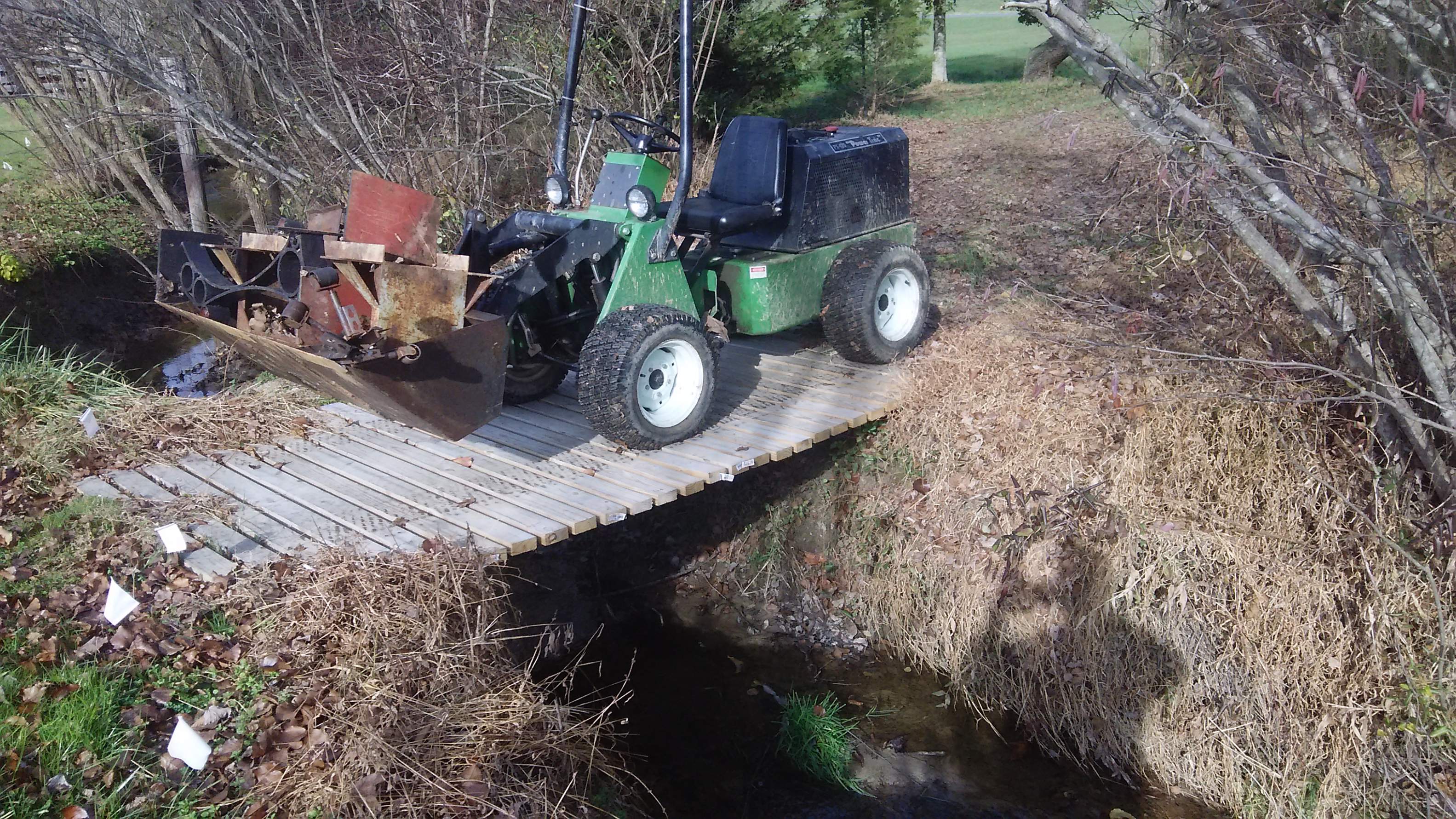

Working 14 hour days has been limiting my time at home, but I finally managed to cross the 10 hour threshold on my PT-425. I got my used machine with 650 hours, and after a crisis involving a stuck float bowl and crankcase filled with fuel, I have managed to do the following:
Dug about 20 post holes for a friend - easy chore with little complexity
Used the power rake to attempt smoothing out another friend's plot for grass seeding - I am really bad at using the rake, so I think I made the ground worse - I kept riding up on the rake, even though I was in float.
Took the machete to a long stretch of thorn brambles, and tried to use the 4 n 1 bucket to pick it up and move it to a burn pile, but my skill with the 4 n 1 is pretty weak, so I could have moved it by hand faster, but I had fun.

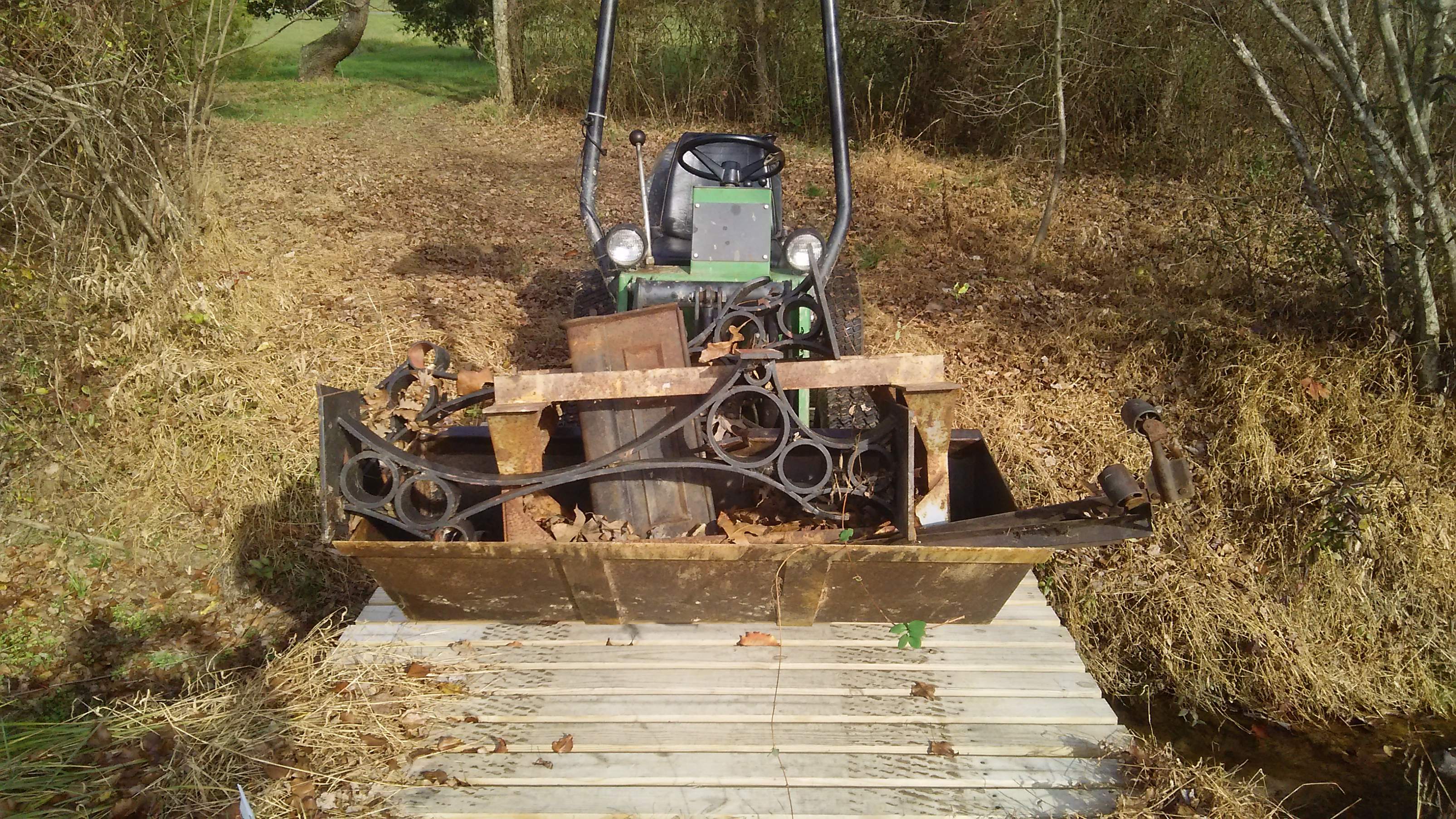

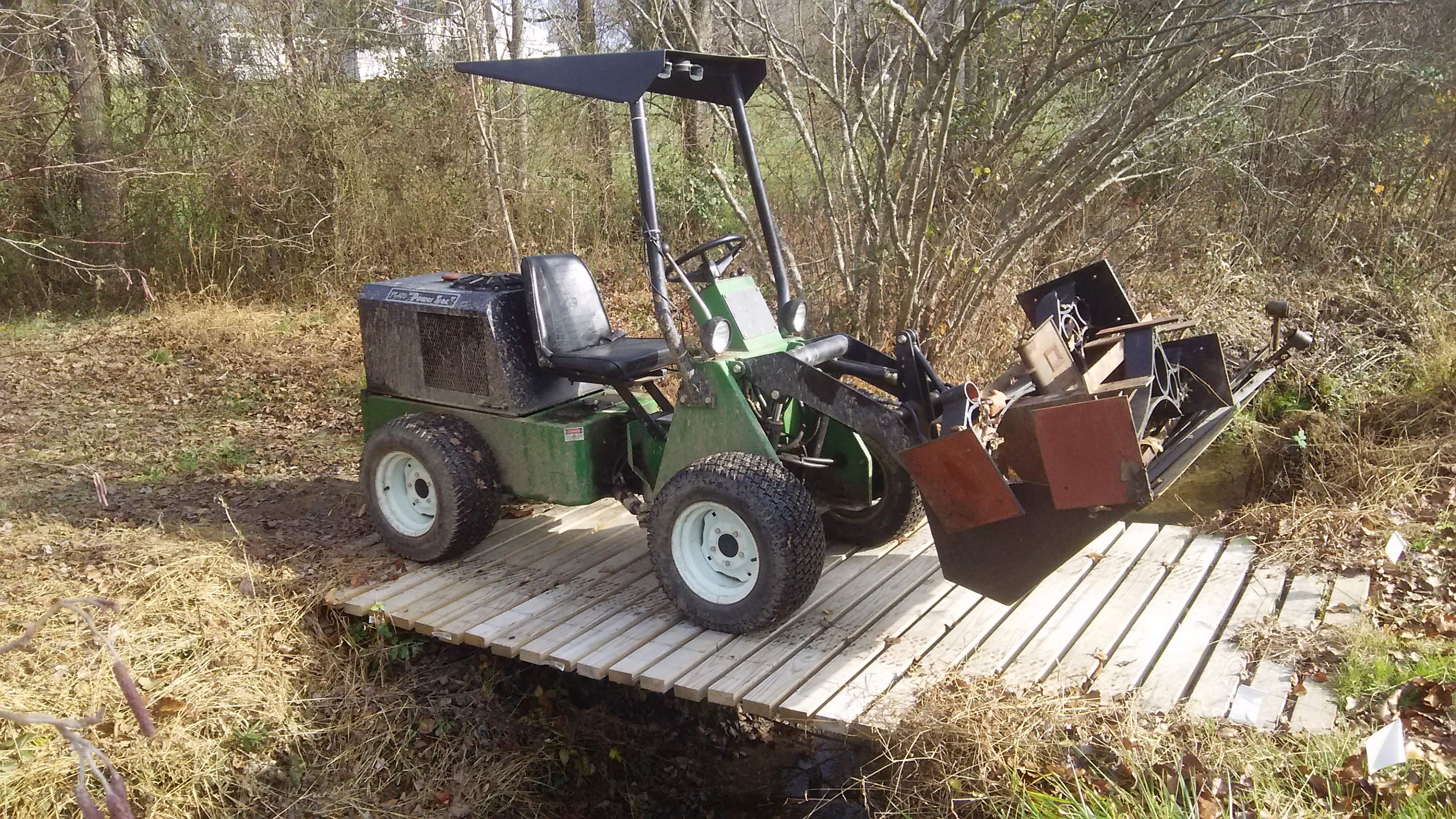

Moved scrap steel for my elderly neighbor. this involved building a bridge across a creek to get the PT across, and loading up about 400 lbs of steel.
(Wait - I am noticing a trend - I am all of the sudden popular with the neighbors, who all own traditional tractors.)
I still smell the funky gas/oil smell probably from the crank case breather when I start, which I suspect means I need to flush the engine oil once again to ensure all of the gas is out of it, and check to ensure more gas is not leaking in. I need to get off my butt and put in a fuel petcock like you all recommended.
I haven't had any real problems starting, other than sluggish starts, needing some warm up time before I can open the throttle past idle, and occasional choke is needed. It's not been cold at all here and I keep it in a covered but open pole barn. We'll see how she does in the colder temps.
The pics show moving the steel across my home-made creek bridge. I've got some big plans in the works for spring that involve the trencher and mini-hoe, and I am begging for boat loads of snow, so I'll be sure to keep everyone entertained.
