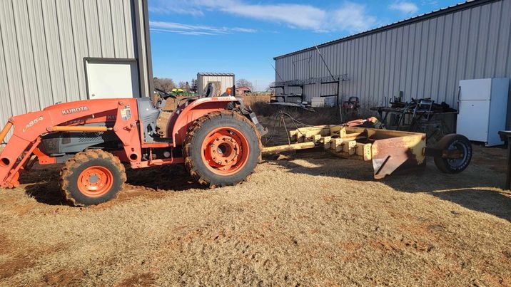

1st thing, it works, to a point.I can pull it ok with a full box of dirt. I can't stick it in the ground and roll the dirt up like I want to, just stops the tractor, but if I'm easy with it, it works ok. I don't run out of power, just traction. I've moved a lot of dirt already.
2nd thing, I can't find any shanks that will work with it. Every thing I find is too short as far as box blade stuff goes, (18 inch max) and if I go to the ag stuff, way too expensive and, I'm afraid the shanks that I think will work will most likely bend. still studying this issue. May have to make my own.
3rd thing, I replaced my rear tires this last summer and did not put the liquid ballast back in. I thought the 320 pounds of cast weight on each side would be enough. Wrong!! Turns out I lost about 640 pounds (if my calculations are correct) from each side. This really hurt the way the tractor pulls but mostly, it makes it scary on my mowing jobs. I mow some sloped areas and the rear of the tractor tries to slide downhill now. Never did that when I had the liquid in the tires.
Final observation. This blade is too big for this tractor but I 'can' use it so I'll keep messing with it for awhile. it needs at least 100 horsepower and a lot heavier tractor to be efficient, but hey, it didn't cost a lot.
I guess I need to buy an M5-111 so I can use this cheap blade. NOT
This blade may be for sale at some point but not right now.
Correction edit!! my math was not correct. I lost just over 400 pounds of liquid ballast weight. According to rim guard, putting their product in my tires should add over 500 pounds per tire.

Well, I could do that, I have the tools but...well just but. I am working mostly undisturbed soil. Hard as a rock at times.

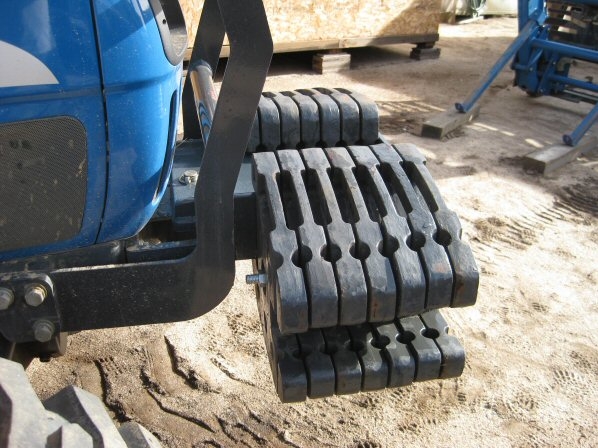

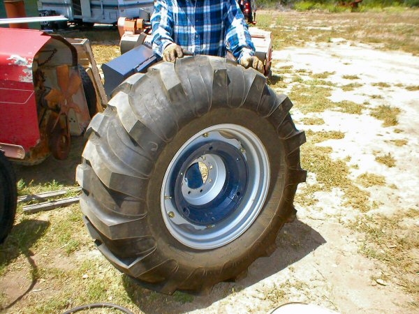

Allen, there is a good reason for my tractor to be the way that it is as you now know firsthand.
Double the recommended weights, front & rear as well as all 4 tires being filled and handles extremely well.
With the weight it handles like the next larger frame size, is better all around for my purposes, but it still is not a 120hp machine.:( I just can't pull what the ole D6 can. o_O

Hey it's been awhile but I remember the posts we exchanged. Yes the weight is important. I don't know what the D6 is but regardless, horsepower and weight are important.
Ya know, this blade pulls harder than my 3 bottom plow. That surprised me.

well in this case, the part of the ground that stopped my tractor was about 3 foot wide. My 6 ft box blade would have stopped the tractor too. There are so many factors involved here but still, the blade is really too big. As I said, I'll keep working with it.

My Kubota M6040 has 775 pounds of RimGuard in each rear tire. I have no idea how I could get that much weight in cast wheel weights. Let alone get that much weight attached to the rims.
