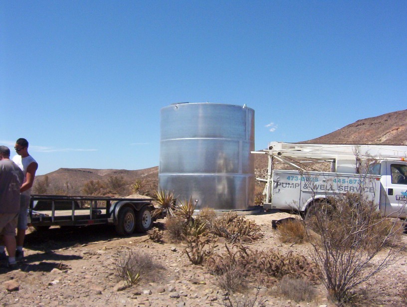

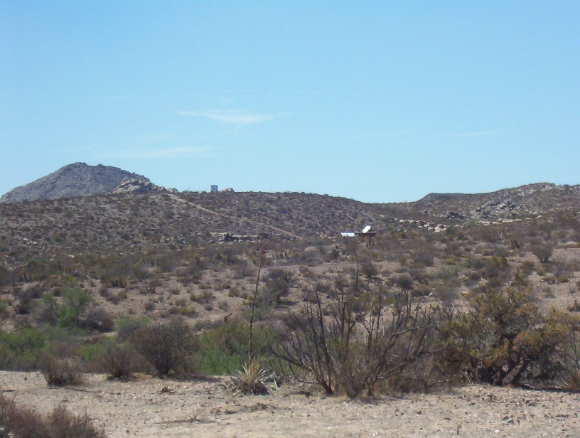

Here in San Diego County it's madatory to have a 10,000 gallon water tank for fire protection if your house is over 1500 sq ft. I haven't started my house yet but had my water tank delivered today. The tank is 100 ft above my house pad in elevation and about 500 ft from the well. I will use my tank for drinking water as well as fire protection.
This is a large project and I have no exerience so give me your open suggestions since I know nada about plumbing or water projects.
Here is my plan. I will run a 1.5 inch supply line from my well to the tank using pvc schedule 40. I am having backhoe work done this weekend he is digging a 2 ft trench from the well to the tank. From the tank to the mandatory "fire hydrant" I have to run a 4 inch line which will also be PVC put in the same trench. The house is about 200 feet closer to the tank than the well is so the line (4 inch will run down the hill to the hydrant, then I will reduce it to 2 inch and run it to my house. I will have a shut off at the tank, the hydrant and my house. The well will have a ball valve at the well. Please pipe in with suggetions, things that come to my mind are water hammering, backflow prevention.
My house will be totally on solar and propane so I will have a propane generator that runs the well eventually but for now it's a gas unit. This is the reason I am running the well to the tank and then the house, with the well at 700 feet I need to use an electric well pump which is already in place.
I attached a few photos and will have more, these make the distance look greater than it is.
This is a true tractor/ backhoe project and, I'll have plenty of tractor photos since I am doing all of the back filling myself and this morning I leveled the tank location area.
Thanks
ps piping will be galvanized where exposed going into the well and tank.

Saltman, what diameter is your tank? It looks to be 12' tall at the sides, but is it only 10' in diameter. If that is the case your a bit short on the 10,000 gallons. Your tank supplier might have brought out the wrong tank.:eek: Just trying to give you a heads up before you have it plumbed in.
   / 10,000 gallon water tank delivered
I'll measure it but am sure it's at least 12 feet across. It weighs over 3,400 pounds empty. It's been a while, can you give me the formula for volume, maybe I'll get lucky and it's larger! Most all the tanks here are the same size since the county requires they are either 5,000 or 10,000 gallons depending on your house size. Some of my neighbors have both and this is as large as theirs I am pretty sure, but I'll double check the measurements. The well guy fabricates these himself and gurantees them, so if it's not I can switch it out if he is willing to drive up the hill again that was a sight, they blew a tire going up and almost skid into each other coming down. It's funny but in a city like San Diego there are only a handful of well drillers.
