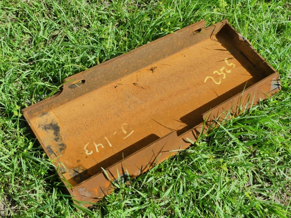

Do John Deere tractors generally require "proprietary" attachments/implements, or can they accept generically-designed attachments? Or maybe it varies by JD model, etc.
That's my understanding based on comments over the years, but it seems unlikely. For reference, my total tractor experience is having a subcompact Kubota for 6 years, so please excuse my ignorance if that's incorrect.
   / 1 tractor rest of forever -- what brand? #127
JD usually do not come standard with quick attach skid steer compatibility.
They have their own simpler setup, which weighs less, a good thing on a small tractor grapple, but
you have to buy Frontier green implements to work with that setup. I think many JD's have converted over to SSQA format.
Everyone else uses the SSQA format.
any implement can be used on a JD if you convert the JD to SSQA.
that green and orange color does clash though... ;)
   / 1 tractor rest of forever -- what brand? #128
The smaller ones can use implements that attach to the frame of the tractor using a proprietary system, such as a plow, broom, front-mount snow blower, etc. All of the Deere compacts, through the 4 series, use the JDQA system on their front-end loaders. The JDQA system is as ubiquitous as skid-steer quick attach, because John Deere makes up a large segment of the market in their own right. So it's not an inconvenience with regards to finding aftermarket accessories, typically; I even prefer the JDQA, it's an extremely simple system. An idiots idiot could master it.
Also, some dealers love to try to talk the iMatch down as a proprietary system that will cause you all kinds of headaches, and then they'll try to sell you on a different brand QH that follows the same standard specs.
