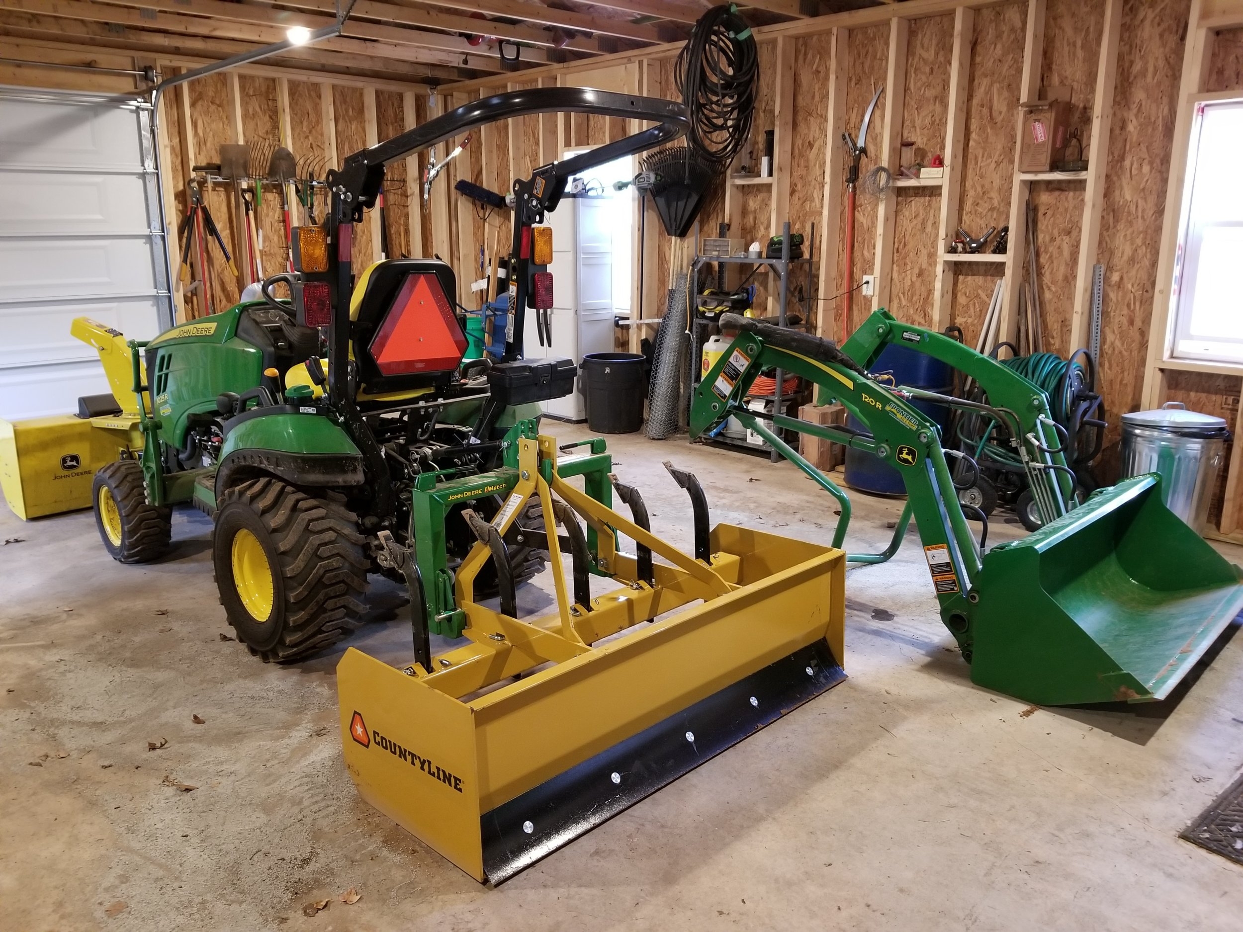

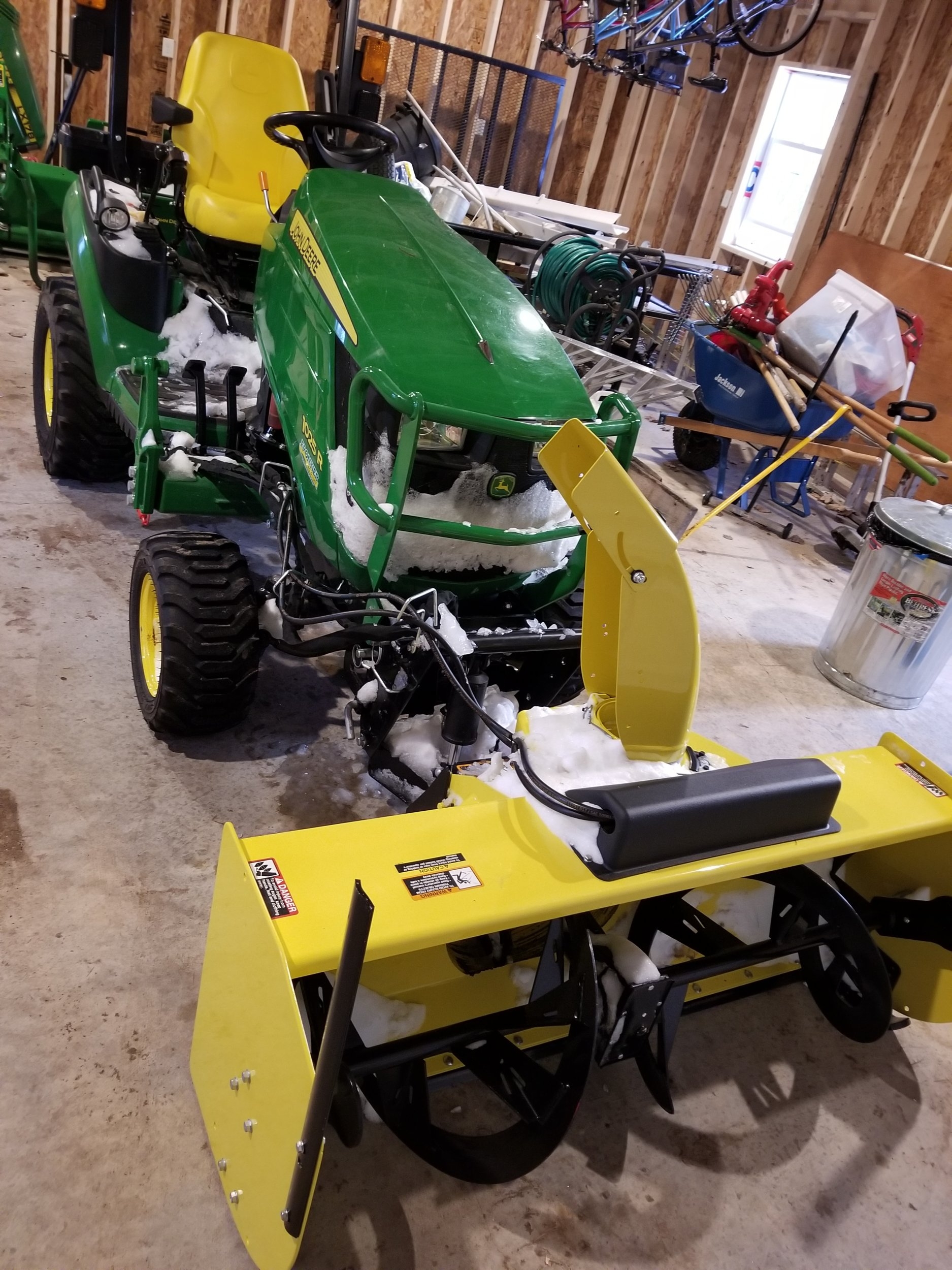

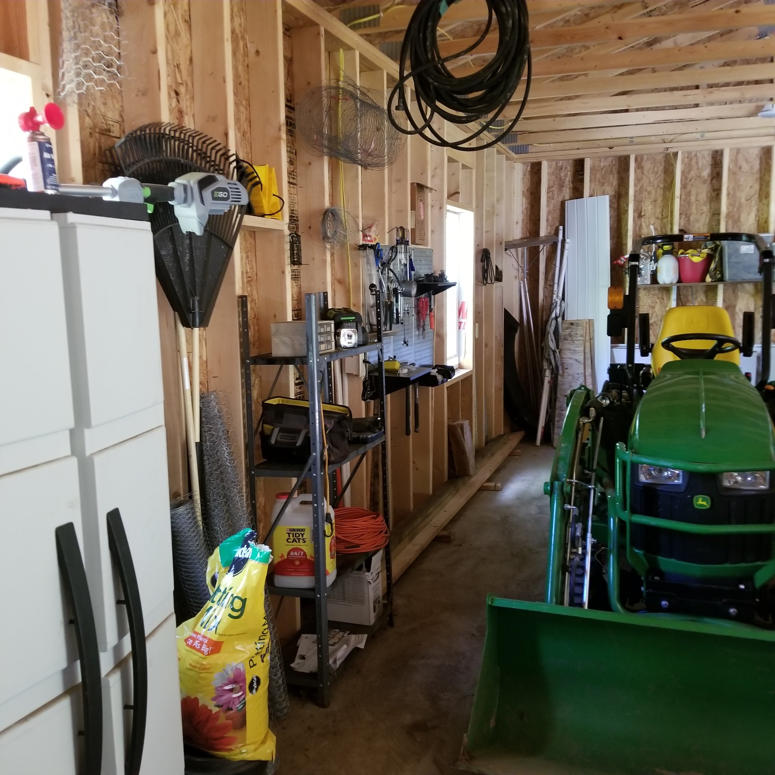

I bought a 2019 John Deere 1025R when I bought our 5-acres in NW WI.
As part of the new tractor I had included the iMatch Quick Hitch 3-point, a mid-mount drive over quick-connect mower deck, and a 54" front snow blower.
I had it less than a year before I realized the mower deck was a bit of a hassle because to many obstacles like trees bushes, flower beds etc..., it was just not compact enough for my needs. I also purchased a front end loader and a rear ballast box. I use the loader far more than I ever did the mower deck. Shortly thereafter, I bought a box blade for the back and I just leave it on 95% of the tie as my ballast.
Usually sometime in late October, I remove the quick-connect loader and put the snow blower on and usually sometime in April or May, I switch back to the loader.
This tractor has done everything I have ever asked it to do. I have pulled out small trees, I have lifted full buckets of concrete chunks to dump into rented dumpster.
All in all, this has been a great tractor and I most certainly would buy again.
