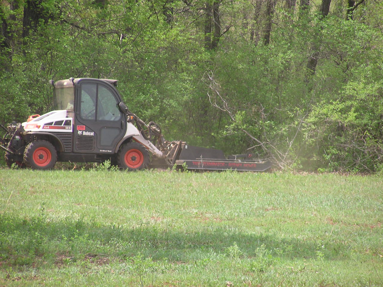

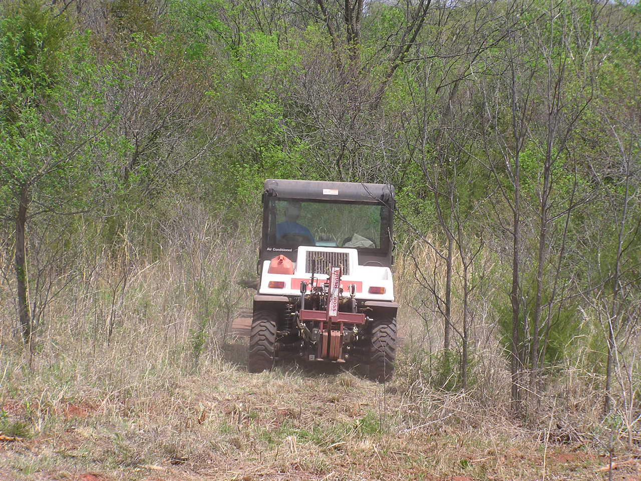

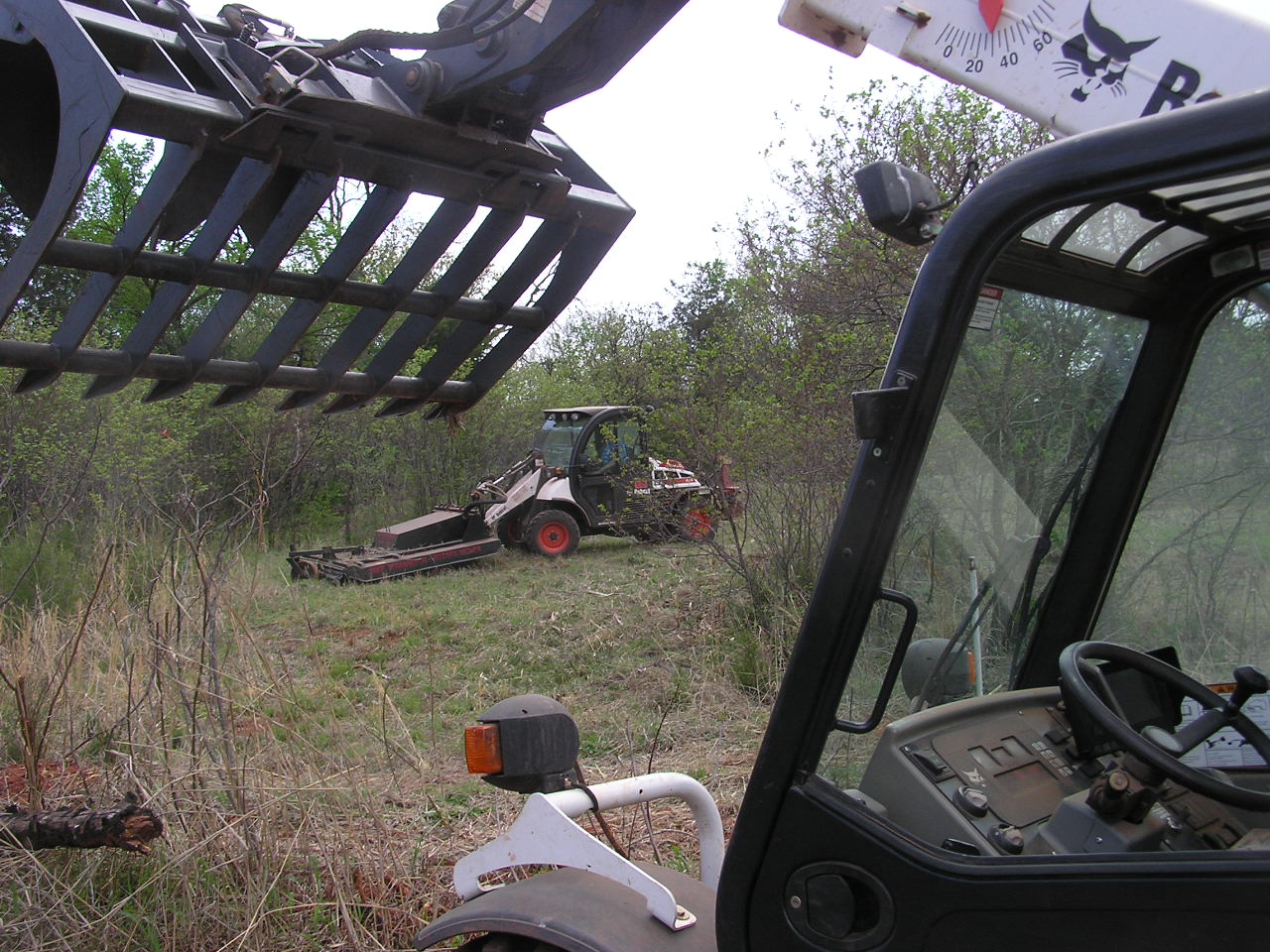

Half throttle doing what?
Our 5610 Series F idles at just over 1200, and I think max is 2800, so half is 2000.
I told my wife to run 1800rpm, Hi-Flow with the 7' brush hog. It has plenty of reserve power to go up small hills when mowing.
