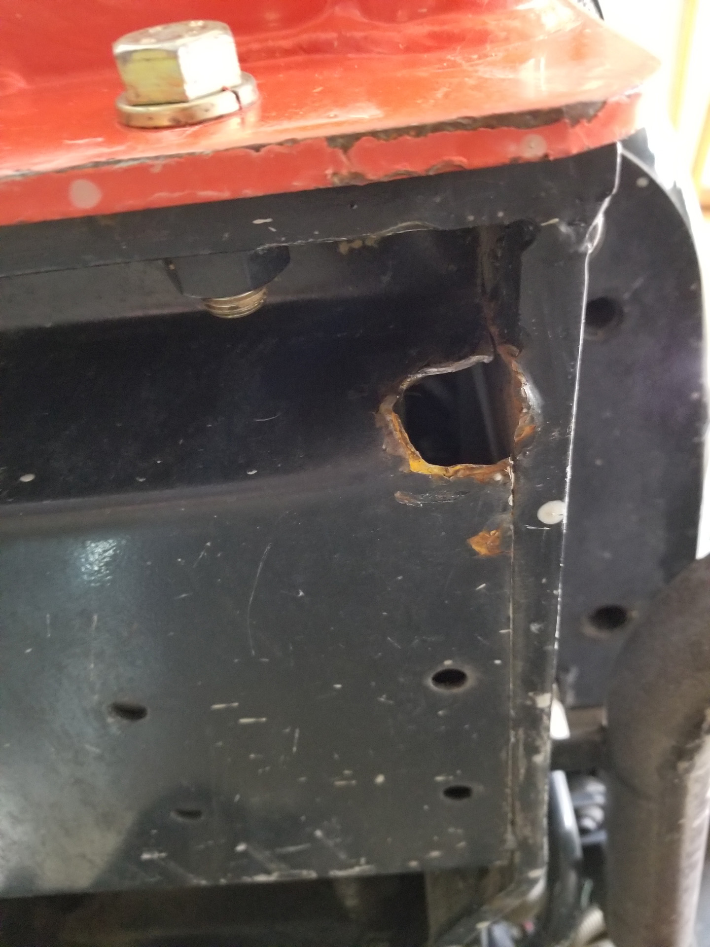

i did have one other issue this winter. i pulled my tow hook off the tractor pulling a neighbor out of a ditch in snow and ice. i found the hook, and found that Kioti really sucked at installing it the first time. it was welded to the battery compartment plate instead of the frame. i ground down a flat spot and rewelded it yesterday to the frame. wont pull free again. 20190403_113147.jpg.
this is where it was attached . looks like 16 ga steel and they attached a 1" diameter steel hook.

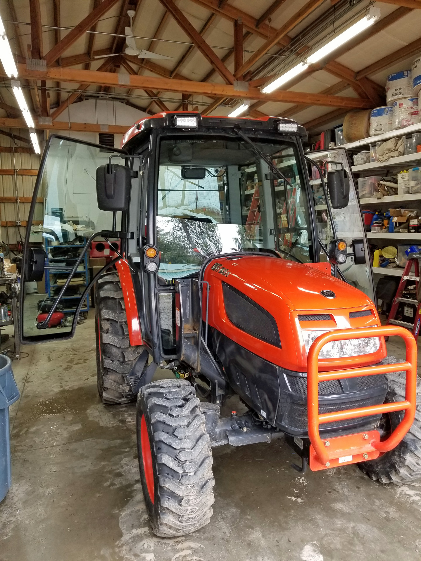

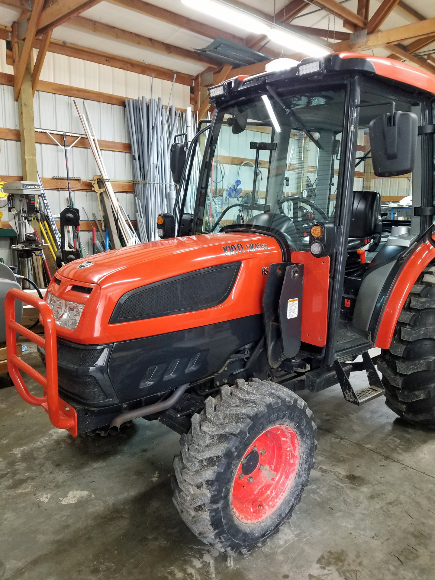

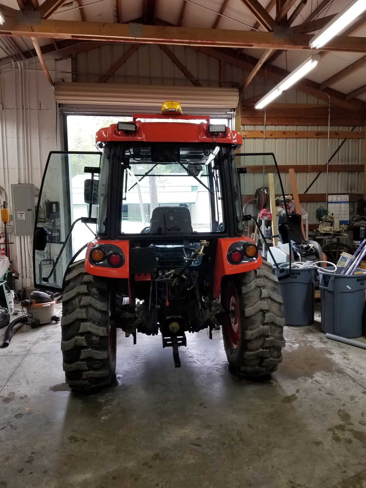

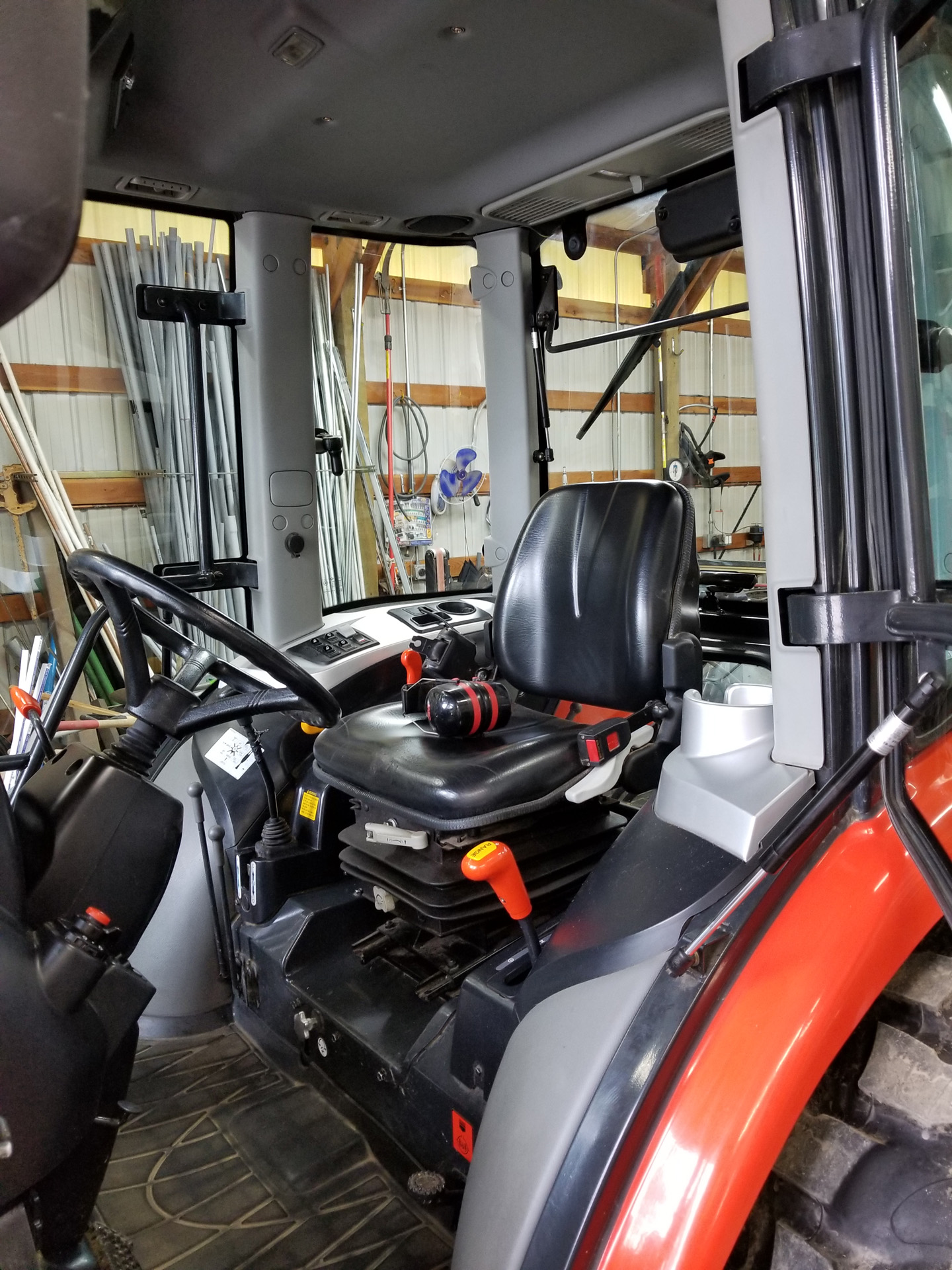

heres the tractor all pretty again. it was a real mess after winter.20190403_113128.jpg 20190403_113245.jpg 20190403_113309.jpg 20190403_125418.jpg 20190403_120229.jpg
This time i even took out the floor mat and hosed it down and Armour alled it. It looks so nice now, im afraid to drive it.....well not really.
