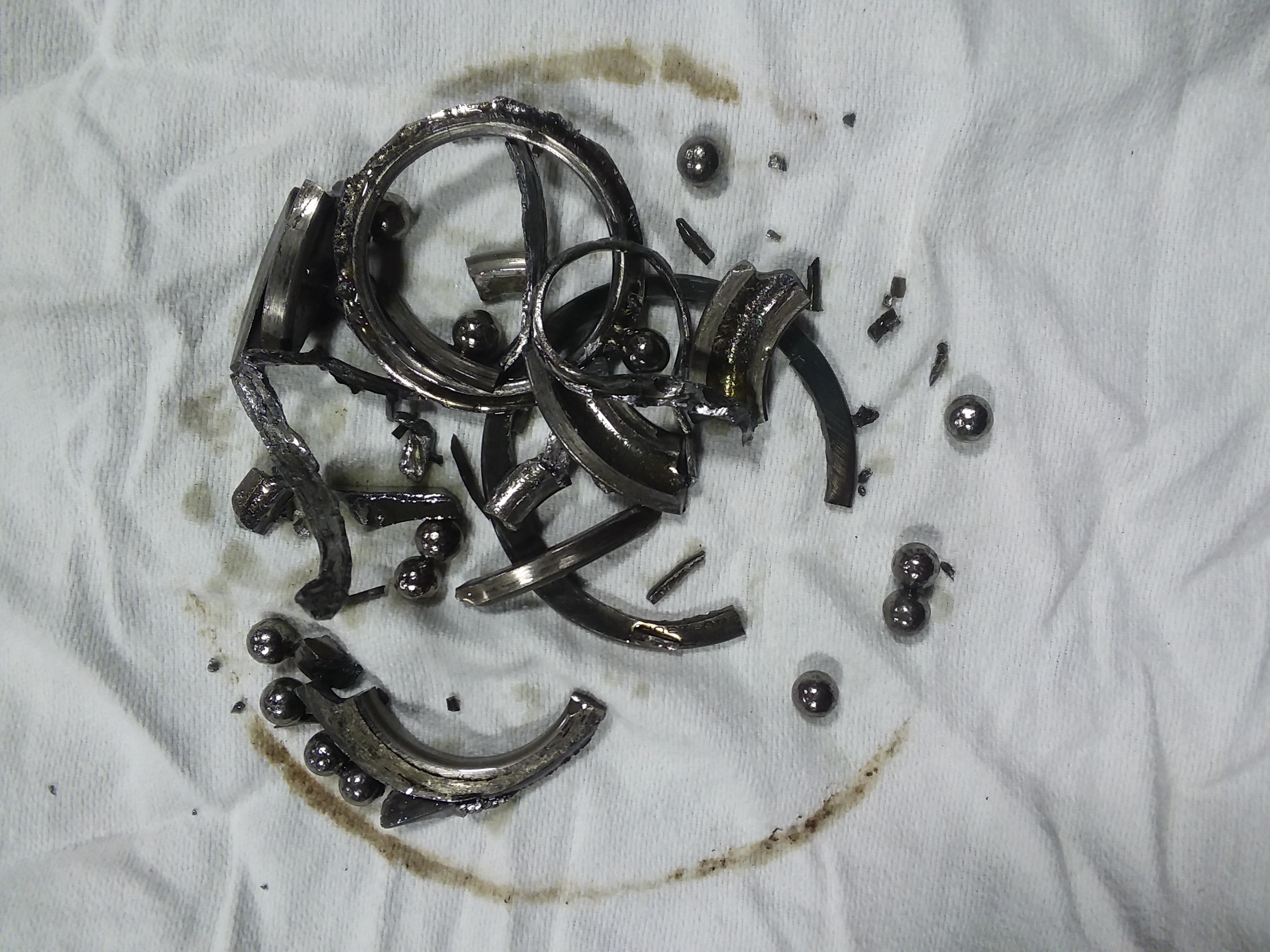

Ford 6640
I recently bought one knowing that the transmission was bad. I bought the work shop manual and checked the fluid pressure at the 3 ports, forward-reverse-neutral, and have absolutely no pressure from any of them. Any suggestions on where to start looking for the problem? Thanks

no pressure at all could be due to a severely clogged filter, or broken pump/drive to it..

Found the problem. This is the bearing from the HST pump. Now all I have to do it find a new bearing and the 8 pistons because it scarred them up too.

If the piston slipper and swash plate surfaces are not perfect you will not have a successful repair.
