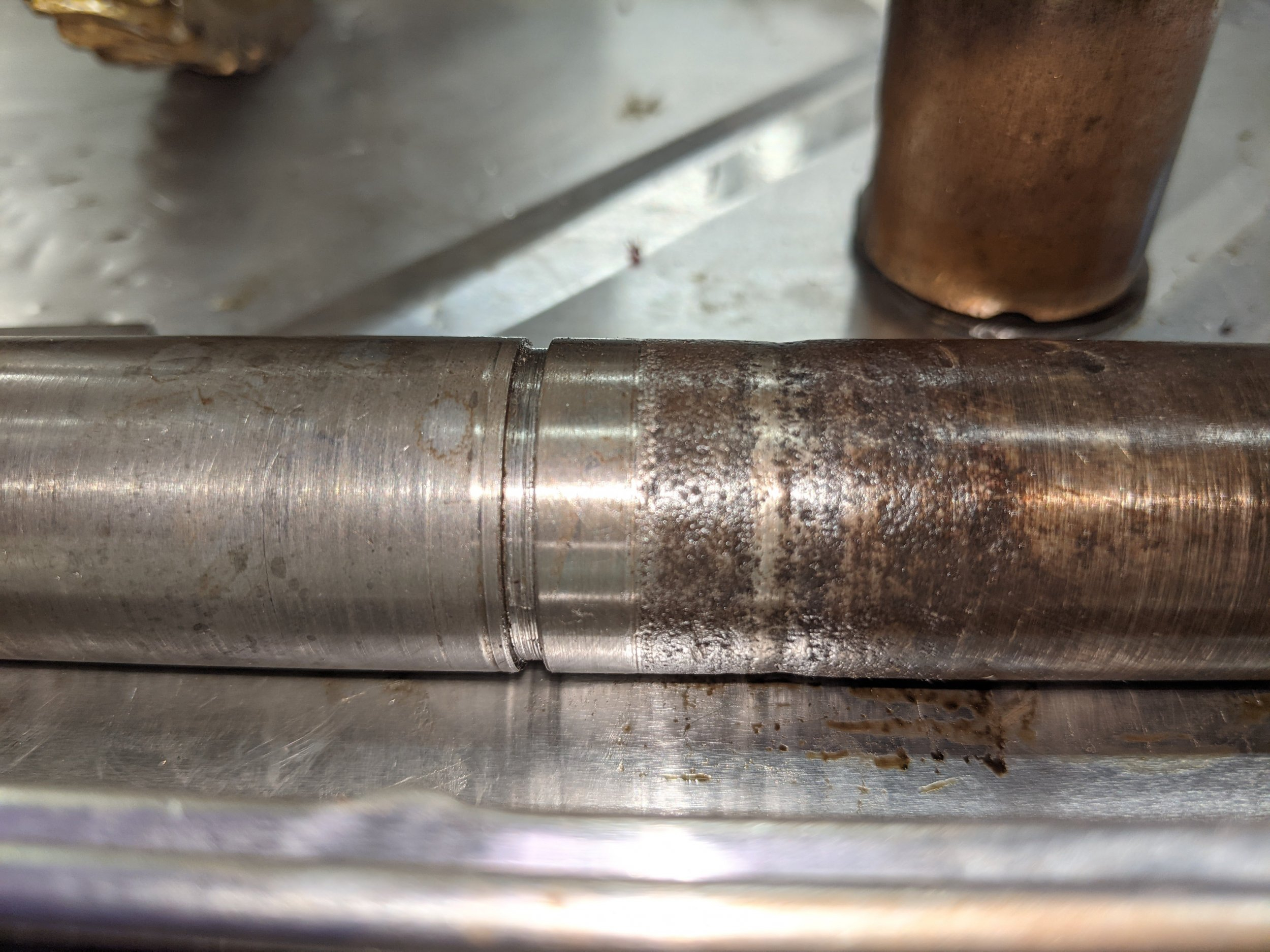

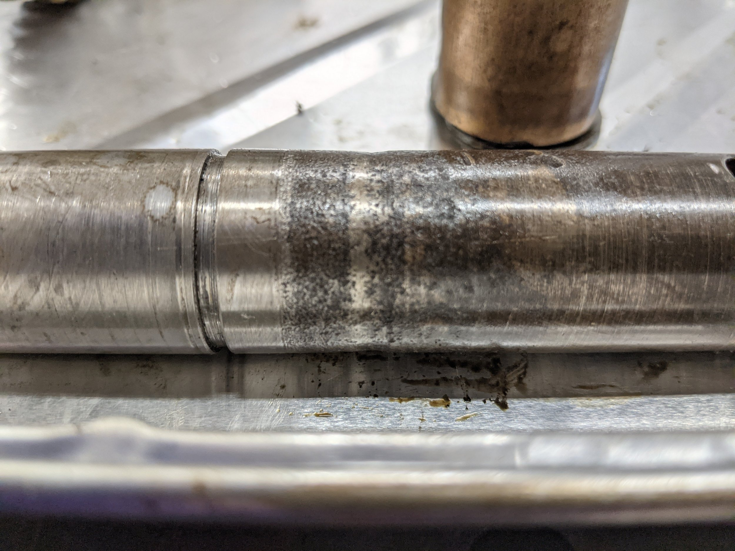

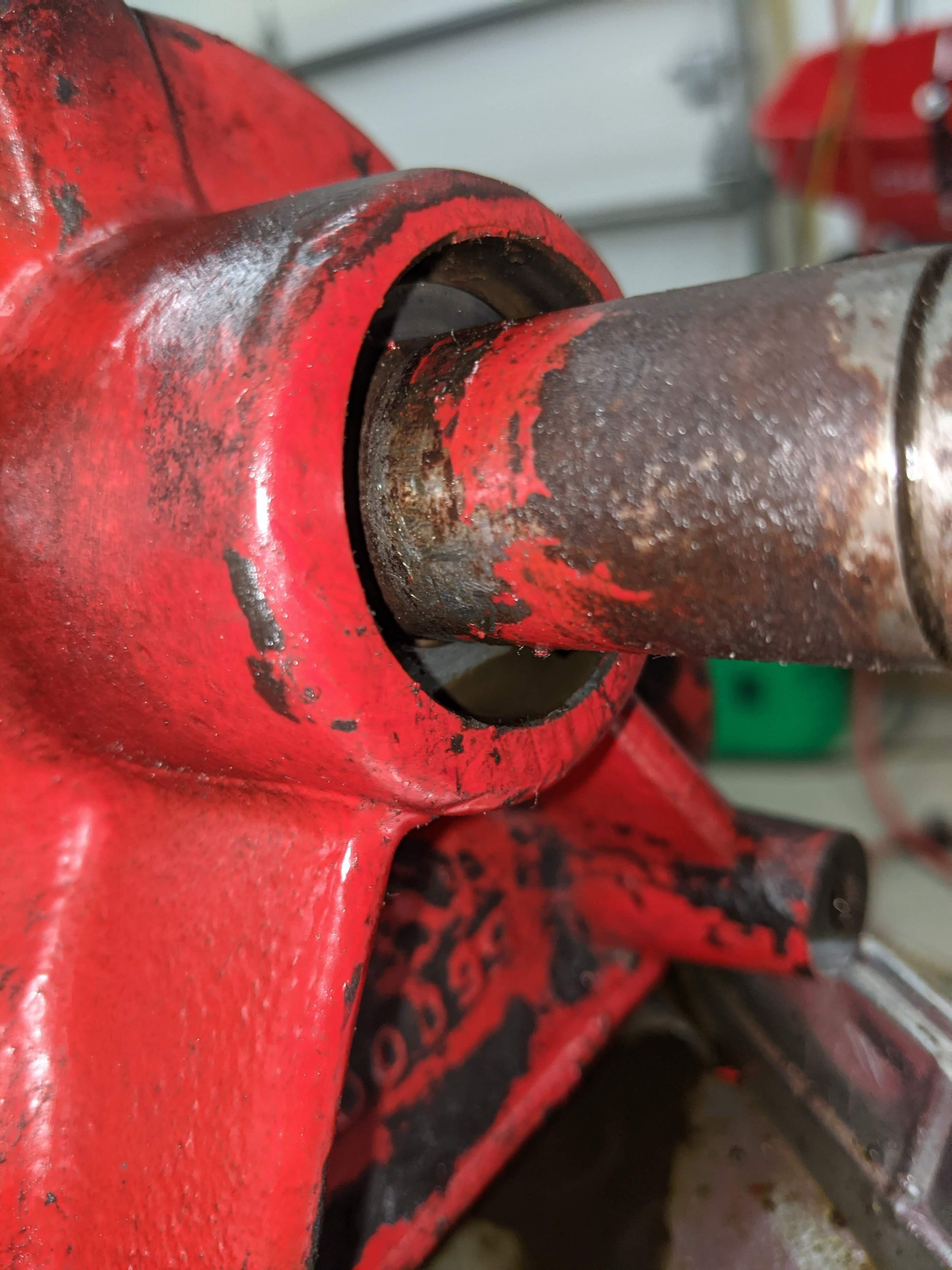

We got my MIL's old Troy Bilt Tuffy after she passed a few years back and I am getting around to dealing with it now. Carb needs help, no surprise, so will probably just replace. But here is the main question. All gear oil leaked out due to a couple bad seals on the wheel and tine axles. I have pulled those 4 seals (wasn't easy) and find that the shafts are scored in spots (one each). Replacement shaft seems possible on wheels but for $100 and the tine shaft I am unsure as there is some sort of "kit" for a whopping $300 but no idea what is in it as they give no details on the supplier sites I have looked on. By the time I replace both of those shafts, seals and a carb I might as well buy new with how much it will cost.
If I just clean these up with emery cloth does it have any chance of sealing again? I'm guessing poeple will want pics to really know so I will go grab some here shortly and post those up. At least one spot had a pretty decent gouge in it. Any methods to fill that will work and not destroy the shafts? I could try TIG build-up but always worry about warp with welding on a shaft.

speedy sleeves could work for you ---- I would just throw some weld on it and turn it down on the lathe. ---worked on case reverse idler shaft that was cut deep, so it can be done ---- just use enough heat to make decent weld. Some guys say high heat and move fast, I never tried that.
Still have my old tuffy here, only use him to cultivate between cabbage and tomato plants. Horse goes between the rows.
   / Tuffy rebuild #4
Switch from gear oil to grease in the gearcase. What I did, I had a leaker too. Filled the gearcase with chassis grease. Issue solved.

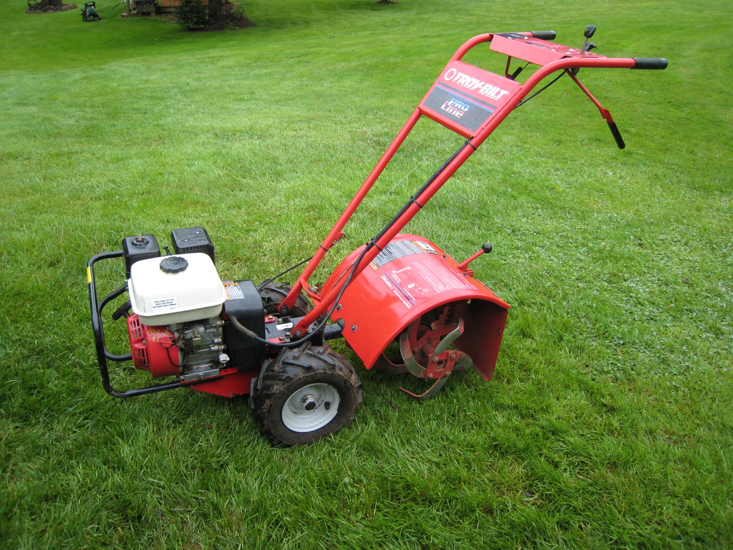

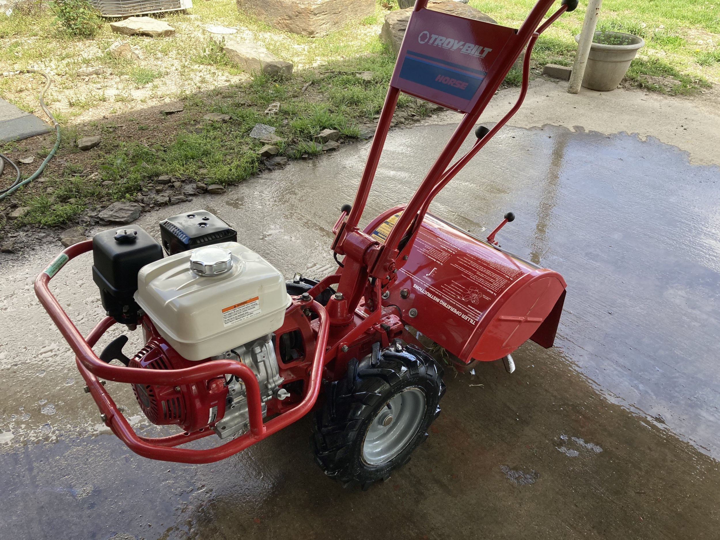

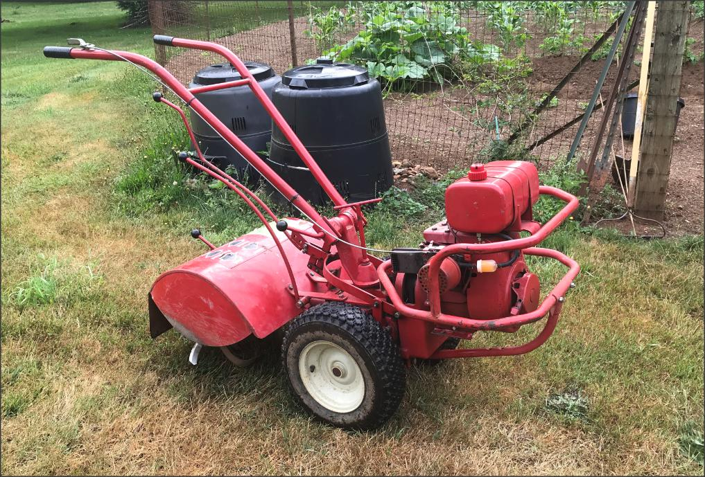

I have a 29 year old Horse I just RE powered with a GX270 8.5hp Honda. The old Kohler had the coil go bad and the kickback ruined the recoil starter before I was able to figure it out, the recoil is not serviced by Kohler anymore for the M8T. Well I had a tine shaft leak and the shaft was rough so I used a speedi-sleeve. She’s good as new, maybe better, now
   / Tuffy rebuild #9
It sure looks like new!
   / Tuffy rebuild #10
I noticed when I had it apart the depth drag bar was worn down almost through to the rear bolt hole. I had some hard surface electrodes so with my old Lincoln Idealarc250 I built it all back up and hard faced it. Good for another 29 years now

Wow that thing looks like new! How did you keep the label from wearing away with 30 yrs of use? That's just crazy! And yes the Pony model you show is identical, probably just newer. I think this one is 1998 vintage.
So I got it apart all the way. The wheel shaft looks pretty good and cleaned up with some emery cloth but the tine shaft looks pretty chewed up (to the right of the snap ring groove in the pics). The easy route will be to just replace this shaft, as it is $80 and that is not too crazy. I'll have to look into speedy sleeves as I have not heard of them before. I don't have a lathe but have a friend who is an ex-machinist that is well-equipped. I don't want to put much money into it but we did get it "free" and for what we need it for, it fits the bill. The small garden area is terraced due to our steep hillside and no way to get my tractor into it safely as it is way too big for that. We just don't have much open space for gardens here.
I've got a new carb coming next week and want to verify the motor works before I sink any more money into it. If it powers up and runs OK, then I'll get the rest of the parts. If it becomes not worth it, then I will probably just rent a tiller once a year to prep the garden or something.

I babied it for all those years, kept it clean and waxed in the shed when not in use.
Take your shaft to a bearing supply house and they can fix you up with a sleeve. They aren’t cheap but are a cheaper alternative to building up and turning it down

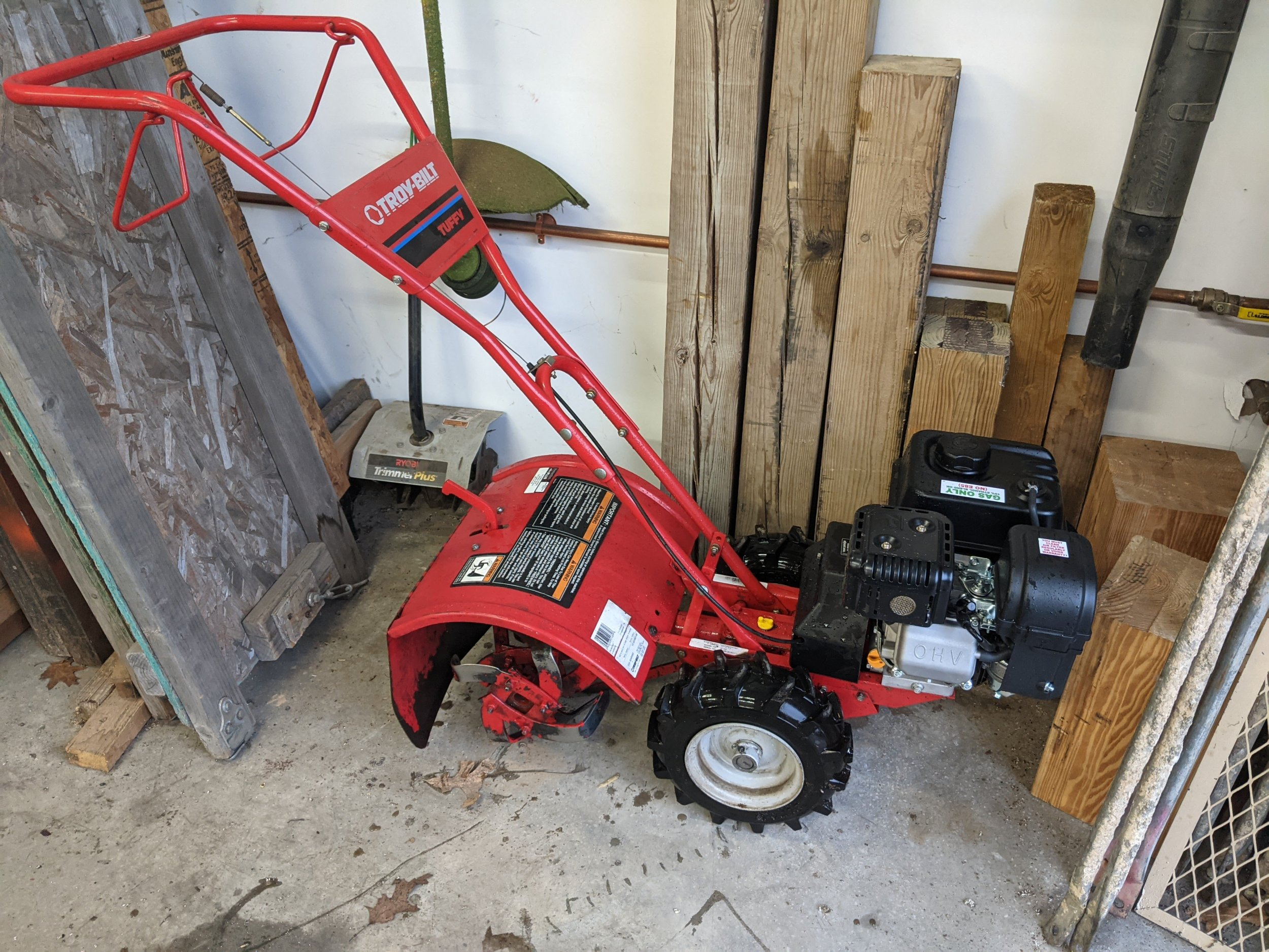

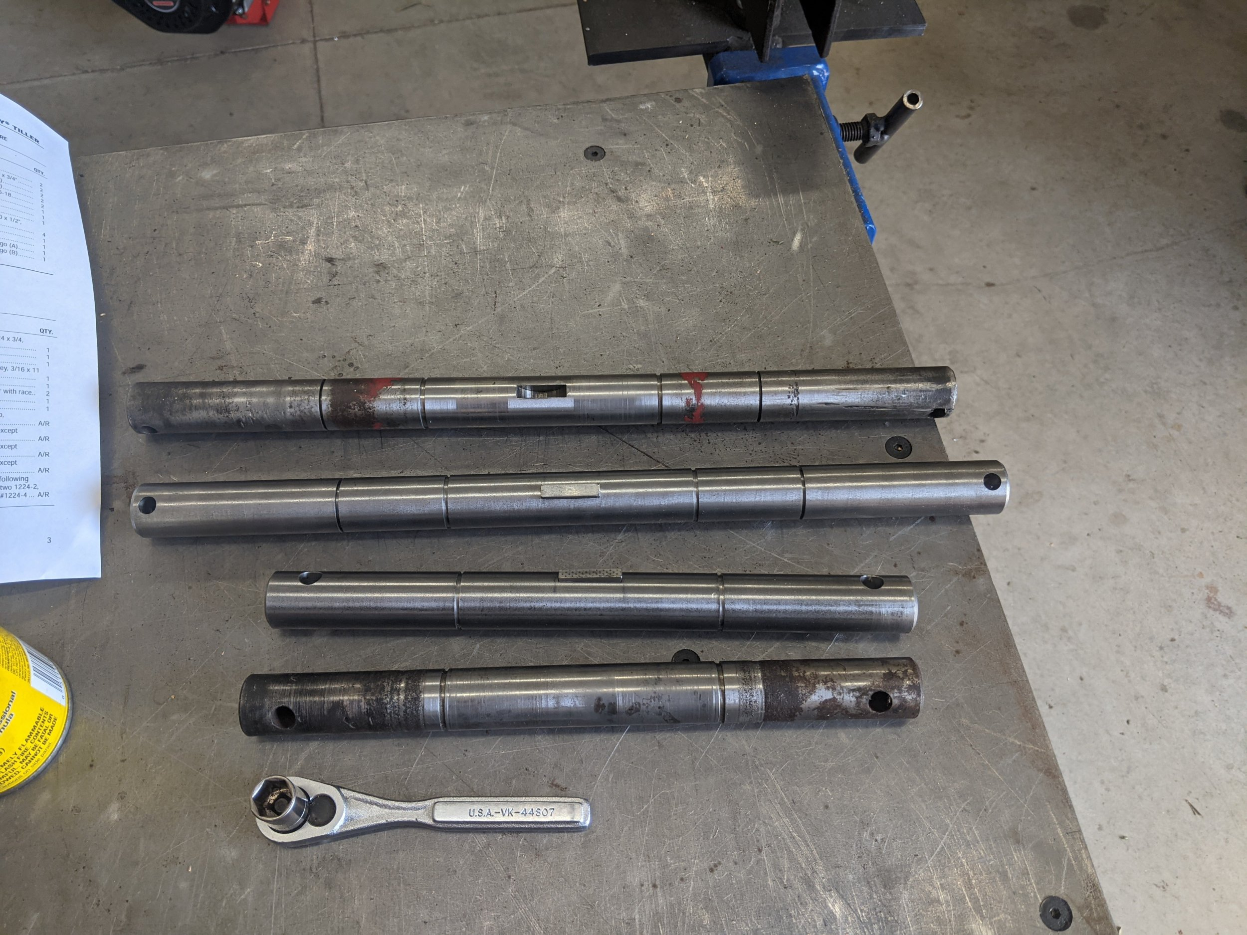

Figured I should wrap this up....
Well I ordered a bunch of parts from 2 places - partly due to cost, partly due to stated availability. Well the one place sent their stuff promptly but the other place was waiting on 2 items to be able to ship - 1 was just a simple o-ring for the oil filler cap but the other was the shaft for the tiller tines. O-ring I can find but the shaft was first listed as 2-10 days...then 2 more weeks...then 2 more weeks... then it said something like "we don't know when these will be back in stock". Welll sheeeeiiit. So I called and said cancel the back ordered items and send the rest. Pulled an o-ring froma kit we have at work, so no biggie but the shaft was another issue.
I asked a friend who is a former machinist who knows his way around tools and also HAS the right tools (lathe and Bridgeport in this case) if he could make me the shaft. It is a simple shaft - 2 grooves for snap rings, 2 holes for the bolts holding the tine assemblies and one woodruff key slot in the middle for the drive gear. The woodruff key is the only part of this that is a bit challenging, but only if you don't have the right cutter, but he did. A chunk of 1" CRS and he zipped it out with me watching like an idiot in an hour or two. Then my 2nd batch of parts showed up and I started to figure out how to put it together. It's a bit of a puzzle. But as I started that I was looking at some parts that I had not closely inspected before and said, "ya know, I should get some new bits here" and remake that other shaft if I am going to "do this once, do it right"... So back to my friend's place with another bar of 1" CRS and the other shaft was done too. Almost the same but longer and 2 more grooves to turn. So we banged that out in an hour or two and the rest of the parts showed up, so it was reassembly time!
Mostly got it together last Sun but just finished it up tonight and took it for a test run. It works! Yeah it's a bit of a lightweight but I think it did OK for our small garden and should do the trick. So here's a couple photos. One of the new shafts next to the old ones, and the Tiller all complete and put away after the first run tonight.
Thanks for the help guys!
