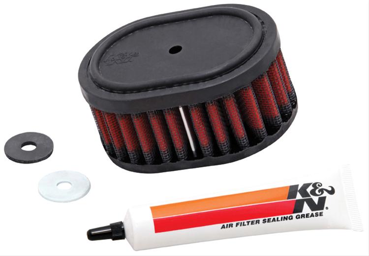

I watched it and the seal was dry. It should be oiled. All air filter seals should be greased or oiled. Anyone that thinks otherwise needs to educate themselves

I noticed in his video when he pulled the filter off there was fine wood dust on the filters rubber sealing, this tells me the filter was not really tight and was not truly sealing. So STHIL using the cover locking knob for both locking the covers down and sealing and locking the filter is not a good Engineering Design.
661 has poor filter set up too. Why loggers switch them over to aftermarket set up to try and stop the fines getting in too.
You can tell which stihl saws dont have the air injection type air cleaning systems. They sell kits for the 661 and older ones. 500 should make that list after RD. MAXFLOW CHAINSAW AIR FILTERS for Stihl Chainsaws.

And those Maxflow filters are oiled so they seal against the air box
