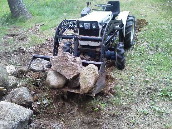

My S-370D Beaver is a stout little tractor. It is well put together and very versatile, I've used it to replace a Powertrack 450 dozer (Chinese) that I cleared my land with. I've moved many yards of dirt and gravel, pulled stumps, lifted small engines, and several 400 pound (+/-) landscape rocks. I've only had three problems: one rear rim rusted through and split (calcium in the tires for weight); had a starting problem that was solved by cleaning the battery/starter grounds; and made the mistake of lending it to my daughter's boyfriend who gave it back without a clutch... (splitting the tractor this weekend). This tractor has done everything I've asked of it. I wouldn't dream of replacing it.

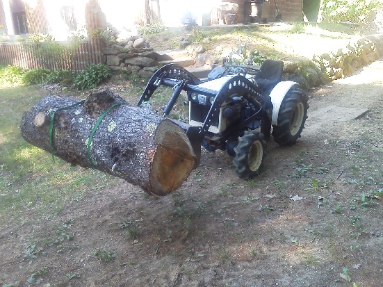

I really love this little tractor. I love to go everywhere I want, between trees, between shed a the garage. A very strong tractor. You can feel the solidity. Only two complains about it: a little bit too light, I spin easily on snow or mud, even with calcium in the tire. And the other problem is, for sure, the counterclock wise PTO. You can put a front snowblower on the back of the tractor to have correct spin direction or find a PTO reverser. I also have a 5ft front loader and it is very strong, I can lift my 600 pounds Honda Foreman VTT 9 feet high without problem (but have to attach my snowblower at the rear for counterweight). So I plan to buy a Satoh Buck. Same tractor, but a bit more power, a correct PTO, a little bit heavier. But the same strongness and reliability.
