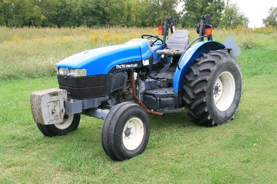

Model Year: 2001
- Eng: 72 hp., 540 RPM - PTO: 62 hp., cat one/two hitch. synchro command, - Chassis *001186970* - Mechanical shuttle lever (F, N, R), Range (A, B, N), synchronized gear (1,2,3,4, N). - Front Tires: Titan 9.5L-15 SL, TRU-TRAC, nylon, 6 ply rating, tubeless, F-2 MAX SPEED - Rear Tires: Titan16.9-24 R-1 all-purpose, nylon 6 ply rating tubeless, high traction lug, leverage notch
