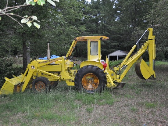

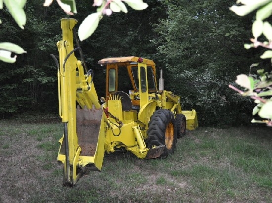

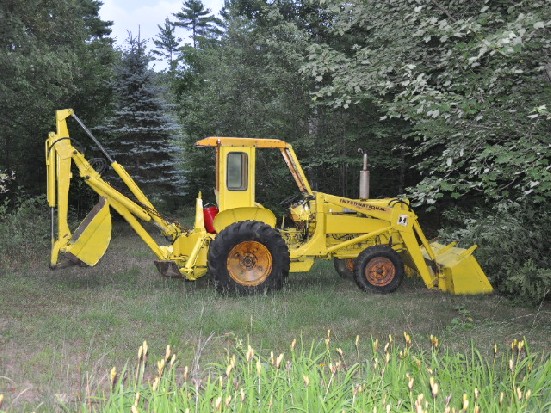

It was built in 1960, has a Wain-roy back hoe and an international 3000 loader, So far I have rebuilt the power steering box including welding grinding gear teeth and machining new parts (none available) replaced 'o' rings on rear axles, made new pins for the fast reverse shifter, unwelded and repositioned the steering arms on the front spindles. Painted it bright tractor supply yellow. I am in the process of removing the backhoe valve body to rebuild that (boom won't stay up) cleaned the (main) filter changed the hydraulic oil still have to change the filter on the loader seems to be lacking hydraulic power so after the valve and filter I can only hope I don't have to go after the pump. On the other it's a gas engine and runs really well.

Bought it cheep, the ratings system need s a "0"stars "have no experience" category. That being said I bought it with steering issues which led me to rebuilding the steering box,parts no longer available so welding up missing/worn gear teeth and re machining, machining a new rack for the power steering cylinder to operate,bushings seals ,etc. Replacing pins in the fast reverser shifting fork,"o"rings in the rear axles, got the rust/water out of the gas replaced the sediment bowl(dropped a wrench on it) un welded the front spindle arms and relocated them,now on to the backhoe valves (boom drops) and should be good to go.
