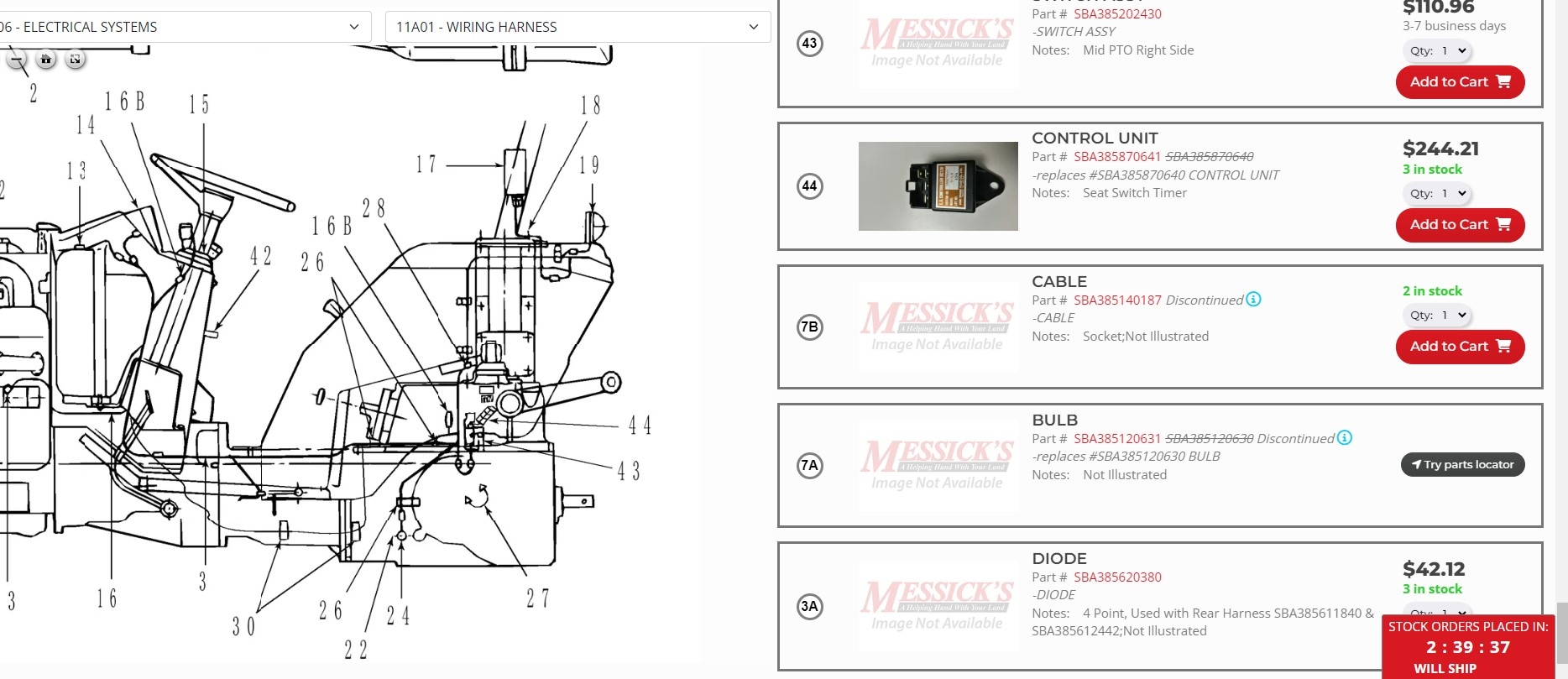

   / TC30 Starting Problem #17
The wiring diagram I saw doesn't show a dedicated safety controller. It's mainly a series of switches, relays, and a seat safety switch timer. (whatever that is)
   / TC30 Starting Problem #18
Maybe referring to #44, Seat Switch Timer, which I would figure out how to eliminate.
   / TC30 Starting Problem #19
Well as I see it on the diagram I'm looking at the start relay is grounded through all the safety circuits. The relay has a four pin connector with a black and white, a black and red, a white and black, and a yellow and black. The white and black is the ground wire. I would try skinning back some insulation off the white and black wire, attaching a jumper wire from there to ground and see if the starter will operate. If it does, then the relay, key switch, and related circuits are working. Back to the safety crap.
