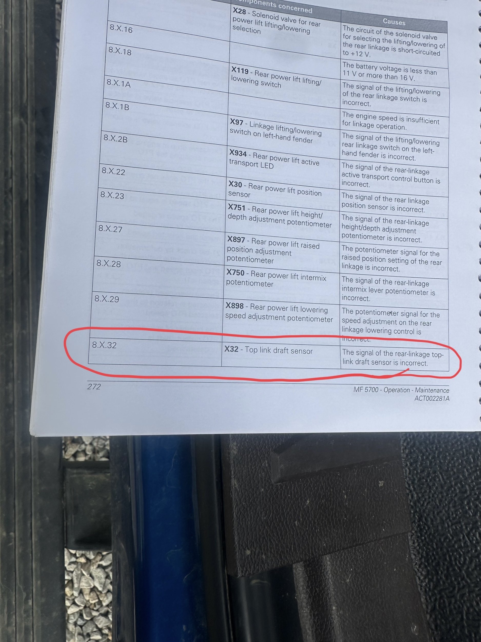

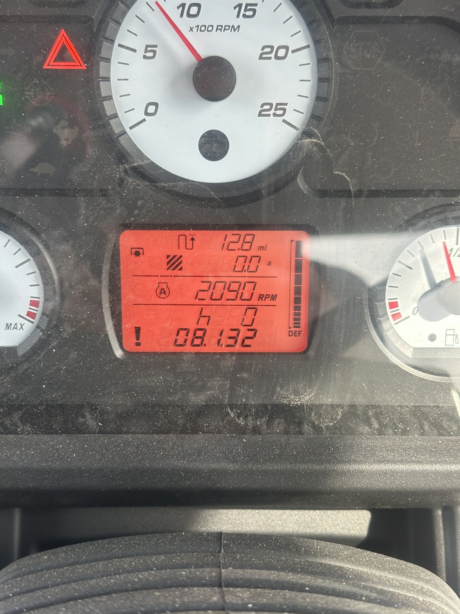

   / Should have listened to Hay Dude…lol. New massey 5711 3 point hitch gone wacky.
The draft knob was set and worked fine for about 4 hours of plowing, so not sure its the issue…
but today i was discing and not using the 3 point at all. After a couple hours of that i got a fault code beeping. I was like crap, this junk is broke again. The code flashed was 08.1.32 which if I remember the tech said the .1 is actually read as an ”x” in the fault code which shows a draft sensor issue, if I’m reading the fault right. So fingers crossed, I’m stopping by dealer in a bit to discuss.
