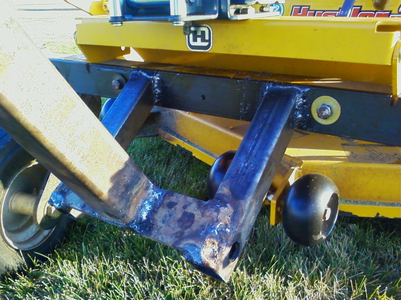

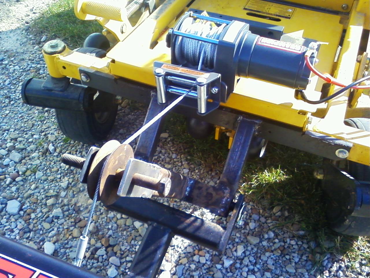

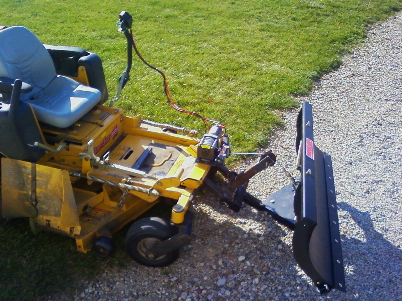

I fabed this very simple bracket to mount an ATV blade to my Z. It does a really great job with chains. I pushed 18" pretty easily. Don't laugh at the welding... I am out of practice.: )

My ZTR spins on wet grass. Do you have R1's or turf tires on the back.

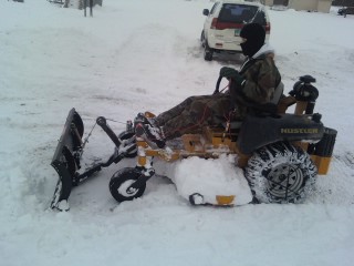

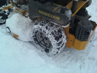

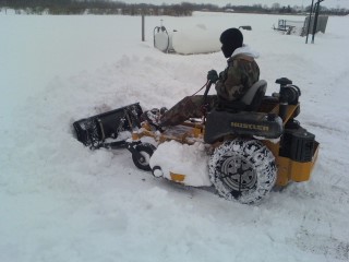

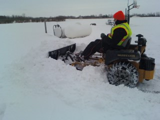

Terfs with chains. It does spins a little but still moves piles of snow. I will be pushing some more today and will try to get some pics.
   / ZTR Snow Blade
Some snow pics from today Pics
