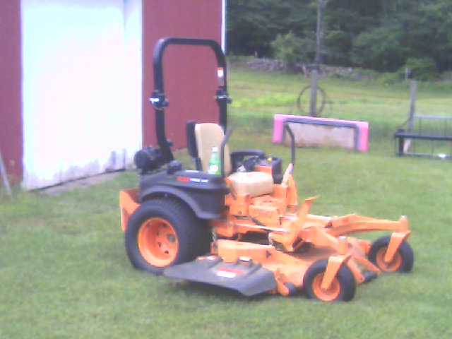

ZTR! I would never go back to a garden tractor. IMO a ZTR's quality of cut and speed are not comparitable with a garden tractor. . . . John
