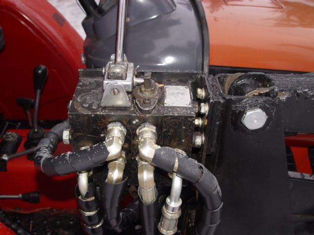

Rob, My ZL-20 valve looks different than the one you show. Richard

   / ZL-20 FEL Valve Comparison #10
Rob, here are the pictures of the valve on my ZL-20 FEL. Richard
