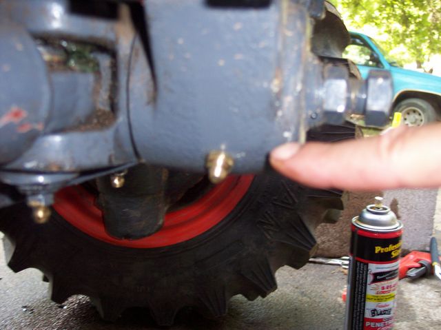

I'm going to do battel with this thing this morning. I accidently lied when I said it was the power steering. I don't know what it is, but it's the very most forward fitting in the underneith, center of the tractor. A square box that's mounted to the tractor. I'll take a pic in a bit.

Here is the offending grease fitting. I have cleaned it inside, tried to leave some penatrating lube in it then tried to fill it with all the pressure I could muster.
When I had the fitting off, I see a shiney bottom. I see no hole the grease is to travel thru, though maybe there's not supposed to be one. ???
