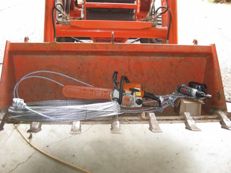

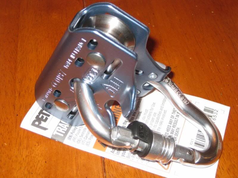

some supplies to get this started:
1 Petzl P24 Trolley with built in carbiner as backup incase of bearing failure, good for 35MPH and 650Lb working load:
300ft of 3/8" 7x19 galvanized wire rope
3/8" drop forged clips
3/8" thimbles for loops:
I made 2 10ft slings to wrap the tree each ending with a thimble for attachment to the turnbuckle, added blocks with a routed groove put in place to protect the tree:
Ideally one would have a gravity stop but I decided to add this block in order to slow the rider to a stop, 2x25ft of 1/2" shockcord secured to side tree makes the stop smooth and effective depending on the weight of the rider it will shoot you back up uphill for an easy exit:
