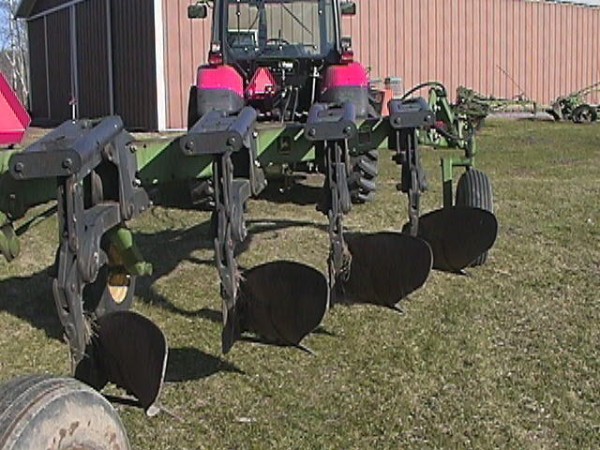

I picked up a JD 3600 4X18" on land hitch plow to turn over an unused 10AC field. Farmer I bought it from said it was too big for his JD 3020's (2wd) 70+ HP (lots of wheel slippage on level fields) he was going back to IH710 4X16" semi mount. It crabbed my PU (chev 1500 extended cab) pulling it home. Then read in the owners book plow rated for 155HP PTO tractor. Hmm maybe it is too much for my heavy MN clay & weeds. Set it up, hooked it up & headed to the field. Started in 3rd low 2wd, quickly went to 4th 4WD 15-1800 RPM's
Awesome! watching a wave of dirt erupt behind me! Wheel spin was less than 10% even climbing uphill.

That's good news Barry. I've been wondering how many bottoms my 4341 would pull. Now that you have taken the guess work out of it, I'll look around for a 4 bottom plow. Thanks.

No problem. I did not intend on another plow but our old 3 bottom 14" 3Pt would ball up on trash & pop out of the ground.

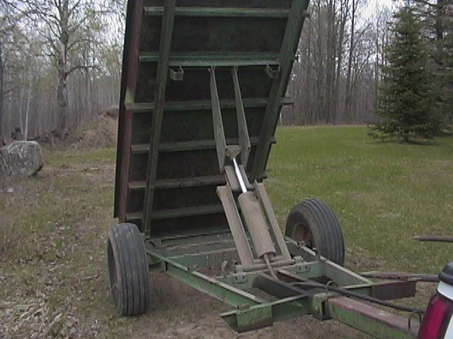

I finally had a winning bid on a rock wagon yesterday. See pix.
The rock in the background was lifted on my 3pt bale spear. Nearly lifted the front wheels off the ground. I'll put a full load of gravel in the bucket before picking it up & moving it to it's next home. Lifting my 40' shipping container on the 3Pt had less influence on the front end.

Rock wagon,eh? Is it just a flatbed dump trailer? Seems like a good idea,as long as the rocks stay put during transport.

Stumbled across a technical discussion of plowing. Simplified as follows. Don't remember which web site I found it.
Plows take 5 min to 17 max pounds pull per in2. 5+17/2=8.5 average pounds pull per in2.
my plow is 4X18=72"
72X8.5=612 pounds pull per inch depth of plow.
8" depth of topsoil & root system.
612X8=4896 pounds to pull plow at depth.
There was 7-8% wheel slippage assumption with the above.
Don't know what pulling force my Zetor is rated at but it pulls the plow without lugging.

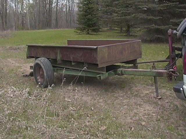

Rock wagon is 5x9
