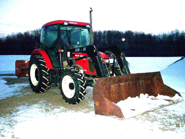

I bought a new Zetor in '04. Very happy with it. At the time I paid $20K less than comparable Deere or NH. A softball size rock took out the back window a couple years back. Replacement was $200, some Deere drivers also had window replacements but paid $700. Service & parts binders are well written & cheap. Maintenance is in the open and easy, loader QT is fast, bucket QT is euro spec and even faster 1 step: throw lever & go.
The US factory support tech is awesome. I emailed once asking how best to clear AC drain lines & he sent back a huge Word file loaded with photographed step by step info...
I run year round so get the -40 to +99 extremes and the HVAC works.
There is a discount internet parts source as well www.zetorusa.com & Fedex/UPS deliver to the barn. They send a nifty 3 ring punched & tabbed parts catalog with pricing when you become a customer.
For haying I'd recommend maxing out rear wheel weights, adding fluid if slopes are bad.
Bigget negative is lack of branding and marketing; T-shirts, hats, etc. If you need to show off to neighbors don't buy this. I'm not on the resale upgrade treadmill either.
Pix with 8' snow bucket & 7' rear blower
