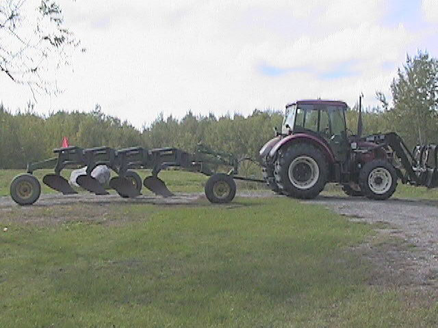

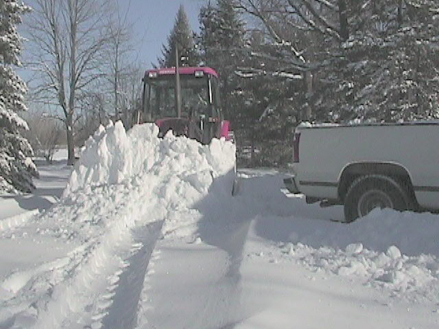

I have the Zetor loader as well & I have not been able to break it. I use mine year round as well including snow removal. I have an ancient 96" 4 yard snow bucket makes quick work of snow.
I have found my local dealer very responsive even though my tractor is small (stands 102" tall & 10,000 lbs) relative to what he normally stocks & sells. The factory technician Petr is also highly responsive... You buy a cheap rugged tractor but get treated like a Lexus owner :D
Most of my attachments are sized for a JD A (35HP) 8 footers. Had to find an old 4x18 trash plow to turn virgin sod & was told by the seller my tractor was too small - the Zetor pulled it in 5th gear & only ran out of traction not power.

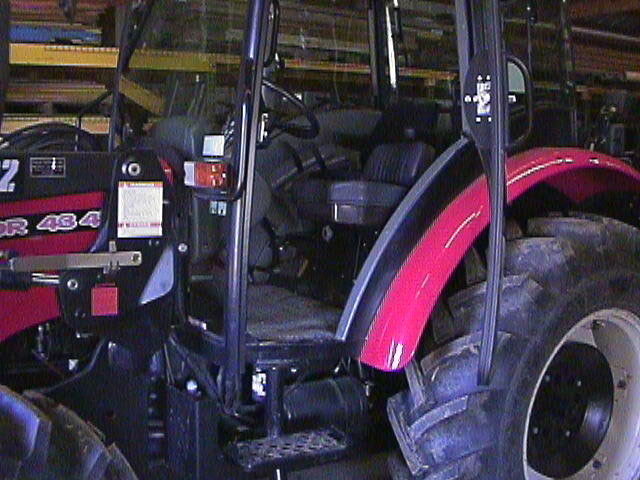

Zetor cabs are large enough for a buddy seat so you can ride along in her tractor.

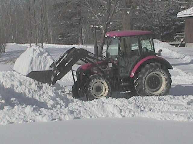

The Zetor loader is strong & you need weight on the back of the tractor to hold the tail down. I bought 4 wheel weights with tractor & will probably buy 4 more (max capacity.) In the mean time I stuck a cat 1 drawbar thru a 55g barrel & filled it with rebar & concrete. It works as long as I remember to go and get it on first.
My place takes 4 continuous hours with a open station 2wd tlb to clear snow. After getting the MFWD Zetor it takes 45 mins and the snow shovels are rusting in the barn because I can place the bucket lip right up to steps, garage doors, etc where the slipping & slidin 2wd would crash thru so I stay 3' away.
If you get a cab also check into a grapple so you minimize climbing in & out. Drive up, chomp down, haul away. Loader takes 2 mins off & on.
