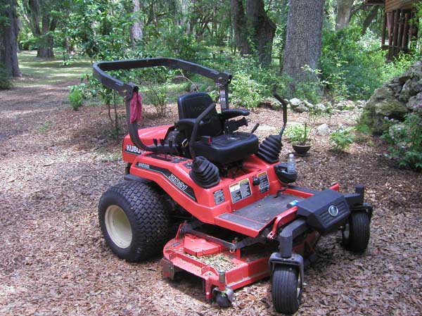

We love our ZD-21 lifesaver, they don't come engineered for anything more heavy duty that this rig.
