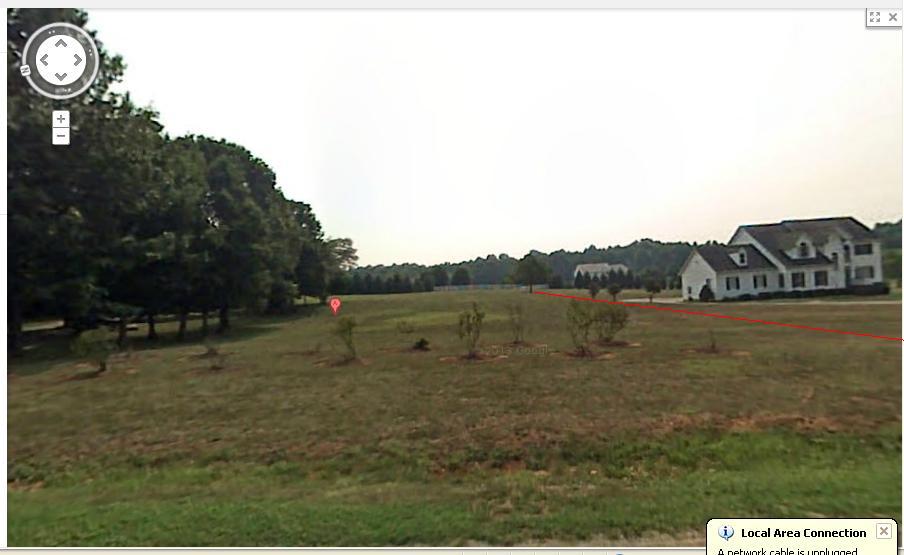

Hey all,
So I just bought a house with 2 acres - of which about 1.5 is lawn. I first jumped on the zero turn mower thought because that is what the previous owner has and hey - more power toys!
So now that I am looking at the $$$ for them, I wonder if I truly need it.
Here is a picture of the lawn:

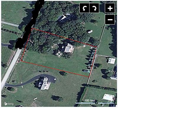

Birds eye view:
Basically everything to the left of the red line. There is some behind the house you cant see but that gives you an idea of the terrain.
I am wondering if a standard riding mower with a 48" deck would be fine also - seems to be a bunch cheaper in the used market.
What do you all think?
Thanks

I love my Toro z420 (42 inch 2005 model), I would never go back to a non-zero. My coworker paid about 3 grand for the same one, I got mine at Home Depot for about $1600 because it was marked down to make room for the next year's model. Both of ours are still running strong.

How do you value your time? Assuming the same deck size, you will same time with a ZTR, and the more obstacles (trees, buildings, etc.) in your yard, the more time you will save.

Nice place. I would think what ever you decide will work, it comes down to what is your time worth. I have a BX2200 and John Deer 60 inch commercial 0 turn. I keep and park the John Deer at one of my commercial property's as it keeps me from trailing machines back and fourth. It is useless for anything other than cutting grass. The BX would be by far my first choice and the last thing I would ever sell. Even my Kioti 45.
