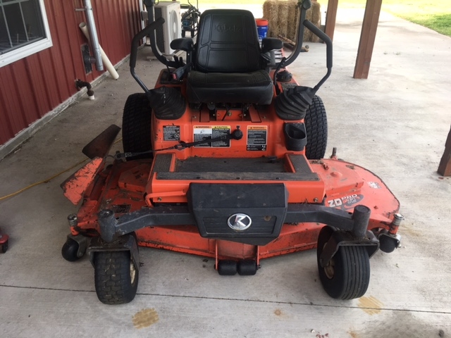

Dad's old ZD28 is running great but I had lots of down time for repairs and one super hot dusty August day last year I had to stop mowing 3 times because the high heat alarm went off. Each time I had to run back to the barn and clean out the filters with compressed air.

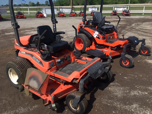

I ran the ZD28 one last time 735-736 hours and loaded it on the trailer to trade with it at the dealer. Before I did I set up 3 test runs- 3 patches of grass ranged from ankle to knee high grass. - 3" blade height and enough speed the ZD28 would bog down and I was forced to slow.
Two hours after I unloaded the 1211 I knew I had a winner. In each of my test cuts the ZD1211 was superior to the ZD28. It obviously had more cutting power than the old 28 and a much improved ride. I did notice that if you have uneven ground the large 72inch cut will scrape on occasion but for me if you have large areas to cut a little scalping is a small price to pay.

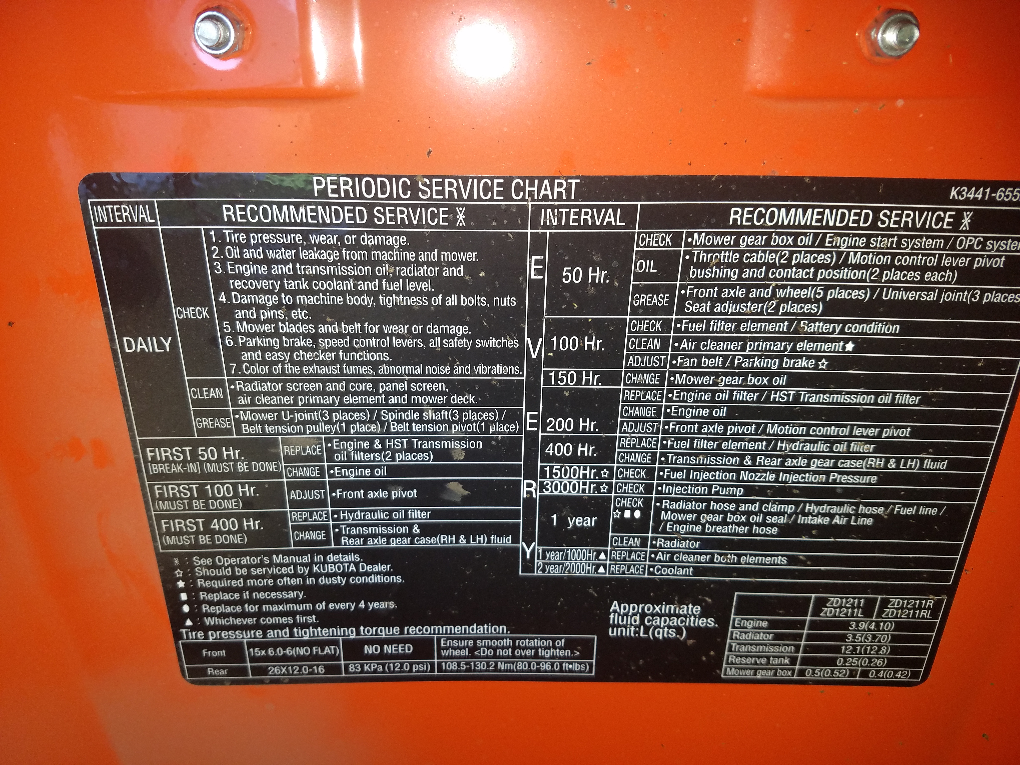

Thanks Dave, a couple of questions for you:
How long are your blades lasting?
How many hours do you have on your 1211?
How's it running now?
How often do you grease it? The manual didn't say much about it.
Any problems with dust or over heating ?
Thanks

Ive got a whole season 50 hours so far on the mower. Blades have little wear sharpened them once last year. Manual has a pretty good table on when to grease what. Maintenance schedule is also under the hood very specific on what to do daily , etc. Realize that daily is a commercial machine so i only do most of this once a tank of fuel.

Thanks Dave - I found it under the hood. Your right it was clearly stated. The way the chart reads you are to grease the unit every 50 hours - that seems like a long time - I think I am going to shorten that to every 10 hours.

No problem it says to grease the spindles and pto daily which i stretch out to once per tank of fuel. All the rest are 50 hours most of these are low speed and low displacement I would not worry about shortening the cycle most mowers dont have anywhere near the 30 zirc fittings the zd's do.

One thing I would like to know is, it doesn't look like our blade spindles are sealed. Is thay accurate? It's a breath of fresh air if this is the case. I greased mine for the first time and got about 15 pumps o. Each before I felt some resistance. Upon changing the blades a couple times, I see you can see right up into the spindle and see grease, so is that where the grease is going? Or is the spindle inside that caked grease?

Good question - I put 30 pumps into each without feeling any feedback yesterday. How do you know when enough is enough?
