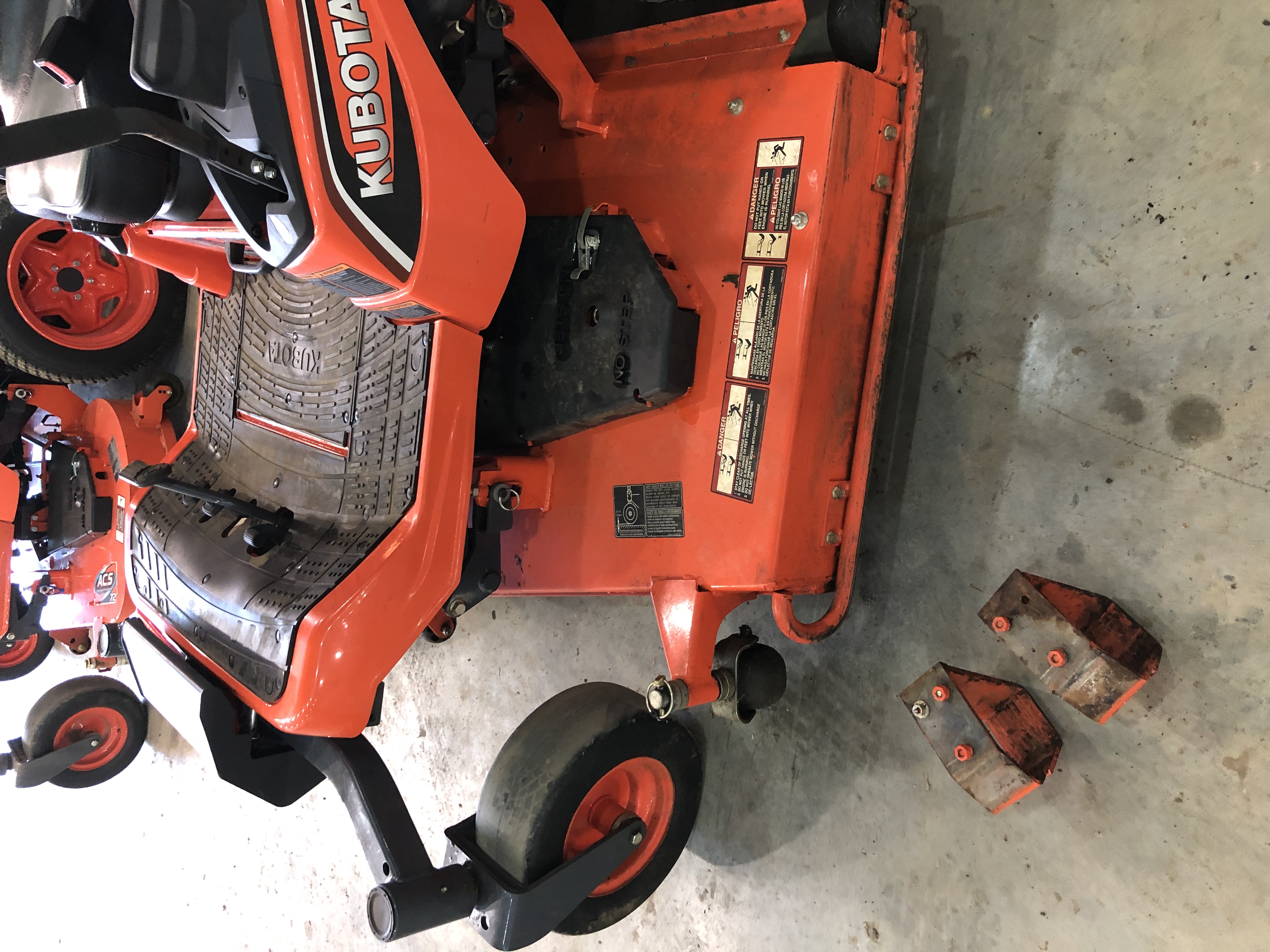

While removing the two rear skids from under deck to help wind rowing in heavy grass :
I discovered the REAR baffles at backs of blades is why I get 3 windows. They direct the clippings to one side as their sprayed out :thumbdown:
I removed deck, supported it by chains from my Front End Loader & simply unbolted them.
The bolts holding them on wasn’t painted orange like the rest of the bolts on deck.
So it’s been bolted on after assembled.
I haven’t mowed with it yet.

Here is the skids I removed from under rear of deck

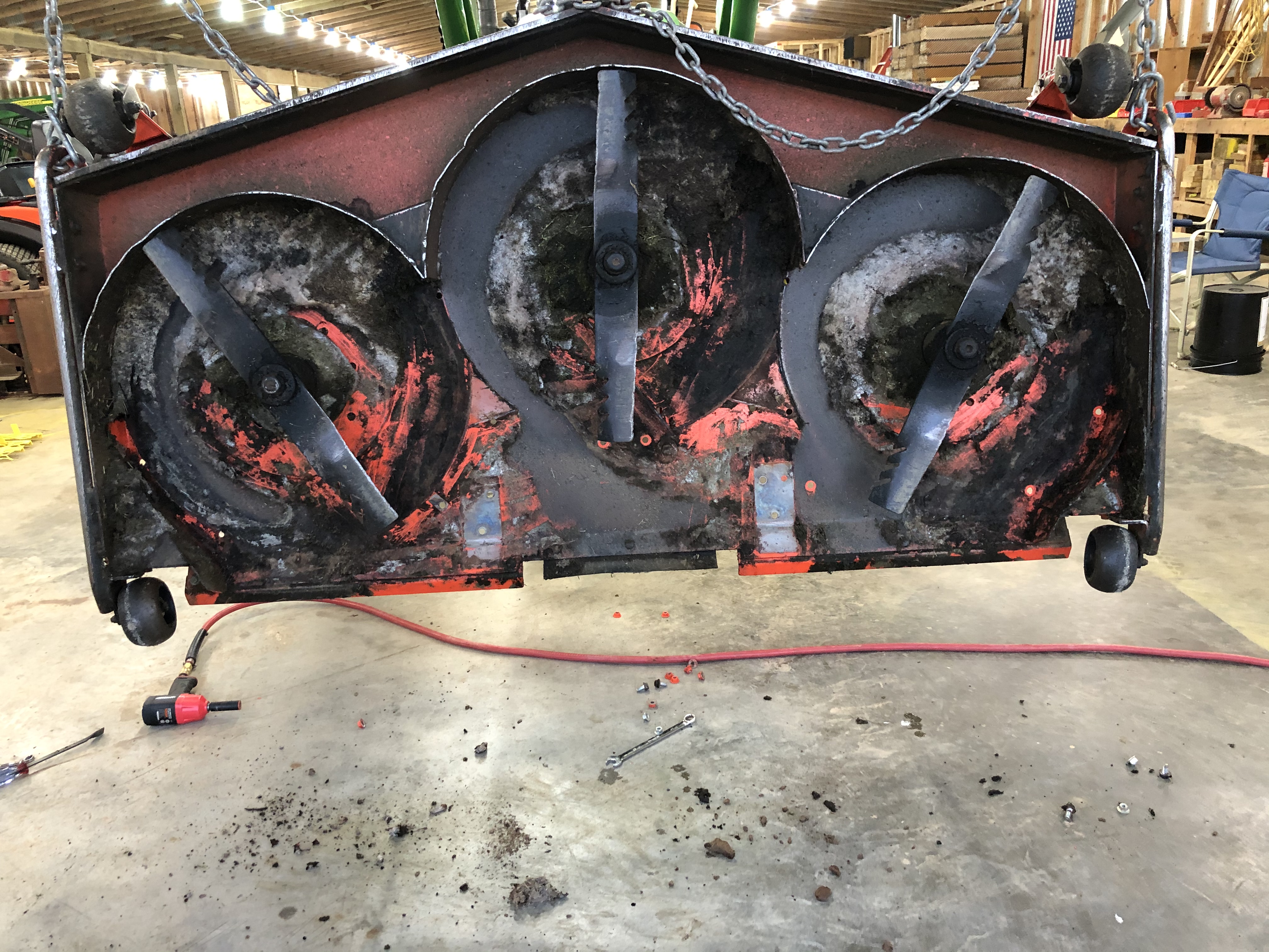

Here is the 72” RD Deck with the baffles in place.
Hard to see them between blades & curved down towards rear of deck

This is the deck after the deflector baffles were removed.

Well I mowed some knee hi thick grass around the edge of hayfield.
The clippings was super thick & lot more evenly spread out without the baffles. :thumbsup:
The clippings were about 4ft wide I’d guess.
No more Three 12” wide windrows of clippings :thumbsup:

Guess you know knee high is not the average for most people mowing.:laughing: I would expect even distribution of cut grass with no baffles but cut quality with 4" to 6" high grass would be the better test for me to know the results.
