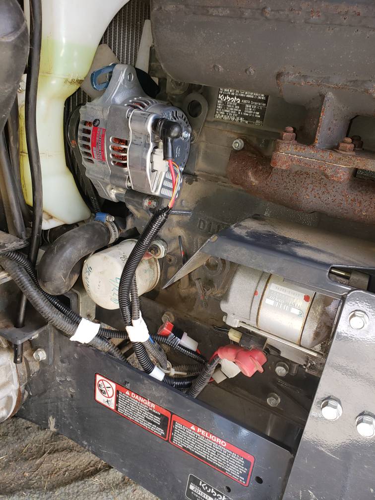

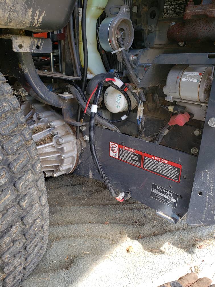

I Wanted to be able to power a sprayer the stock generator is small so bought the 40 amp kit for a B series and put it on my ZD1211
The supplied belt is not required must be necessary for a different variant
Purchased from Coleman equipment,
40 AMP HIGH CAPACITY ALTERNATOR KIT
Item #B7311
Each: $209.66

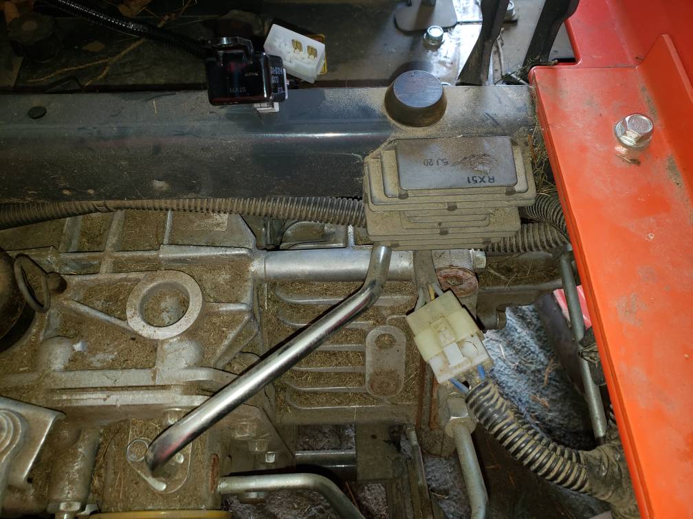

The rectifier gets removed the new harness plugs in and the new relay gets bolted to the frame.

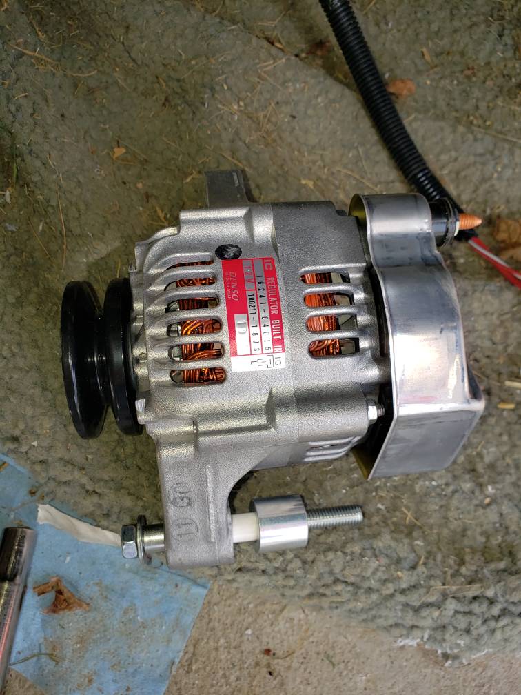

I put the Bushing on the bolt and wrapped tape around the bolt to hold the alternator bushing on place and also center the spacer on the bolt. It was either this or i would have to drill out the housing on the engine to accommodate the larger bolt all Bushings and spacers are included 20200416_142713.jpeg20200416_140345.jpeg20200416_152033.jpeg20200416_145128.jpeg
