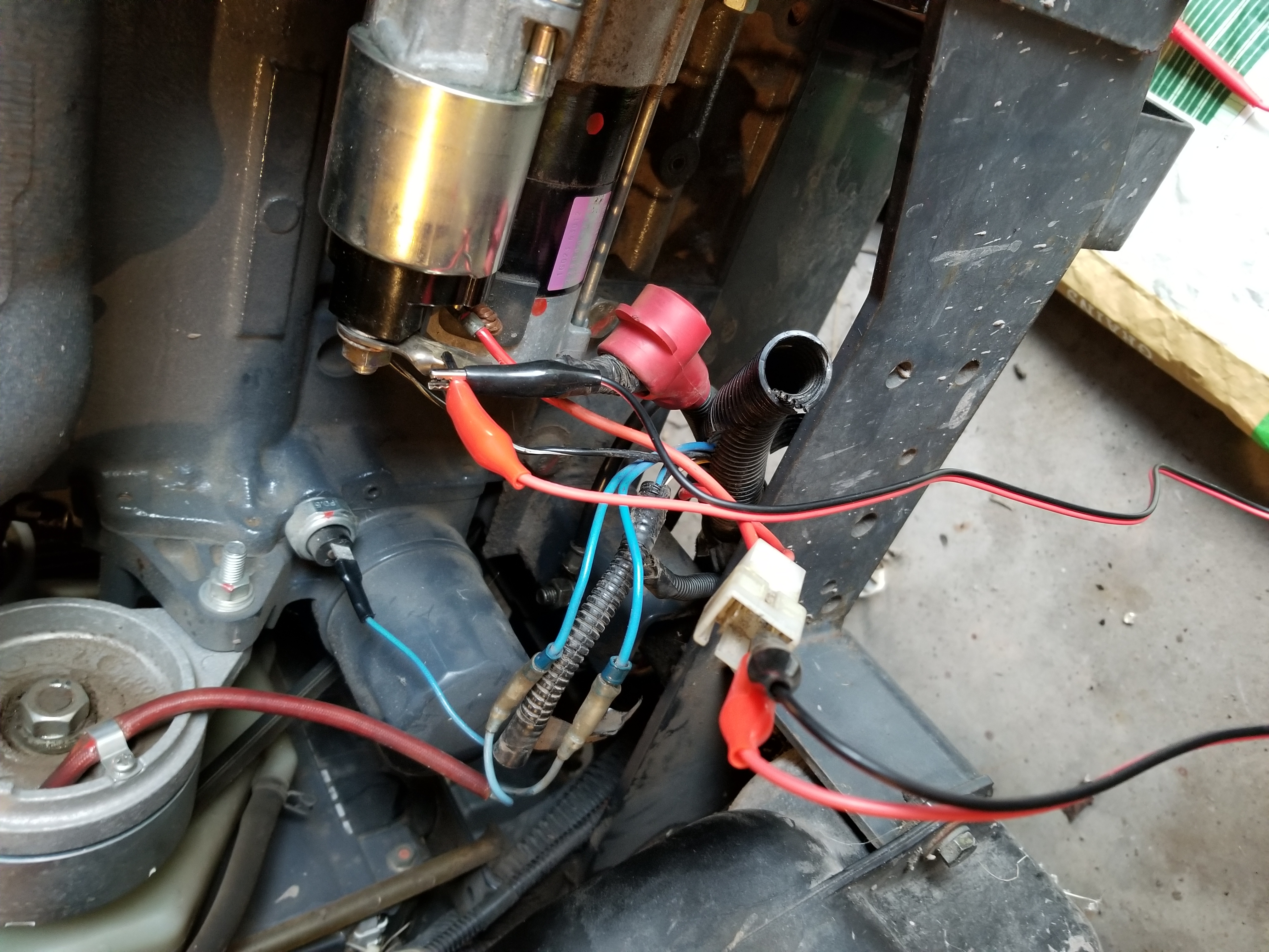

I have a similar problem where the Kubota ZD21 is electrically dead. I've checked continuity on pretty much every wire there is on this thing and everything appears good. It is just you when turn the ignition over there is zero life in the mower. Also I have bypassed all of the safety switches and the battery is at 12.6 volts or so.
I hoping there is a brain that can explain what I found out today. If I hook up positive from the battery (or the main post that goes into the solenoid) and connect it to the "out" on the slow blow fuse the indicator lights turn on and you hear fuel pump click on.
I bought a new starter solenoid thinking that might be the problem but its still dead. Does the fat red wire that goes into the solenoid also run into the slow blow fuse? And if so, is there something wrong with the solenoid that isn't connecting to the rest of the mower?
   / zd 21 no power to main fuse, therefore no power to ignition #10
You were told on the "ORANGE" forum you have the RED wire on the wrong terminal on the starter solenoid.
It should be on the same terminal that the battery cable is on.
