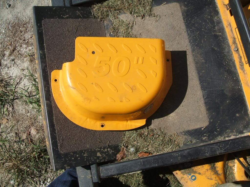

I had a lot of trouble with grass clippings and small sticks accumulating under the outer deck belt guards when we first got ours. It would pack up under there and rub the belt in just one cutting. I wouldn't recommend this to anyone who cuts with children around or lets children use the mower but I removed the guards and left them off. I had to make a bracket to hold the pto belt tension rod but I've never had any problems with accumulation since and it's so much easier to clean the top of the deck.
OldMachinist I would like to see a picture of that bracket ...thanks. Sounds like an excellent idea...no problems or caveats running it that way?
Right now I feel I pull as much maintenance on that deck as I would with an airplane.
Actually a bracket is just a bracket guess I don't need a picture. How many hours have you run it that way?
   / Z Force belt smoking- #7
I took the guards off when mower had about 75 hours on it. I now have 368 hours and have had no problems running it this way.

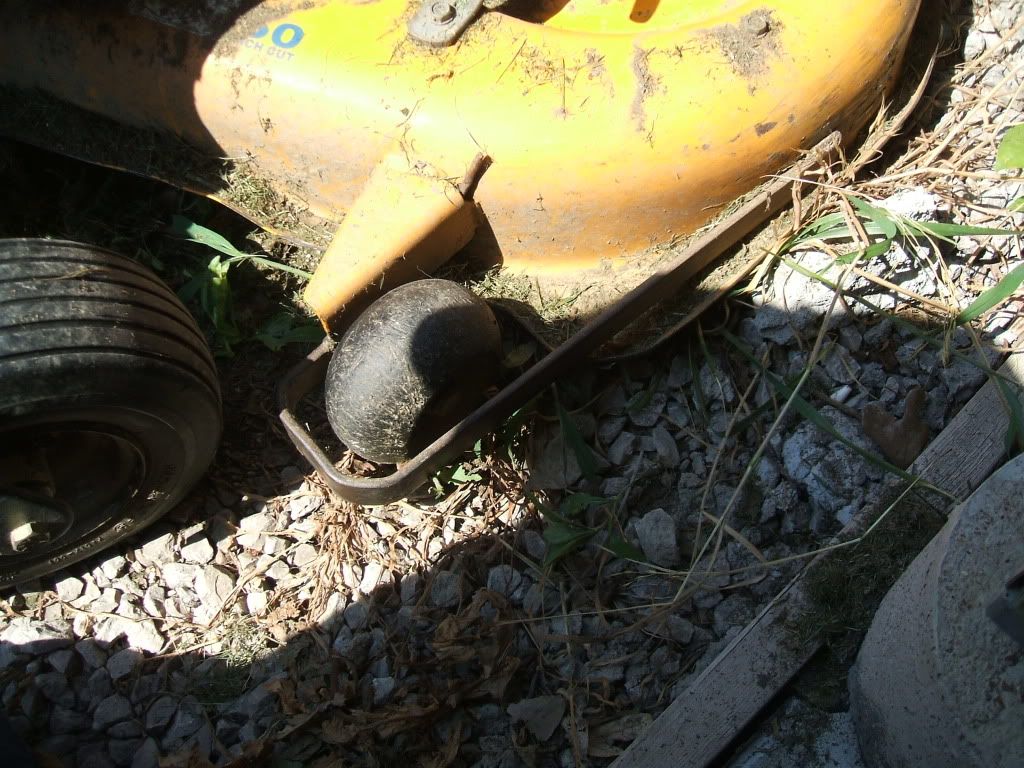

I also had problems with the guide wheel on the left side snagging on things and bending the bolt so I took some of the same metal strap and made a guard for it.
   / Z Force belt smoking- #8
Oh that's sweet, thank you for answering all my questions...I'm gonna do exactly what you did.
We require a very close cut so I took all my gauge wheels off, trimmed off some of excess wheel hangers...and cobbled this float device...I love the way it cuts now.

Well here's my pulley cover modification.
Got a black Stanley 'D' handle from Lowes bent it some to increase elevation and attached it to the deck in the original pulley cover holes.
Before attaching I painted it with some Rust-Oleum...next time I'm at the dealers I'll pick up some CC yellow to blend it in better.
It sure is way easier to clean now...grass will promote rust so this makes it removing it simpler.
Thanks again OldMachinist for sharing this simple solution.

I feel the same about the covers. They just promote grass build up and rust. The first thing we do with our dirt bikes is remove the counter shaft sprocket cover because all it does is trap mud in that area. Same idea. Although my deck covers have holes in them for greasing.
Will see what is under my covers and decide then. But I blow it out after mowing with a leaf blower and when I do wash it I spray that area until no grass comes out(then run the mower to dry the area out).
