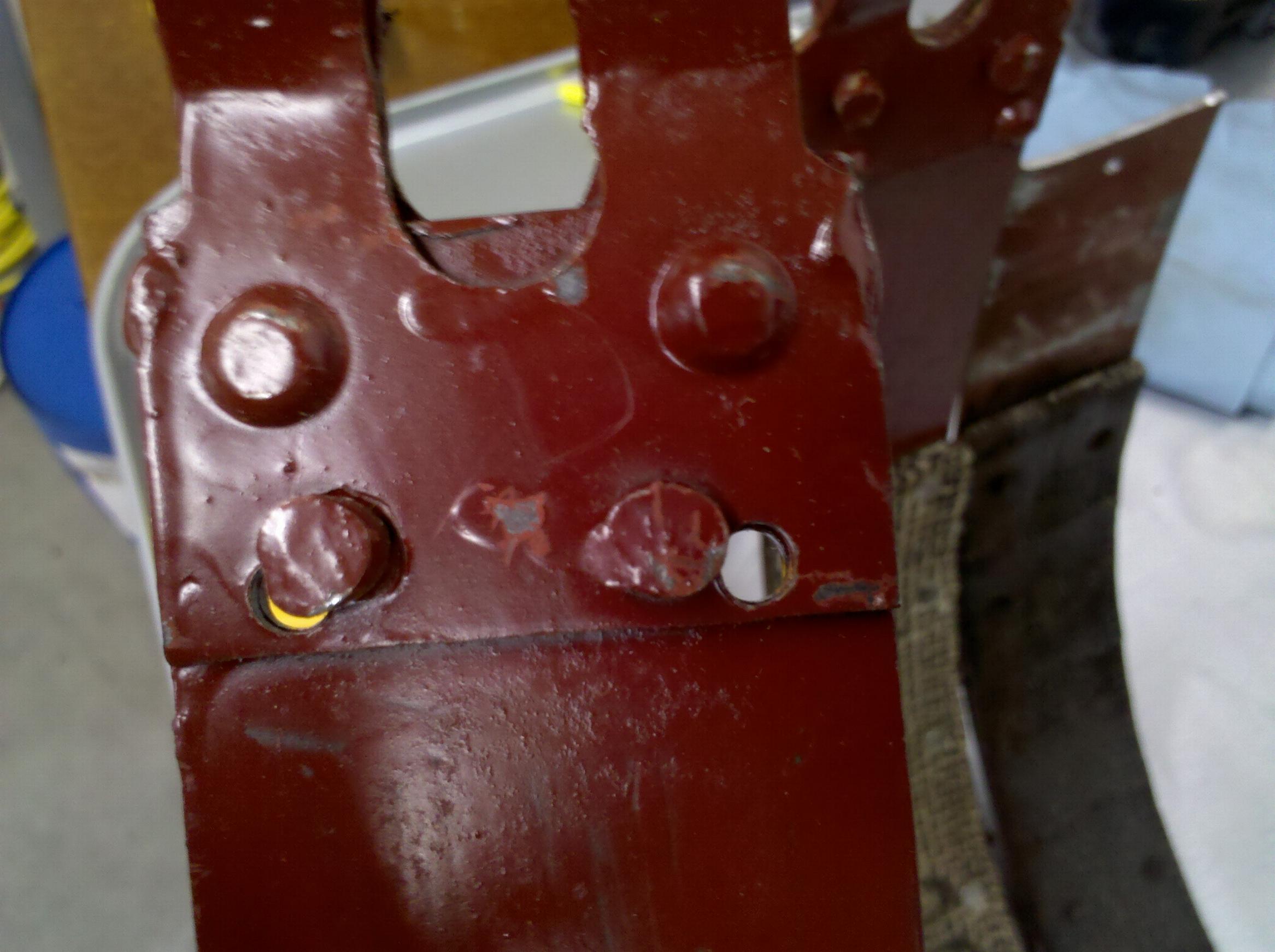

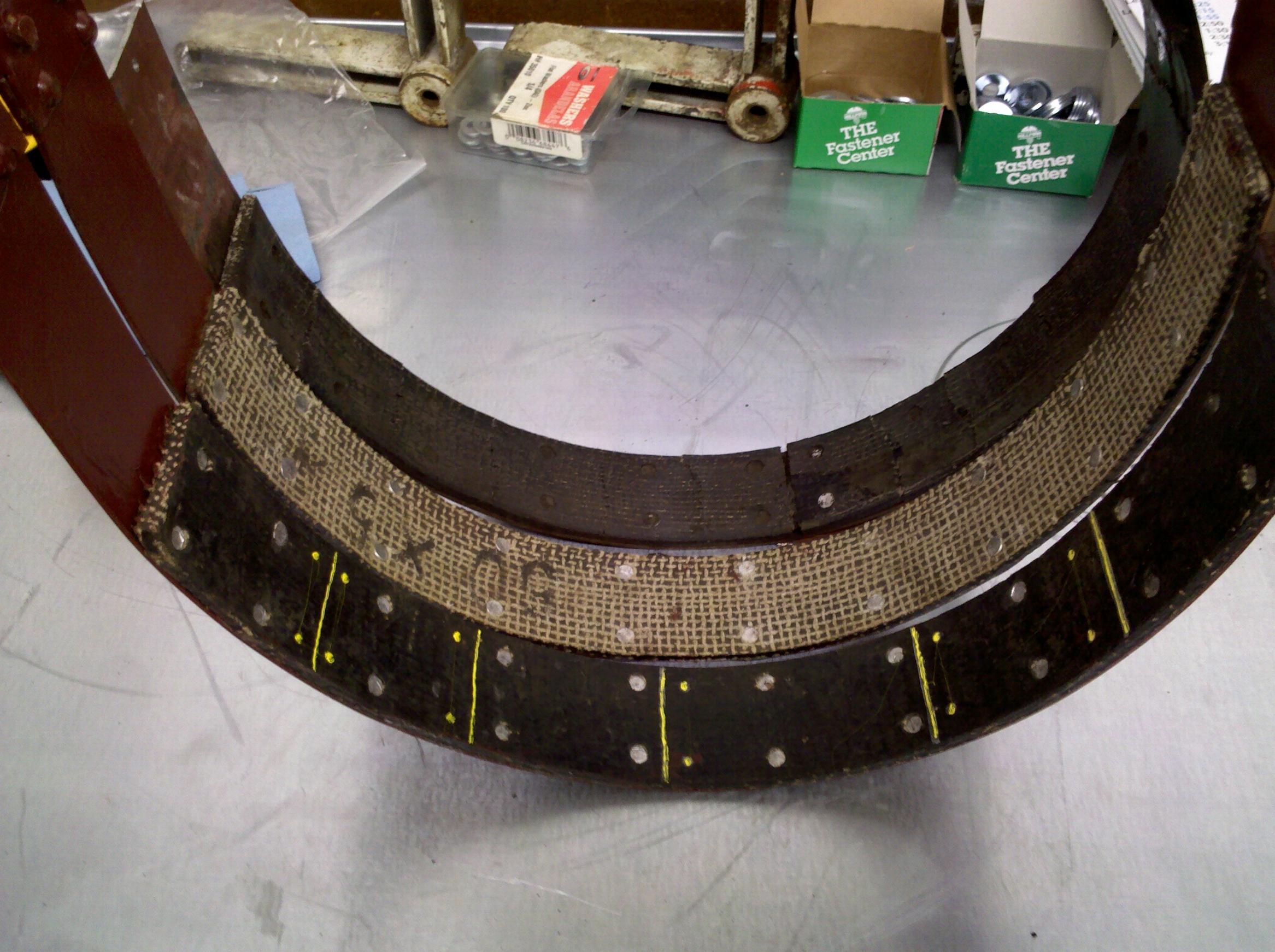

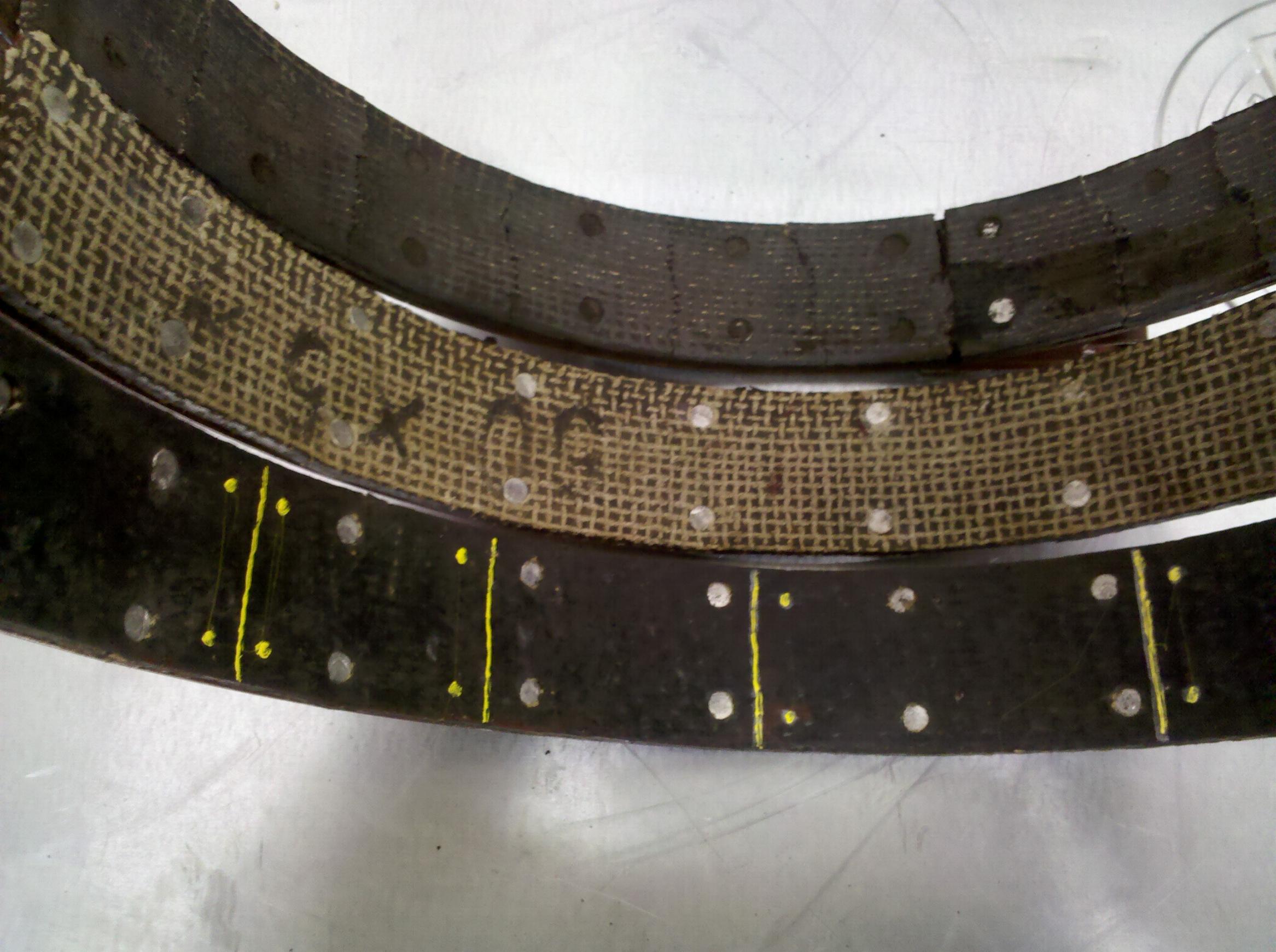

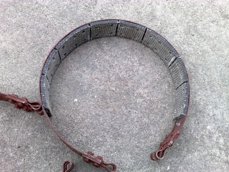

Steering clutch brake bands, and my postulation for modifying the existing lining (including replacing the aluminum rivets with brass), or completely relining with segments from new friction material instead of the "fire hose" type OEM lining.
The light colored band has the worst rivet job I've ever seen some rivets are not even countersunk. The dark colored band is the second worse job some rivets have separated and bulged the lining. Even the end clip is randomly riveted (which is not really a concern).

Hi Bob,
Good suggestion, and not a bad idea. There are obvious benefits to running wet steering clutches, but in this case there are a few issues that need to be addressed. Here's my take on it.
Sealing the compartment to prevent cross contamination of oils in the transmission and final drive compartments.
1) The lip seals as installed are to keep oils IN their respective compartments, not to keep other oils out. You would have to devise a double-opposing lip seal to prevent cross contamination and dilution of the other oils. Such a seal may already be available but size may be a hurdle.
2) The clutch discs are sintered bronze, and would have no problem running wet. They are virtually the same as found in Paragon and Borg Warner marine and fork lift transmissions.
3) Brake bands. Here lies a real challenge, but doable in my opinion. The bands would need a segmented sintered bronze arced lining equivalent in thickness to the friction material, and about one-and-a-half to two inches long. They cannot be riveted - must be bonded, so I don't see this as a DYI process (at least not for me). Back in the day Cat and others used wet clutches quite well for a long time.

Thanks Bob for your reply. I have been looking around for bonding prices. They are quite expensive but doable. I won't be tearing down again until this winter. I considered doing "same fluid" on both sides but haven't ran that thought all the way through yet.
Will see how it goes.
   / Yuchai steering clutch brake bands
Same oils will not work. The transmission/bevel gear case uses SAE 80W-90 gear oil (anything heavier will be difficult shifting). The final drives use SAE 140 or SAE 240 gear oil. The sintered bronze components will not work satisfactory, if at all, with those lubricants. Too viscous.

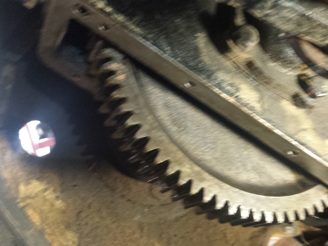

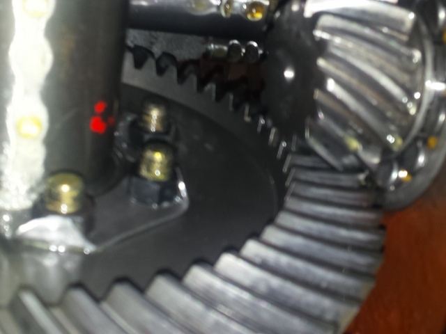

Thanks Bob. Speaking of shifting I am going to say this about the regular transmissions in the dozers. I assume they are the same ones as in the 30 hp Jinma tractor. I like those tractors and have one, sold a few. One nightmare problem I have seen twice. Shifter fork breaks. Falls into gears. If you do not stop IMMEDIATELY gear teeth break off. This requires a break down of complete transmission AND rear end. On a dozer this will be a night mare. So if you ever feel this happen STOP IMMEDIATELY AND TAKE TOP PLATE OFF.

I had the shift cover off, opened up the bevel gear case and final drives when I did a 800 hour inspection. All looked pretty good.

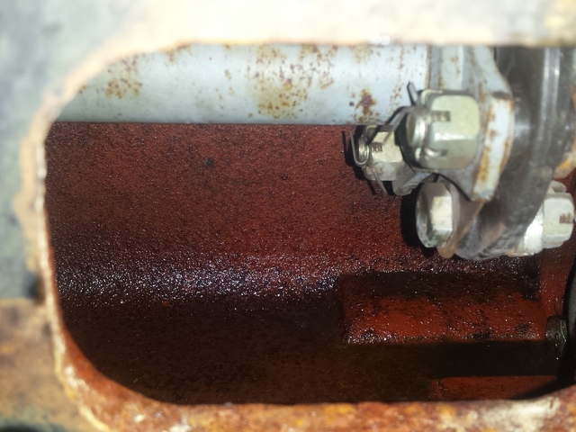

Bob I got my Dozer out and tried to use it after removing the Marvel Mystery Oil from the one steering clutch since it had freed up. Only pushing some small brush stuff up. I noticed after a while I was getting slippage or no power. I can't say it is not the main clutch but the sound and feel makes me wonder if both the steering clutches might be slipping at once. The one I soaked might have reason to but not sure about the other. I don't look forward to putting the main clutch in it. Any thoughts?
#14
Did you remove the drain plugs from both steering clutch compartments? Also the drain from the main clutch (flywheel housing)?
   / Yuchai steering clutch brake bands #15
Did not. Should not be anything in the right one but who knows.... Thanks. The slippage is a rough one like gears almost mating not a quiet slip of a clutch.
#16
Could be a leaking seal in the right compartment, letting final drive or transmission oils in, just a thought. The "rough slippage" sound sounds like main clutch chatter - possibly the disc is down to the rivets. Have you tried adjusting the main clutch?
