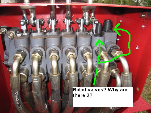

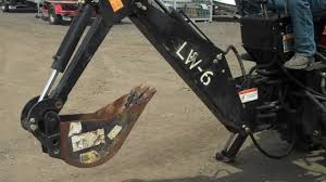

The bh is the LW 6 model.
It has a pto pump driving it, it's own reservoir.
And (lightbulbs go off!!!) here's a picture of (tada...)
the control valves including the elusive PRESSURE RELIEF VALVE!!
Thank you for the guidance, these "user affinity groups" are of GREAT VALUE,
and "value" comes from willingness to help others.
In my search for images to illustrate the answer to your questions,
the first and primary question of "Where is the durn thing" became clear.
An example of the problem would be:
Presume the angle of the floor is not quite horizontal,
that you are on a slope, directly uphill from the place you are digging from.
You pick up a light bucket of sand, and sweep over to the left, to the limit of travel, to dump the sand.
As you begin to uncurl the bucket, the boom and arm of their own accord drift back "downhill",
I mean, that's a fairly insignificant load.
And when digging, if the bucket has a good load, you can't lift it.
And the sound of sibilant sssssssqueaking of fluid thru a valve is heard.
So?
Think it's a broken spring, or stuck valve, or?? What's next??
Thank you ..
   / Yuchai Dozer with Backhoe: backhoe hydraulic issue
So, what do i do?
Left to my own devices, I would disassemble the valve by removing the adjustment cap,
and see if the (presumed) seal has any blocking "junk",
or if the spring has broken, or whatever.
I'll endeavor to keep track of the "loading" on the relief valve,
but I can see this leading to the necessity of a pressure gauge for hydraulic systems,
one of which I am currently not possessing...
Any advice or should I just dive in?
(after I've got the steering linkage adjusted, which will take most of the day,I 'spect.)
   / Yuchai Dozer with Backhoe: backhoe hydraulic issue #7
I think the larger black "relief valve" on the inlet is the relief valve and the smaller one on the right most valve in the pic is for the extra spool travel for the boom's float position.
Thank you.
