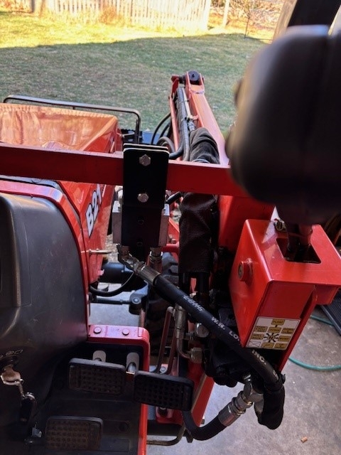

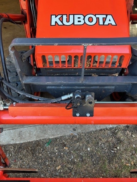

It is live and not a diverter type. It has a two-button switch that activates a dual-port cylinder. I installed it on my Kubota B21, and it works well.
