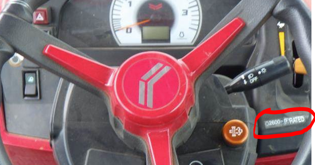

Hi about to get delivered a used yt235 question when I hook up my Brush hog to it - I do not think there is a marking for the 540 rpm- what should my tractor read to be sure i am running at 540 for the bush hog- thanks for the newbee help-
   / YT-235- what RPM is 540?? #2
Since it has a somewhat digital display, it may change to PTO mode once you turn the PTO On and then it will display the PTO RPM.
Just my guess since they didn't put a mark on the tachometer.
   / YT-235- what RPM is 540?? #3
I searched an image for what this model looks like. It looks like there is a decal on the dash. Does your tractor have this?
   / YT-235- what RPM is 540?? #4
wow did not see that will have to look- thks so much
   / YT-235- what RPM is 540?? #5
There is a Yanmar Owner's App that will calculate PTO speed. This will show 540 as well as other speeds if needed.
   / YT-235- what RPM is 540?? #6
thks there was a sticker that showed 2600@540-- thks
