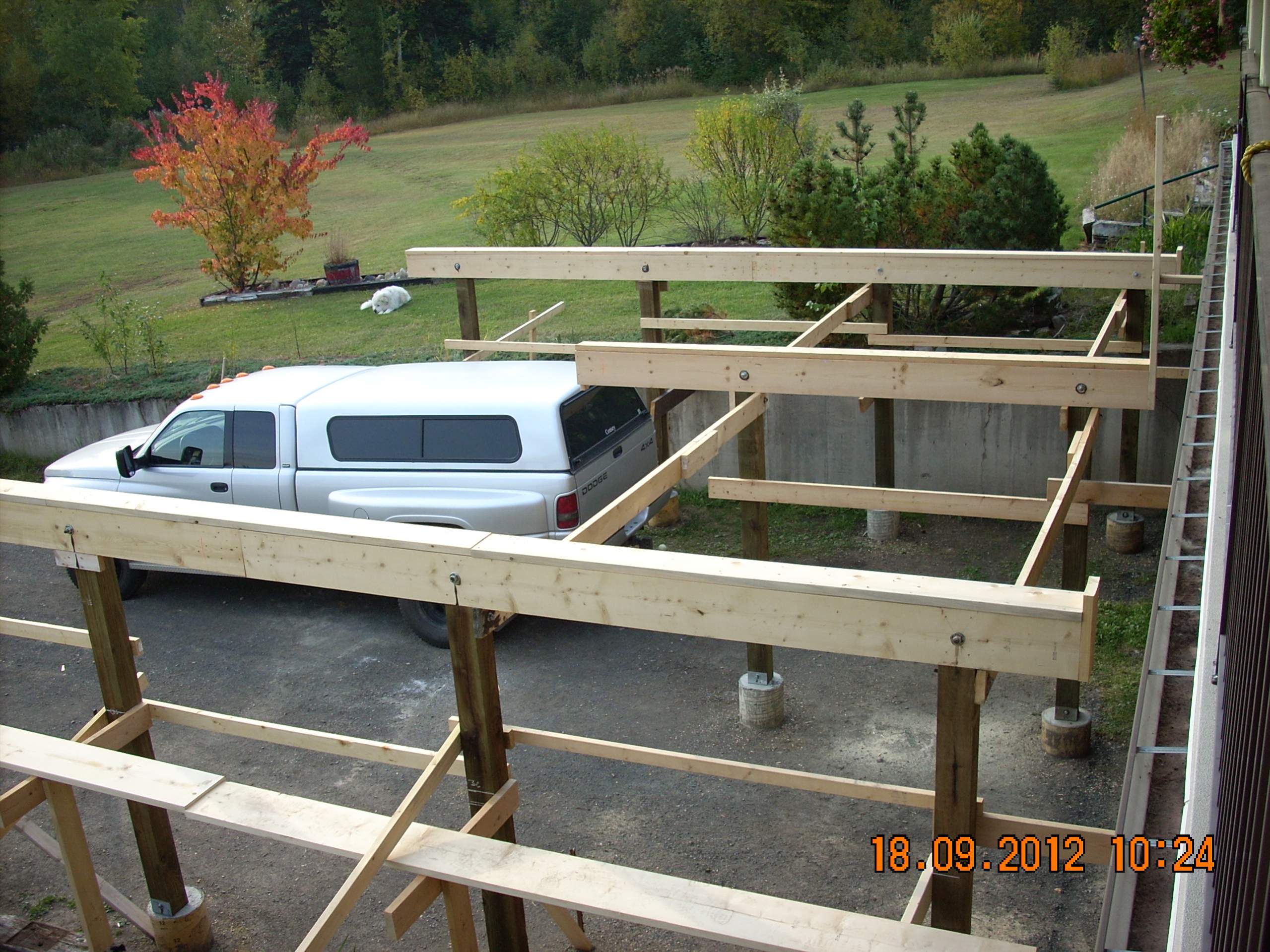

Can't help you with the build itself, but my research showed that wooden 6x6 treated posts do not last long when buried in the ground.
I built my 28x26 car port and used sona tubes full of concrete and 3 lengths of 5/8" rebar to put the posts on. I built with the concrete sticking about 16" out of the ground - where the 6x6 posts bolted on. Your part of the country may be different, but up here in Canada, it isn't unusual to see the post bases above ground (very common).
HTH
