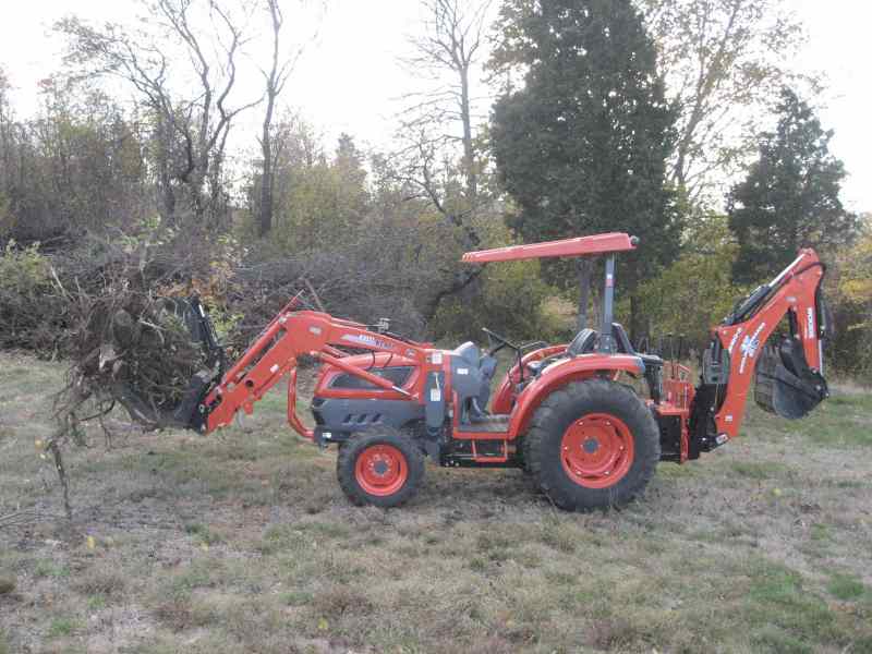

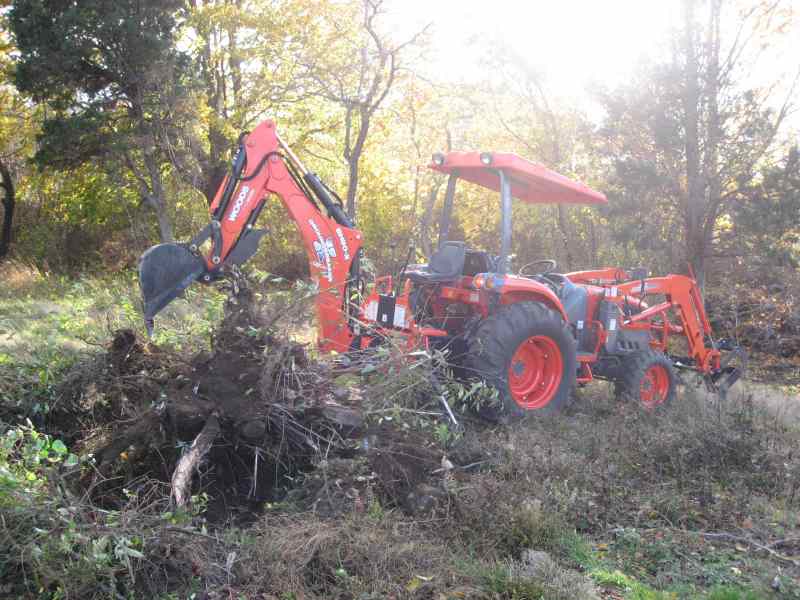

10 acres of 8 inch stumps could be a LOT of work. I would do a careful assessment of the number and size of stumps as well as consider what time period you want to accomplish this work. I agree with comments that you need to balance the cost of buying a backhoe versus renting a larger excavator or having a professional excavator do the work. I would imagine that if you are really dealing with hundreds of stumps (and there could be many hundreds in 10 acres), then rental of an excavator might be pretty pricy especially if you are a novice and would not be terribly efficient at using it for the first several days at least. On the other hand, trying to dig out 200 plus stumps with any CUT/BH would be quite a challenge.
I use a Woods BH90x on my DK40 to dig stumps. I have only a 18 inch bucket at this point which is not ideal but I am also digging in fairly soft sandy soil with moderate number of rocks. Including moving the tractor, setting up, digging and backfilling the hole with the spoil, I'd guess it takes me 15-20 minutes per stump. A CUT with BH is just not strong enough to simply rip out a 8 inch stump the way an excavator could. The issue is ripping up the lateral roots so you can yank the stump out. An appropriately sized excavator allows you to clamp onto the stump and just tears the thing out with brute force. With my BH I need to dig to get at the lateral roots then rip them with the bucket. That means I need to dig often on all four sides of the stump which means a fair amount of digging to find the roots and moving the BH at least once. I plan to get a ripper tooth to use instead of the bucket specifically for stump removal...haven't done it yet but a ripper tooth plus thumb should be quicker as I won't need to dig to get at the lateral roots. Even with a ripper tooth I'd guess it will take 10 minutes at least per stump and that is being optomistic. Bottom line is that you'll be lucky to get 3-4 stumps per hour with a CUT+BH. I'd guess that with an expert operator and a medium size excavator the number might be up to 10 times that many stumps per hour.
If I were in your shoes, I'd get an estimate for professional excavator removal of the 10 acres of stumps before doing anything else. It might only take a couple of days with the right equipment and operator so the cost could well be much less than buying a BH or even trying to rent an excavator yourself.
Once you have the stumps out then the removal of the stumps to a pile is easily accomplished with a grapple. A grapple would also make general clean up of slash etc much faster.
