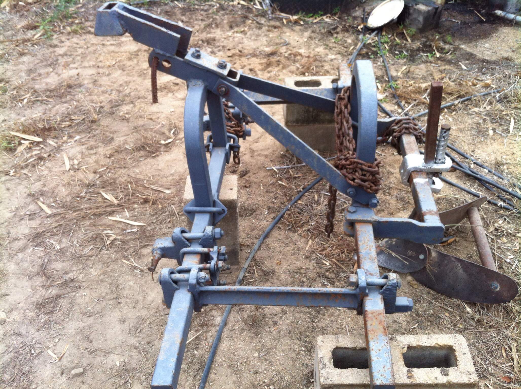

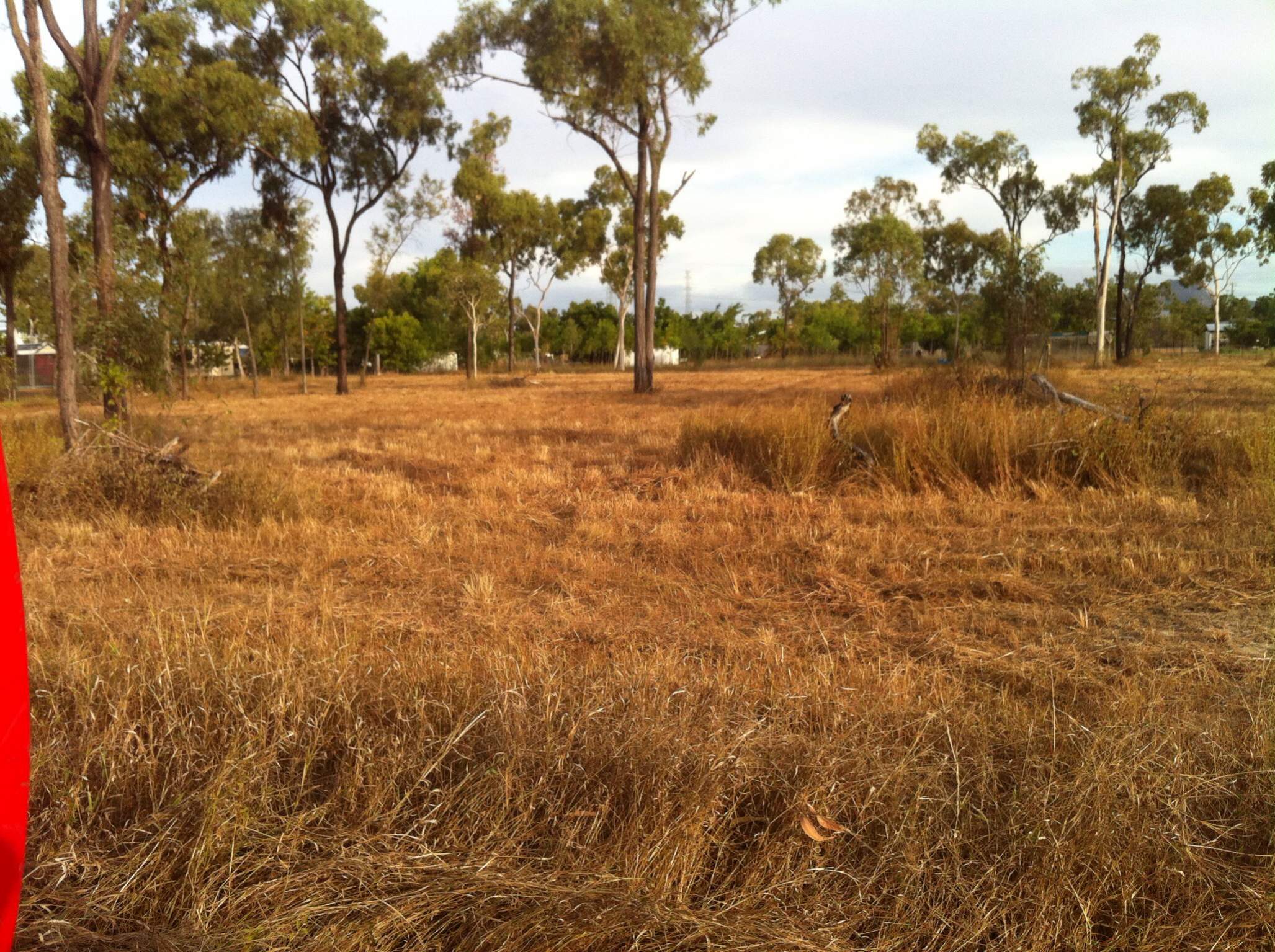

First the job.
Soil improvement, time frame two years at most.
I intend to build a house on a 2 acre bush block here in the dry tropics of Australia.
The block is flat with only a few large trees that are native and a couple of hundred mahogany trees I put in over the last few years.
The soil is decomposed mangrove mud, a heavy white clay with little or no nutrient value.
Soft as grease when wet and too hard to dig with a PTO post hole digger when dry.
I think I need to break the surface and get some fertiliser in then seed heavily with legumes and green manure crops.
My tractor is a 25hp Chinese 4x4
I have a tool bar a single tine ripper and a bush hog mower.
Would a 4 foot box blade be good to break the surface and get in fertiliser then seed? Here they cost about US$900.
Or what would you suggest

A box blade is not an ideal tool for tilling soil. You can tilt it forward and just use the rippers. Unless you're moving dirt the accumulation action of the blade is not helpful when tilling. It may be helpful in maintaining your driveway.
If you can add several rippers to your tool bar it will till at least as well as a box blade.
A disk harrow would probably do what you want.

By a disk Harrow do you mean the picture attached?
I have looked online trying to find ripper tines to suit but their seems to be many kinds. Curved, spring loaded and straight all with different ways of connecting to the tool bars, mine seems to an odd size 2 inch square solid bar.
