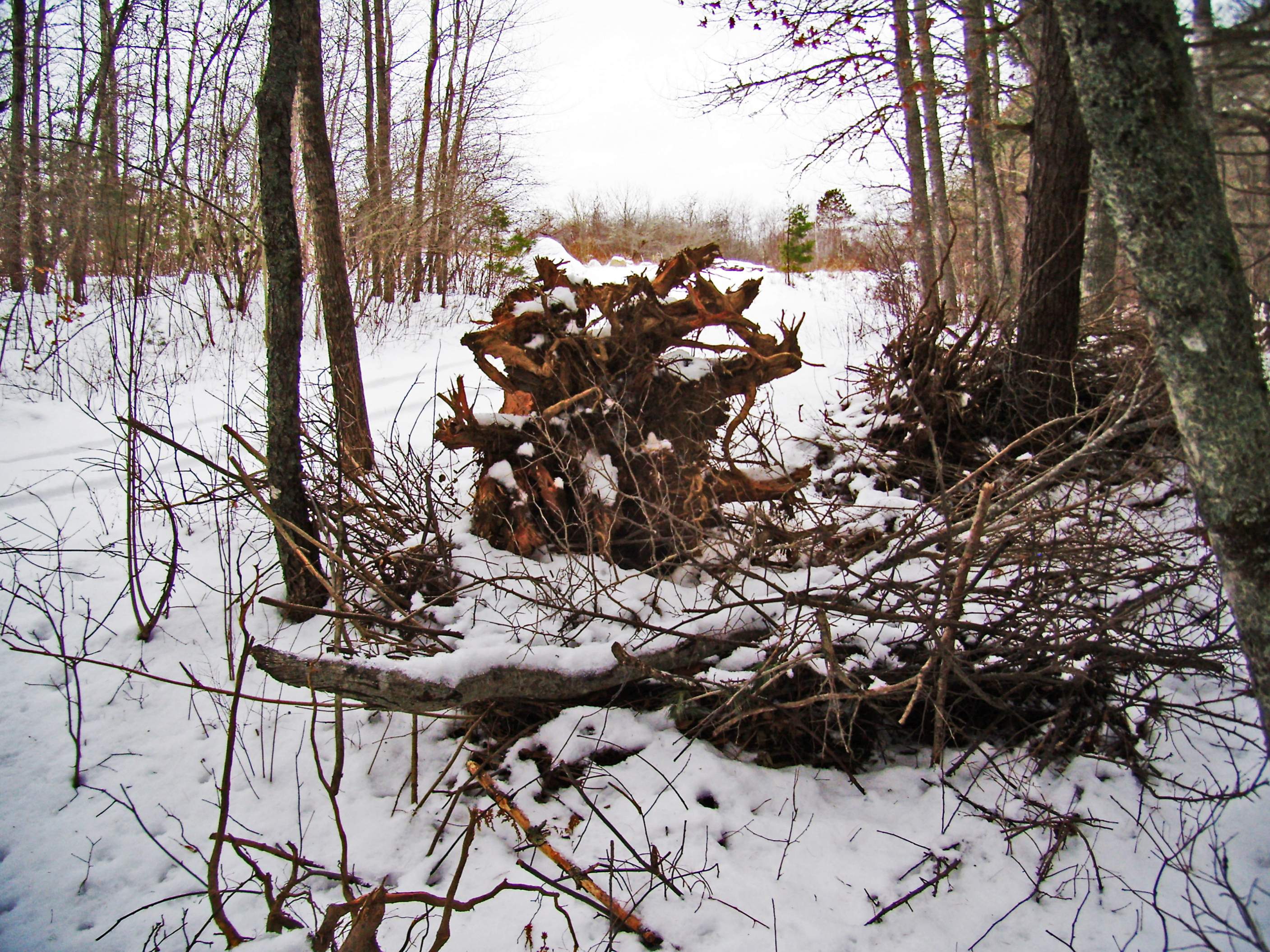

For information I have used my John Deere 4200 with the #47 hoe for digging a few stumps. I'm far from competent as an operator but the stumps did get removed. Digging was in clay with slate and granite rocks of various size. Depth was usually three feet before the stump could be removed. It would take me 1/2 to 3/4 of an hour per stump. A skilled operator would have taken much less time.:D
A picture of a removed stump.:laughing:
