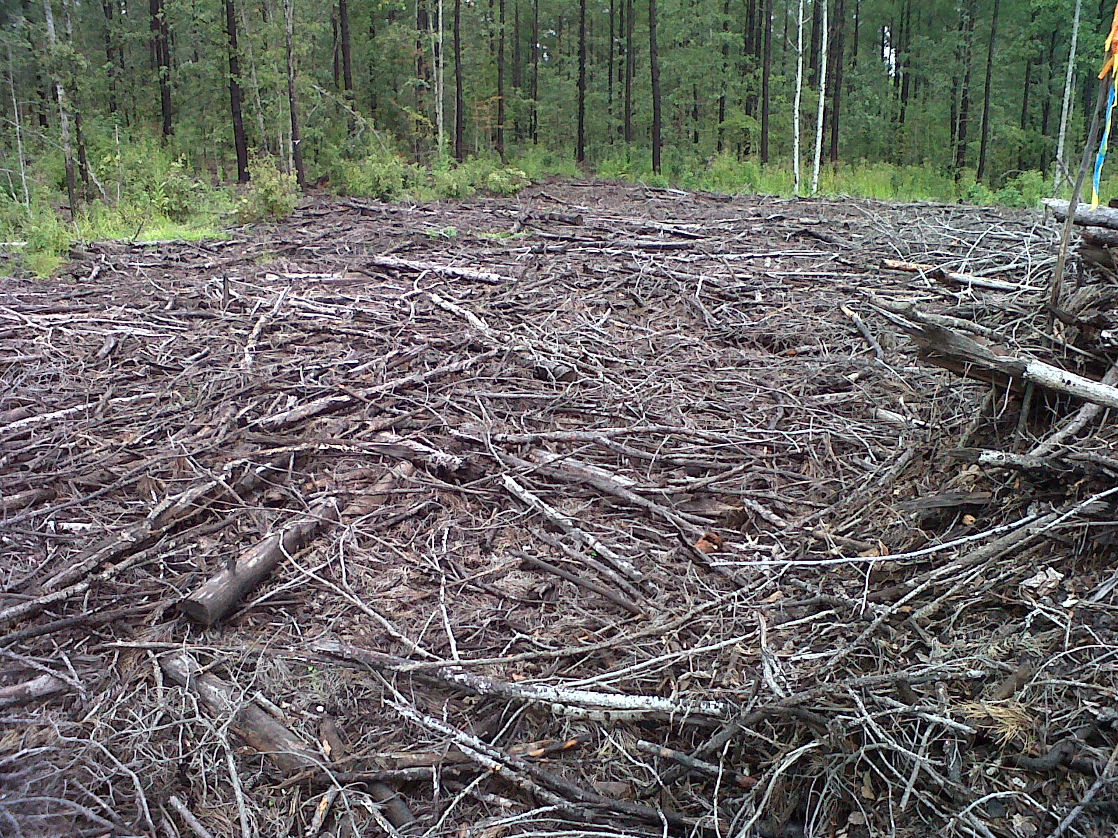

GOOD POINT! The wife was just giving me grief about going to get look at this rake because I can fix the driveway with hand tools (I just did) and it is not a high enough priority...
But I don't think I should rake this... [see pic] and that is what is kicking my fanny on the clearing job...

If you have ever experienced raking leaves in the fall with a plastic hand rake
you can imagine what you would be dooing most of the time trying to rake the stuff in your picture and how many broken tines you would have.
I have a heavy duty Woods rake that I use on driveway gravel to loosen it up and level it after a few months use. I usually have broken tines near the ends each time as they catch in the clay soil along the edge of the driveway/lane and bend or break.
I would suggest painting the tine red so you might find them when they break off. Another help would be to bolt a couple pieces of steel up a few inches from the bottom of the tines across them to tie them together for support from each other. Set the draft light and keep the tines a couple inches off the ground. If you rake going forward you are going to jam sticks/limbs between the rake and the tires of the tractor.
For the job you picture, I would think a grader blade turned backwards and pushing in reverse would be a better solution.

No way you can rake that mess - what 3-4" branches 4-8' long? I would take your grapple and or FEL bucket to get this into a pile. Once you get the big stuff the york rake will do a great job with stuff thats 1-3" in dia and a rocks and such.
When i cleared about 2 acres after stumping there was a lot of rocks, 1000s of dead pine stubs 1-3" around and root debris. I would lower the FEL and push the bigger stuff while lowering the york rake to get the rest.
Took multiple passes - i raked into a swath 20-40' long then used the FEL to push into a pile. I left that pile sit about a year to decompose.
Or you can wait for the mulcher and have them mulch the whole mess?
Thanks to both of you.
The wife is resistant (and she is right, I need to be smart about how cash gets spent and we've got SOOOO MANY projects...)
David
Looking at your picture of the debris field it appears as if you have a war going on.:D I think the grapple to gather this stuff up in wndrows is a good idea. I would sprinkle the windrows liberally with 39-0-0 fertilizer to help speed up the breakdown getting it to decompose faster. You could also leave it where it is and spread the fertilizer too, as contact with the ground will help it rot faster. As long as you can run a brush hog over the top without hitting the debris this would be the cheaper easy way to deal with this. It will take alot longer to get rid of this stuff if you pile it up.
