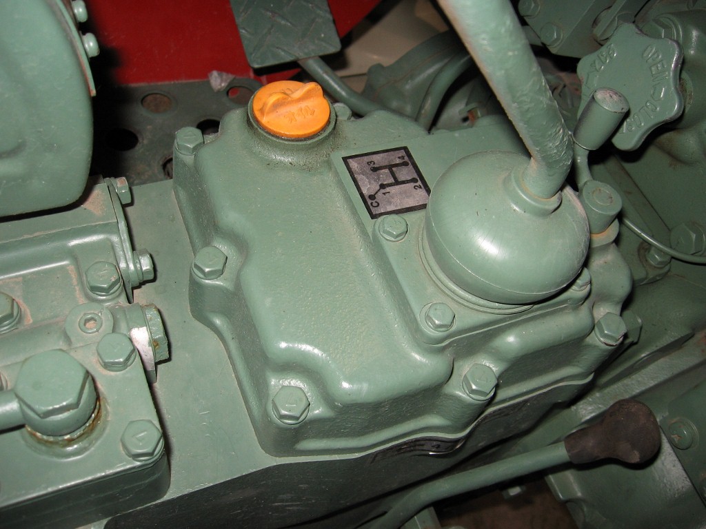

Being my first tractor, and one which needs some extensive work, I have quite a few questions I could use some help answering, especially as I don't have an owner's manual.
Please take a minute and watch this video and provide any input you can. Thanks a bunch!

The 1st pedal is the differential lock. When you mash that both rear wheels are locked together. Only used when needed. I believe the little lever at the back of the gear shift is a lock used in conjunction with the creep gear. The little rod that goes in the clutch arm is the inertia brake arm. There is an adjustment procedure for it. I do not have a manual for the 336 so I am unsure about your adjustment. My manual is for a 226 so likely not the same as yours. I have no clue about your wires, maybe someone can post a wiring diagram on the 336. I have been following your posts about this tractor. The shearing or breaking of those bolts is very mysterious to me and I imagine others. I can't imagine what could have happened to cause this. With everything you have opened up is that the only damage you have seen? Best of luck to you. :thumbsup: If any of you guys have trouble with the video as I did you can go to google and type in "video ym336d" and pick it up.

Thanks a bunch for the info. I was wondering if mine had a diff lock. Glad it does. I'll be sure to fiddle that creeper lock when I get it running again. I'll also check the service manual right now for directions on adjusting the inertial brake arm. Hopefully it isn't an owner's manual item.

The adjustment procedure for the inertia brake is in the clutch section in my 226 manual. Have you looked in the clutch section of your service manual? That should be there. Clutch pedal needs to be adjusted first if needed, then the inertia brake. Power shift brake release is the same thing, different terminology.

The front wheels appear to be in the reversed position maybe not a huge problem on a tractor w/o a loader but just a heads up you may want to flip them side to side later on. :thumbsup:
Here is a picture of my ym3810D shift decal showing the creep gear lockout we have similar tractors the 3110D is a sister also fwtw.
The creep gear is actuated when you move into first gear in main box and then move the little creep gear lever and you then can move the gearshift one more spot forward of first gear.
CAUTION wait till its running and you can drive it before attempting to operate this creep gear! My experience is it can be a bugger to get back out and I have had to move forward and reverse with the powershift to get mine back out of creep so use now at your own risk!
The rod and lever you are pointing at that is unhooked now is hooked to a fork inside the bellhousing and moves a rod coming out of the powershift with a horizontal pin thru it and the lever on the outside moves a fork inside and pulls this rod and pin which is the powershift dump valve.
With that said the rod could very well be rusted and wont move w/o splitting the tractor and lubing it like the 2420D I just worked on. The tractor will work w/o this being hooked up I know this because I recently had a 2420D in my shop the I replaced the clutch in and this lever had never been on and working the whole time the guy had it.
I freed it up and adjusted it and as far as I know he hasnt seen any difference in how it all operates. It is there for a reason obviously but from my experience it isn't going to affect it to the point it wont operate where you will notice anything wrong. my 2c ymmv as always
