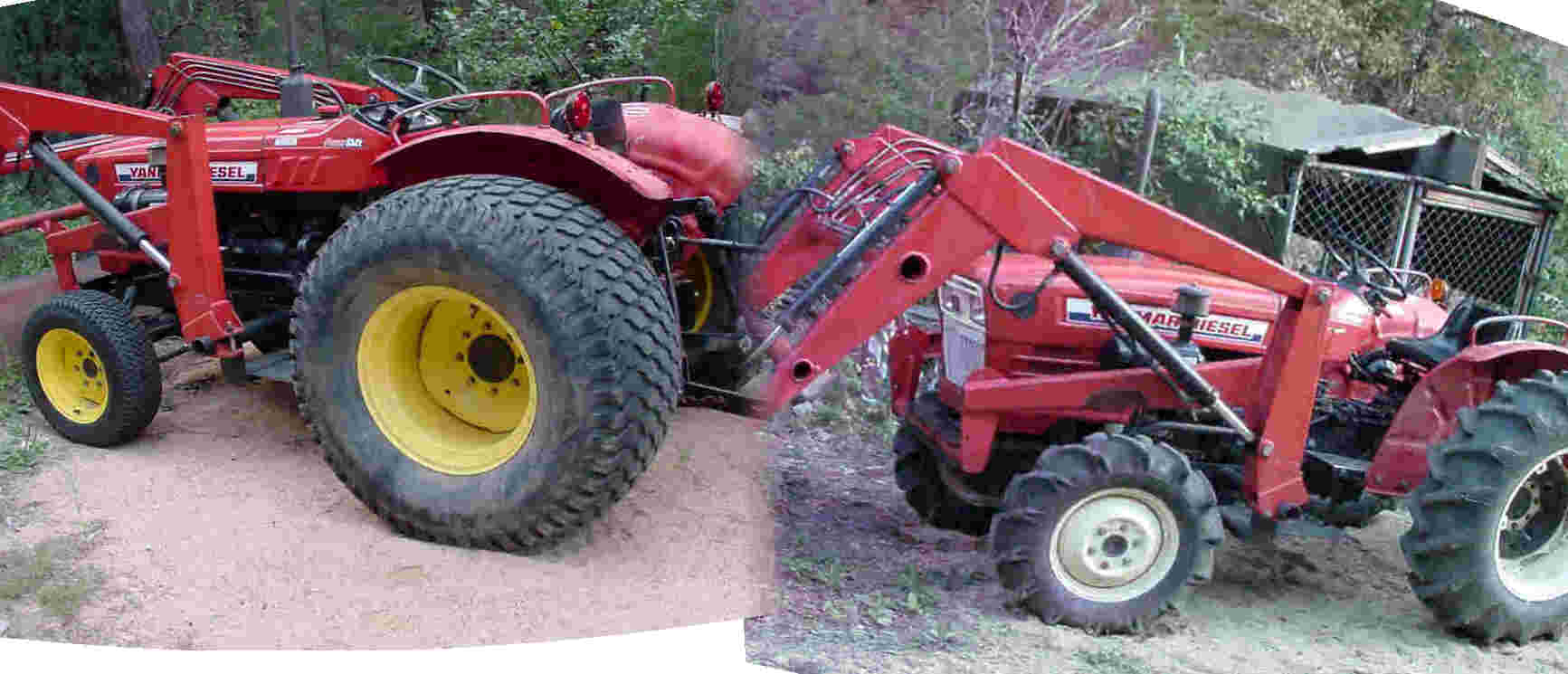

OK, it has been a year since putting the big ol' turf tires on the YM336D - and I've now had enough experience with them to make some observations. There are pictures attached here of the tractor with both tire sets. Yep, the turf wheels are JD yellow. Those ultra wide turfs were a factory option for both the Yanmar 336D and the JD 1050, and the used ones I found came from a JD 1050. Absolutely identical to the Yanmar ones except for color....right down to having the same part number on the rim. Someday I'll paint them....
BTW, those super fatty turfs were a fairly rare option on either tractor. Like I said, I found a used set and I'd tell you what I paid except that I'm embarassed to say how much. But they were not cheap.
1. Traction. The stock Ags have quite a bit more traction in soft dirt, soft snow, and a bit more in on hard snow. Neither tire is much good on hard packed snow without chains. On hard packed dirt the turfs have a little more push. All in all, about what one would expect.
2. The turfs and pushing the front end out on corners.... Those fat turfs on the front will tear up a lawn in no time at all if you try to turn sharply on wet grass or sod. If you turn less sharply they will still tear it up....it just takes longer. Take my word for it.....the super wide turfs are definitely not recommended for lawns. Of course the Ags aren't all that much better. Luckily Yanmar also offered a narrow diamond tread golf course turf tire that would fit on the standard ag rims. That would have to be the tire of choice for lawn work.
3. The turfs are much more stable on side slopes. Not only is the CG a few inches lower, but the whole tractor is wider and heavier at the corners. Now I can turn across a slope when going downhill with a modest load in the bucket.....something that I wouldn't even consider with the Ag tires because of my "chicken factor".
4. The turfs are more comfortable. Lots more comfortable. They give a softer ride and they don't make that "thump-lurch" that the front ag tires do when turning a corner.
5. Which do I prefer? Well, I don't have much of a lawn...and my dry land is very steep. Its the turfs and stability for me. I'll build a set of chains for the snow.

Roger, the pic on the right is just regular rice tires? thanks for the post and I recommend painting the entire tractor Yellow instead of going to the trouble of working on the wheels. /forums/images/graemlins/laugh.gif, bw

The tractor on the right IS the tractor on the left....Its the same tractor with two different tire/wheel sets. Say, in that photo those do look like rice tires don't they? Must be the angle or something because the tires are the std. Ag tires offered on the later YM336D. The rears shown in the right hand picture are Firestone 13.6x26 having tread type: Firestone All Traction Field and Road. The fronts are Ohtsu 8x16 Ag type, not rice......though every time I look at the picture again they look like rice tires to me too!
Or I could do like Yanmar did.....Change the model number to read JDxxxx, leave the wheels yellow, and paint the tractor green. I kind of like the yellow wheels with the red paint, but my wife took one look at it and declared that I had ruined the elegant Yanmar color scheme.
Everybody wants to be an art director.... /forums/images/graemlins/shocked.gif
