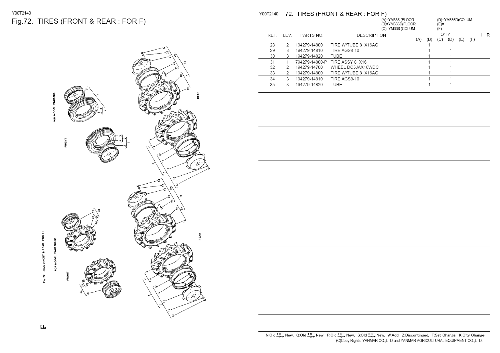

Has anyone found aftermarket replacement rims and centers that work for a YM336D with the 6 hole hub? Mine are beyond repair as the calcium chloride used for ballast has eaten through. I am going to keep the AG 12.4x28 tires, just can't find any replacement rims.

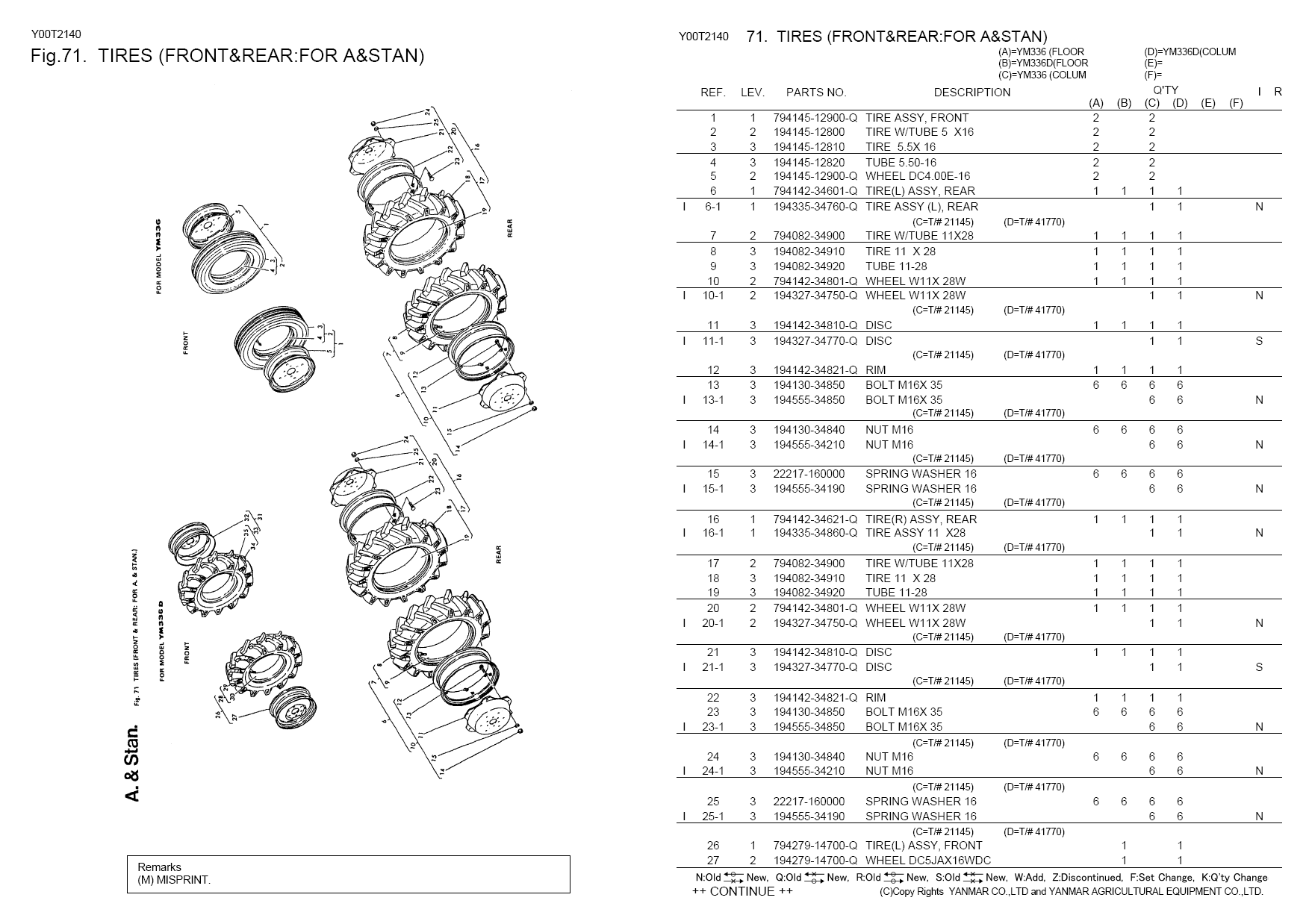

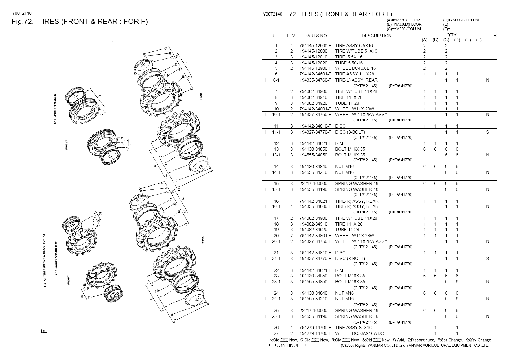

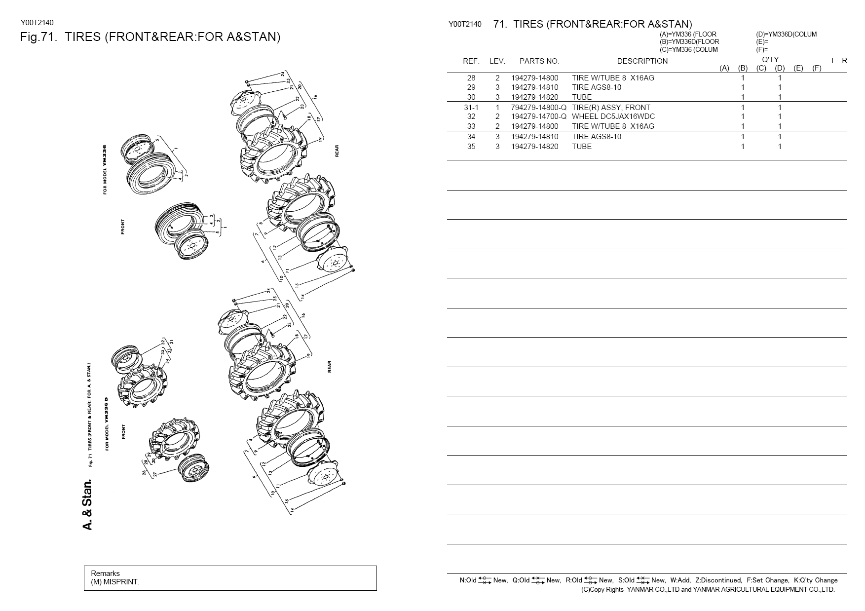

Did you download the FREE Parts Manual to know the rim p/n's to order them ?
/ YM336D Replacement Wheels/Rims/Centers #3
The Yanmar rims I found are these at PeriParts (718) 717-2524
And the OE manual offers an alternative as
Call ahead and verify what all comes with the rims with the p/n. Looking at the parts manual, this is the ring and inner hub combined.
