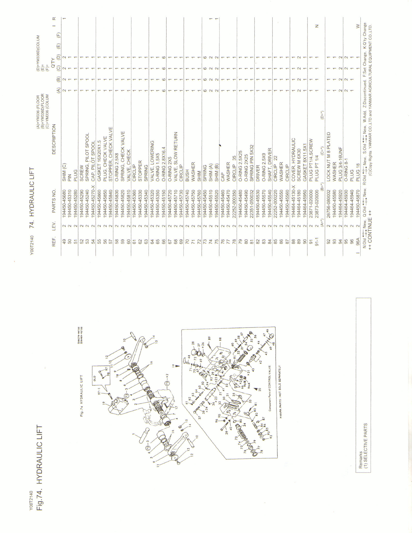

I don't think the stop valve or slow return valve has much to do with your problem. But for what it is worth the stop valve should be wide open. There is a small lever on top of the control valve that regulates drop speed. #68 here. Does your tractor have a loader and or power steering?

   / YM336D 3-Point Lift
Morning,
I do have that lever and a loader. The loader is a YFL 1500 as far as I’ve been told. It’s been repainted so there are no badges but looks identical to what I’ve seen in photos. It also has power steering which leaks a small amount at the base of the column.
Thanks!

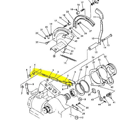

   / YM336D 3-Point Lift #8
It could also be that the feedback rod has come loose or is out of adjustment making the valve 'think' the lift is higher than it really is.

   / YM336D 3-Point Lift #9
Aaron, Nice. I've slightly adjust that feedback rod on my YM2610. It had a bit of play in it. The more the play, the longer it would take for the lift arms to respond and move. It was only a few turns. Since having the machine from Fredrick's, vibration may have backed the nuts off. I did see where they were on the threads to the feedback rod and moved them back there. To keep everything nice, I then used a nylok nut to keep it from moving again.
I can see how the OPs posting for 2/3rds lever movement could be related to the feedback rod. My machine lost about 1/4 of travel. And in a similar event, it was related to the mower lifting too. Plus, if I made the top-link in the shorter length along with it mounted in the top attachment holes to the tractor, it would raise the mower high enough not to drag. A short top-link is how these YM machines got the rice tillers lifted so high as well. The trick is how one has to set a 4x4 post lengthwise on the ground for the back of the mower to rest upon. This added tilt allows the compact tractor to 3PT hookup and makes the shorten top-link to attach. That's my trick in getting it all to work.
