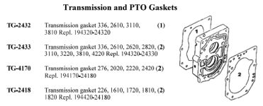

What a bummer, I got the old gal steering and driving well, but now it has a leak.
It seems the leak is more prominent when in reverse. The leak appears to be at the interface between the valve body and transmission on the drivers side, (haha) left, low. Directly under my left foot.
I see Hoye and Fredricks both offer gaskets, (TG-2432 and TG2433).
SO..... How hard is it to replace these? Is there a easy way? Can I cut gasket on top and sneak it in? Or perhaps just carefully apply gasket sealer around perimiter?
OR am I on the path to a full split? With all the trimmings...
Any advice? N8

   / YM3110d, Transmission gasket leak.
Sorry for the lack of clarity. I guess I was more tired than I thought.
After the engine block there is the bell housing then a 2 inch plate between the bell housing and transmission case.
The leak is there betwen the plate and transmission, very bottom of tractor.
Hoyes referres to the gasket there as a "gasket-valve body to trans." Fredricks referres to it as a transmission gasket.
I am already quite intimidated.......
N8
   / YM3110d, Transmission gasket leak. #5
Wow, I don't blame you for being intimadated. I would be too. If it is leaking more while in reverse I would think it must be a pressuized cavity or opening and I imagine the only way to stop it would be a gasket change. Probably more than one gasket time you get through. I notice Hoye is showing two different gaskets. I guess one goes on one side of the valve body and the other on the other. :confused2:
