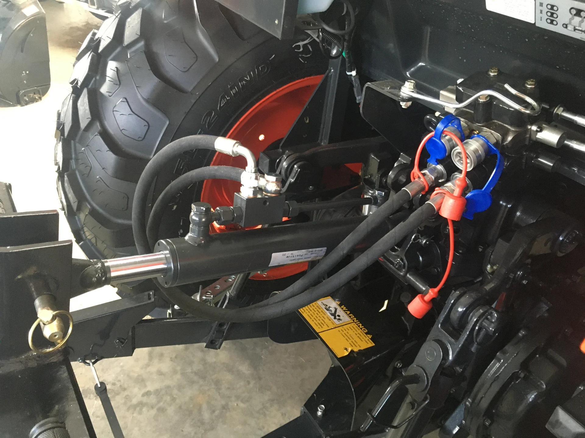

Is that one installed on your YM2610?
   / YM276D Hydraulic Top Link #4
Nope, on a friends Kubota. I can only dream of having something that nice. :)

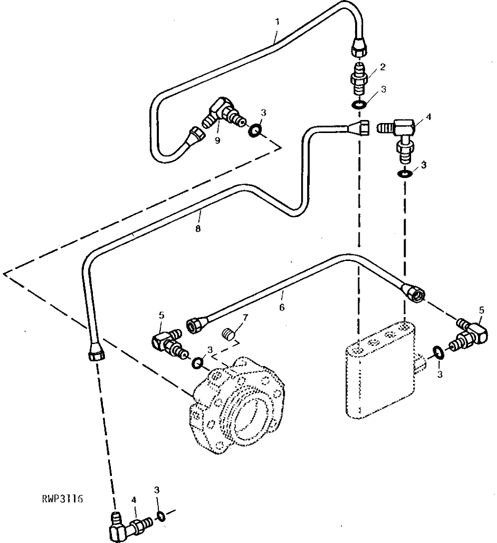

My machine should take the JD SCV setup because mine has no PS. See attached PDFs too.
And this jpg came off of the Deere site too as an option. This is all before "Power Beyond" came on the scene.
