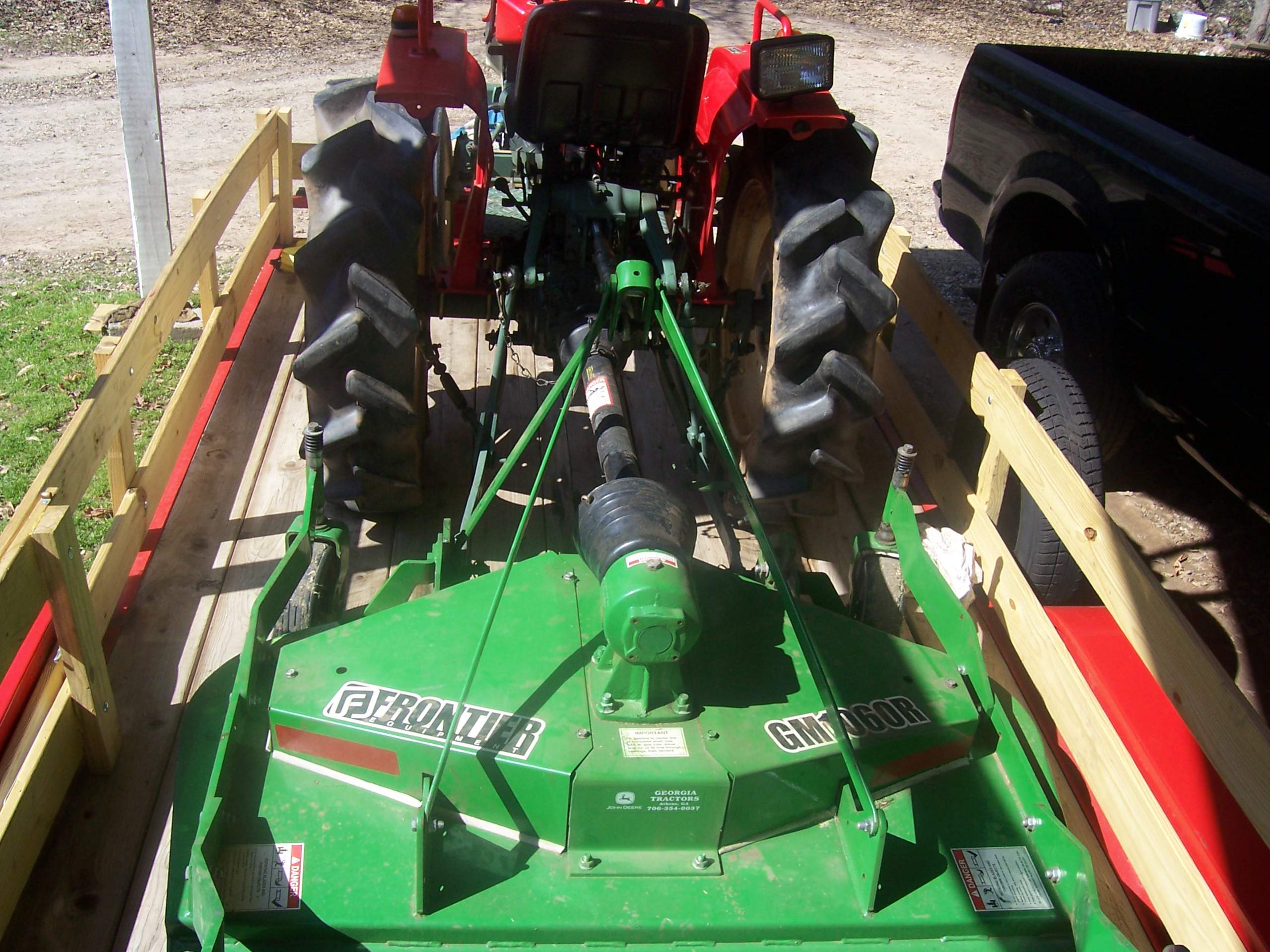

5Ft. for me. 20@ the PTO so it's quite a bit less than you have. Rear Discharge is the way to go. I'll never go with a side discharge again!! Weekly mower this time of Yr. so I've put a lot of Hrs. on it over the past 12 Yrs.. I use second gear on the PTO now that it's locking and staying in gear. 1800 Eng.Rpms all day long...;) I went down to a 4 on my BH. " The Beast" BA........

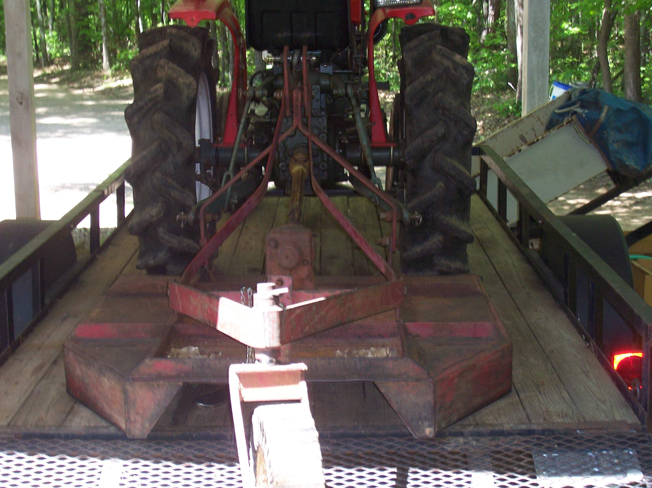

Oh my bad. I saw the above picture of Careyo63’s bus hog and then had BH on my brain. You should see the BH was used throughout that post.
Again my bad!
To change gears just a bit, making the assumption that you are looking to cut a lawn area and keep it cut on a regular basis (in my area that is generally weekly) you would be fund with a 6 ft finish mower.
It basically goes unsaid, but the quality of appearance is generally very different between a BH and a FM. If you want the lawn look you want a FM. If you want a pasture or the hayfield look then the BH.
Sorry for any confusion my confusion may have created.
