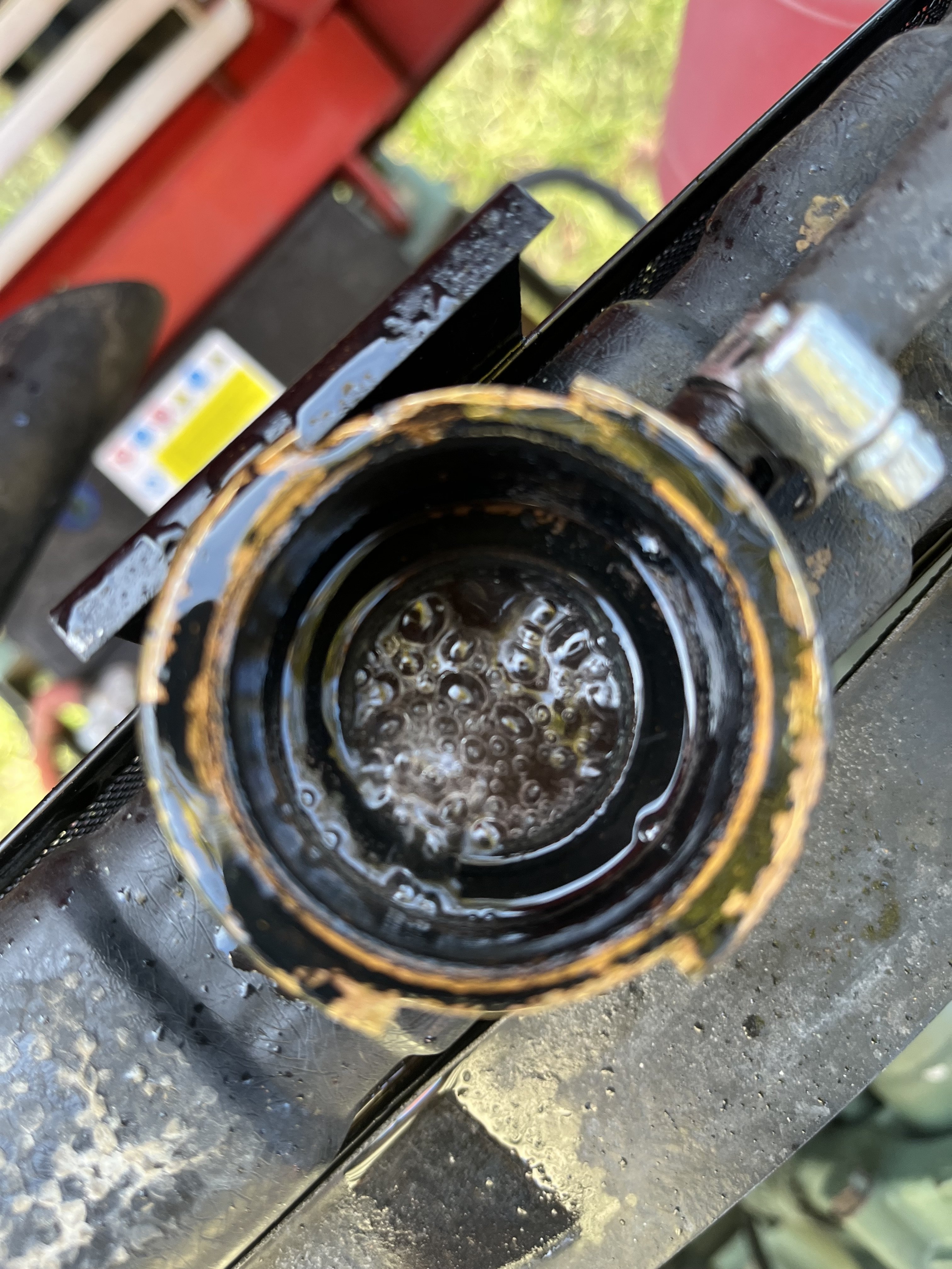

What could be wrong with my YM[emoji6][emoji[emoji6][emoji6]][emoji[emoji6][emoji6]]?
At high engine idle, I’m guessing around [emoji6][emoji[emoji6][emoji6]][emoji[emoji6][emoji6]]-[emoji[emoji6][emoji6]][emoji[emoji6][emoji6]][emoji[emoji6][emoji6]] RPMs, it’s boiling coolant out the radiator’s filler neck with the cap on. There is no load on the engine.

Head gasket! or Hopefully dirty Radiator. Have your Mechanic Pressure Check the radiator and see if it is getting pressured up!. Should be around 15 PSI.

What should the correct radiator cap PSI be? It has “0.5 PSI” stamped on the cap.

At high idle, 1200-1800 RPMs, my YM2500 is boiling coolant out the radiator’s filler neck, past the cap. It has a 0.5 PSI radiator cap.
What do you recommend?

Let’s see if this video will post…

Here is the YouTube link of the coolant in the radiator with the tractor running…
   / YM2500 Pushing Coolant Out the Radiator #10
You can get pressure tester at any local auto store. Some will loan you it. You just need the correct size cap to check the Radiator pressure. Many sizes of caps are in the test kit. It has a gauge that attaches to them so you can see how high the pressure is on the Gauge.
The big Bubble and the water level rises is a good sign of a pressure problem. Also The Rusty / Dirty anti freeze reflects that also. You can flush the Radiator and see if that helps but with the Big pressure rise is the problem. Bad gasket,Warped or crack in the head is why that usually happens.
